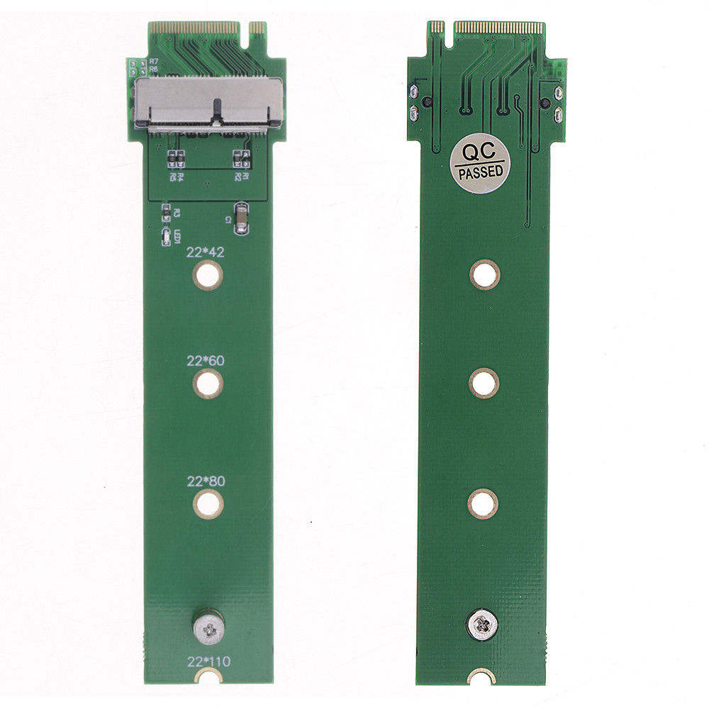

Thank you guys for help on this subject. Could someone help me here. Actually wanna upgrade my mac air early 2015 with the a 500 Go ssd. If I understand well the samsung 960 EVO or PRO are the best solutions for many technical reasons. Is it right ?
Second question : is there any difference between the SMALL M2 adapter ( the one which many guys talked about ) and the long one like above ?
Last question is about bootcamp windows on mac. I read that it is impossible to run windows via bootcamp if we replace the "official" ssd of apple by NVMe ssd. Do you confirm ?
Thanks !
Thanks !

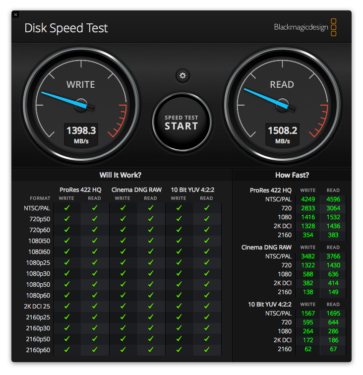

I have no experience and thus no answer to #3, but I just completed an upgrade to my Early 2015 a week ago or so. I chose the Adata SX8200 480GB over the Samsung's for a few reasons. Wwwwaaaaayyyyyy less power consumption. Quite a bit cheaper. And runs much cooler. Installation was a 5 minute task after doing the updates etc. I had the most current version of Mojave on my machine, made a USB boot drive of Mojave and did both a time machine backup as well as a Carbon Copy Cloner backup as well.
I used the Short Sintech adapter (actual Sintech branded) as it provides a thinner profile inside the MBA. It went in perfectly. I did note that if the screw holding the drive in is overtightened that the whole drive board would bow a bit and so just snugged it up with no problems. After installation the mac booted on the Mojave installer disk and recognized the Adata instantly. Formatted and installed Mojave and then did a migration of my data with no issues.
Speeds are a tonne faster. Has a snappy and quick feel to it. Large apps load wwwayyy faster and things are again more instant than ever recall!! Battery life seems the same. No battery percentage loss in sleep mode, Actually I'm finding even less heat than with the original samsung drive. iStat Menu is showing 25-28 deg C where as before it was always over 40... I'm very happy with the upgrade.
No experience with Bootcamp.....
Edit: I should add thatI did before and after Black magic isa speed check. Read speeds went from 1100's to 1500's and write speeds from 700's to high 1300's. I should mention that I did get one faster write on the old Apple samsung drive in the 1300's but it was a rare anomolly as most of the writes were between 550-750.
