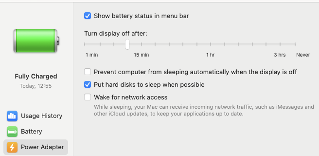

hmm, does this setting (Wake for network access) under Power Adapter effect the MBA when on battery? I took it as only effective when plugged in.

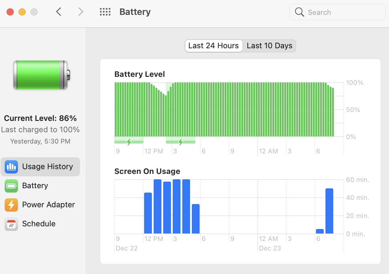

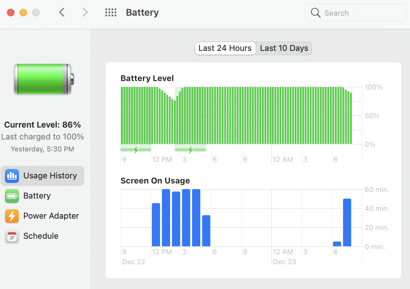

On my M1 MBA I have icloud enabled, with no extra configurations, wake for network enabled. The only thing I've done is clean out the Google/Chrome cruft from my system. I have no issues with battery loss during sleep.
Reactions: Zazoh and Galius
How much are you losing overnight?
Last night, with the battery fully charged before sleep, zero (as shown in my screenshot). But normally seems like 2-3 % maybe. Could just be that there is a bit of a buffer "above" 100% that was used last night.
2-3% overnight seems normal discharge. Mine is the same & few ppl here seem to have same levels of discharge.

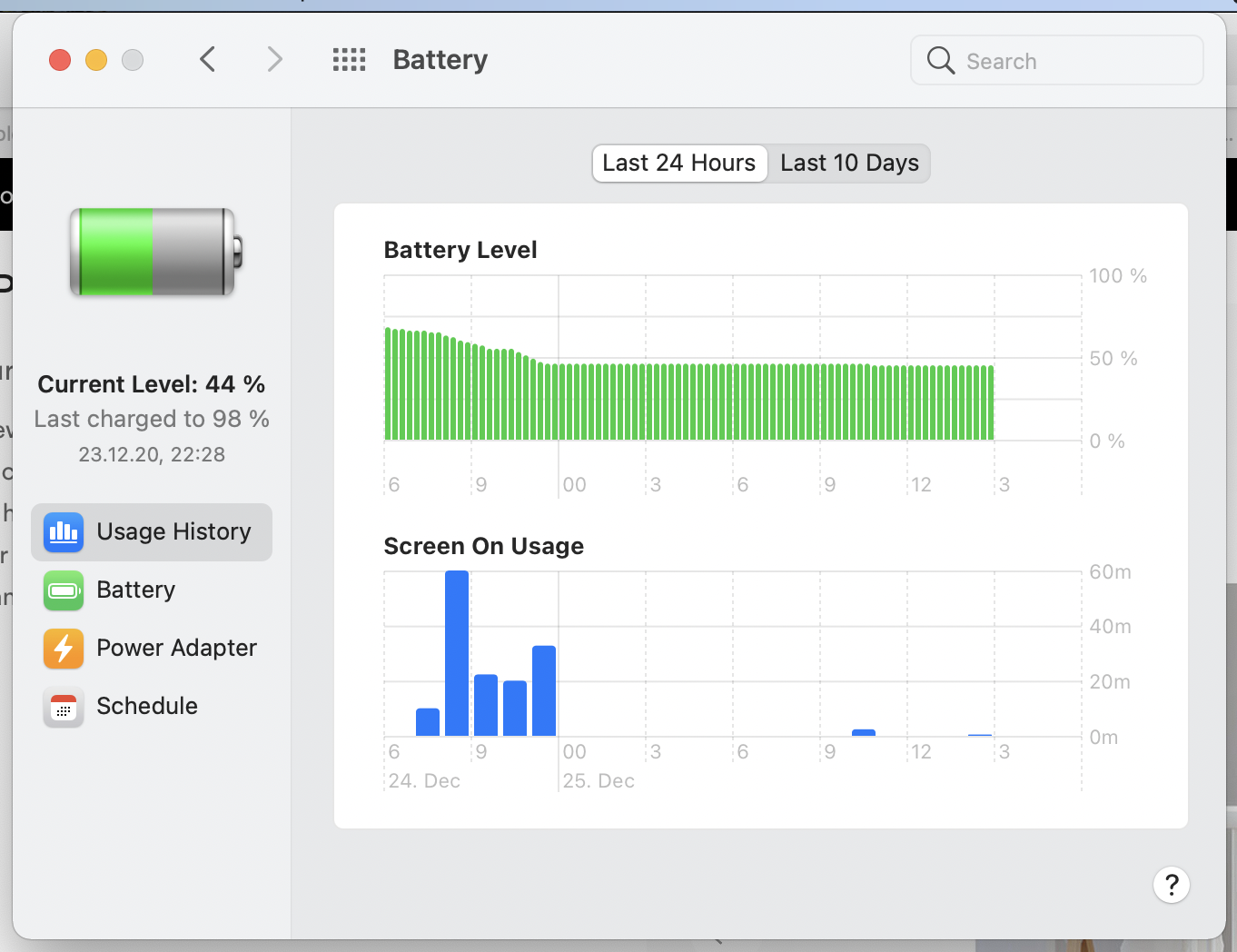

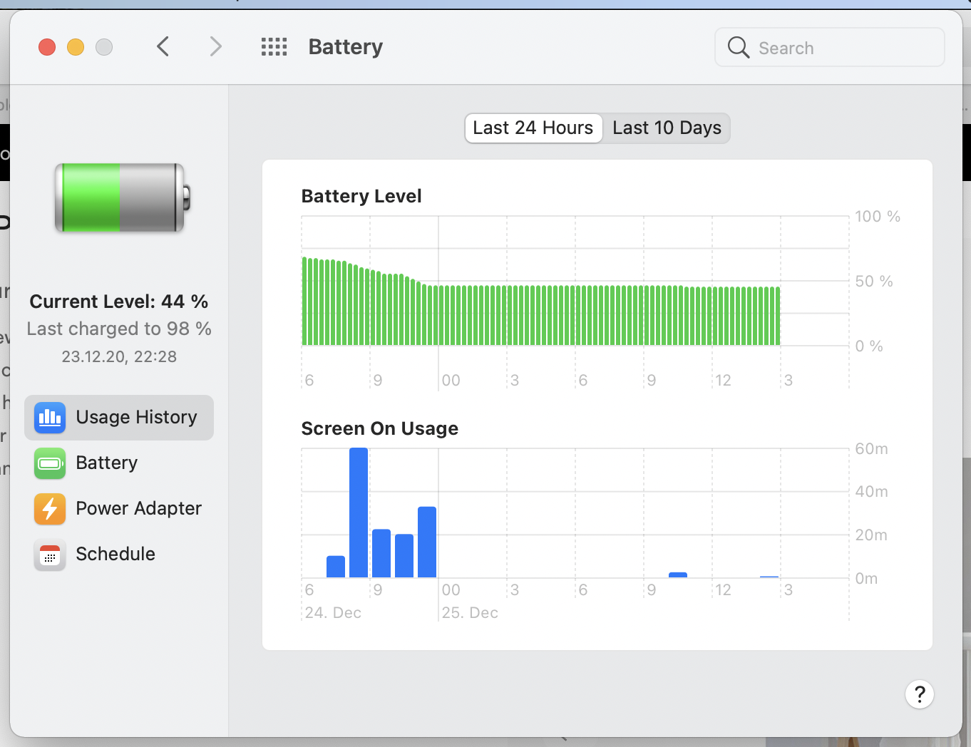

So my previous screenshot showing drain overnight had a Yubikey plugged into one port, removed that and back to expected overnight.
Interesting. So perhaps it's a bug that has something to do with peripherals? I wonder if this will mean excessive battery drain when using usb mice etc?
that screenshot was taken from my mba m1
Ok - crazy. So why don't I have this feature? Maybe missing translation, as I'm using it in german language?
EDIT: Tried it with English - the same. Menu point not there... MBA M1 16GB 1TB

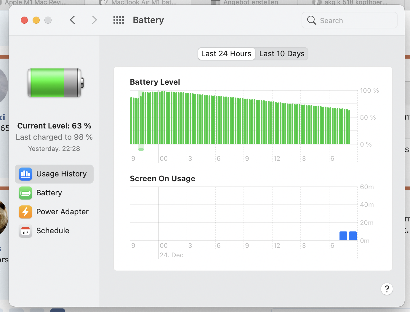

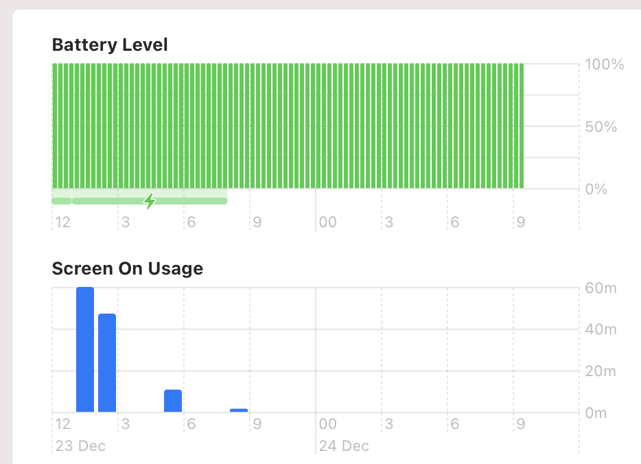

I had exactly the same problem with my MacBook Pro M1.
This was the 35% overnight battery drain two days ago:
Then I disabled "Wake for network access" and updated to Big Sur 11.1.
This was the battery drain last night:
Really happy that it solved the issue since I thought I was going crazy with everyone raving about the amazing battery life. Still a strange issue and the more so as not everyone seems to experience it. Hope this helps someone.

Where is this option "Wake for network access"? I can't find it under the battery tab?
