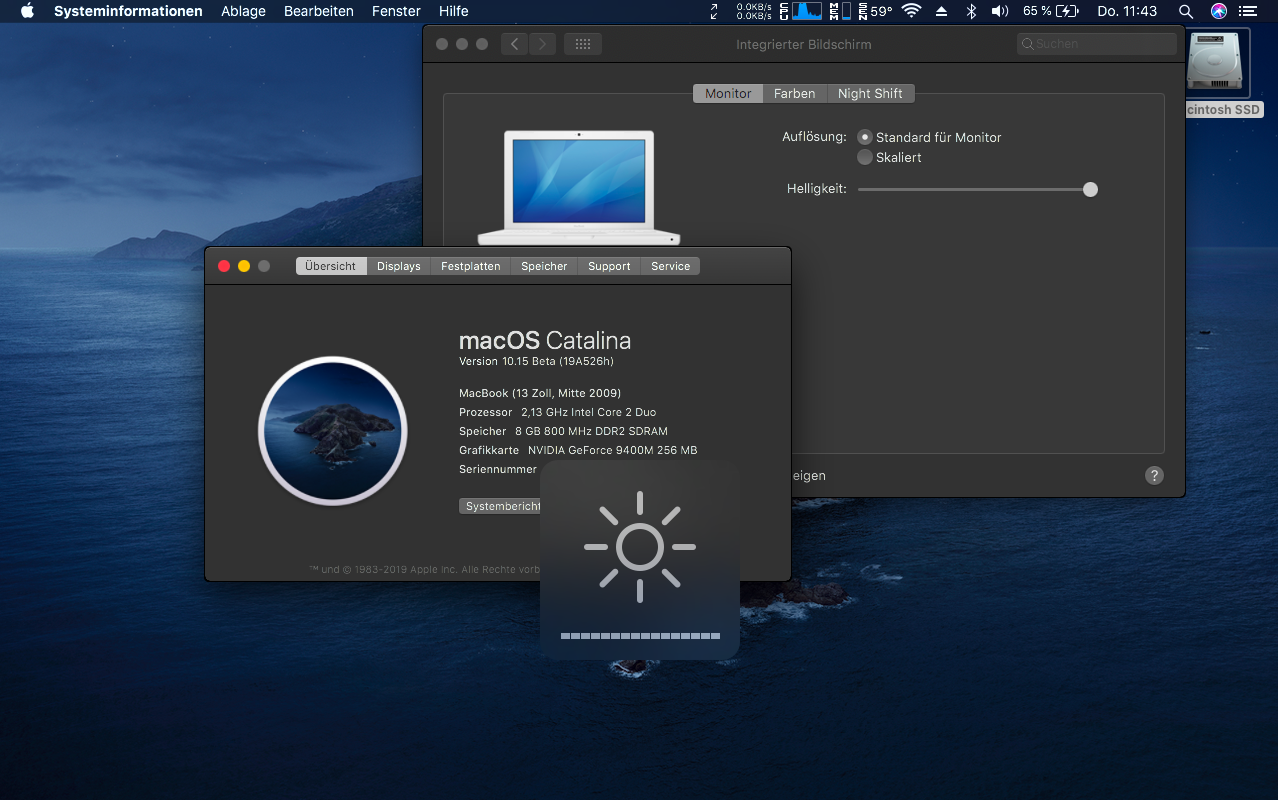

Good news for the old CCFL backlit machines (i.e. MB5,2 / MBP4,1) - 10.15.0 beta 5
I successfully applied @dosdude1´s old Mojave CCFL patch (latest version from 10.14.2 times if I recall correctly).
After struggling a bit with the read-only volume of the boot drive, I did the patches manually from a second mac connected to the MB5,2 in target (firewire) mode. Should work also when drive is taken out of the MB and connected as external shuttle drive to a helper mac.
Then copied kexts and framework to the right places and corrected attributes and ownership of the files according to the install.sh script, also manually. Reboot at first resulted in non-working USB/keybd/trackpad. Then rebooted into single user mode, (did nothing there), exited to login - keys and trackpad working again, but still no luck with the backlight. Function keys worked, but not the backlight-related two. No symbol even showed up as overlay.
Then re-patched the backlight function with the Catalina version of the patch updater (only that one, select with ctrl key).
Reboot, and -voila!- backlight control working again fully!

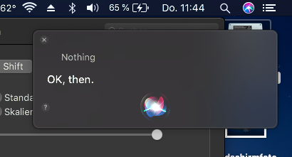

Also good news for SIRI on unsupported systems (also with graphics accel.):
Seems to work again in the latest beta, just without animated soundwave. Not crashing any more.

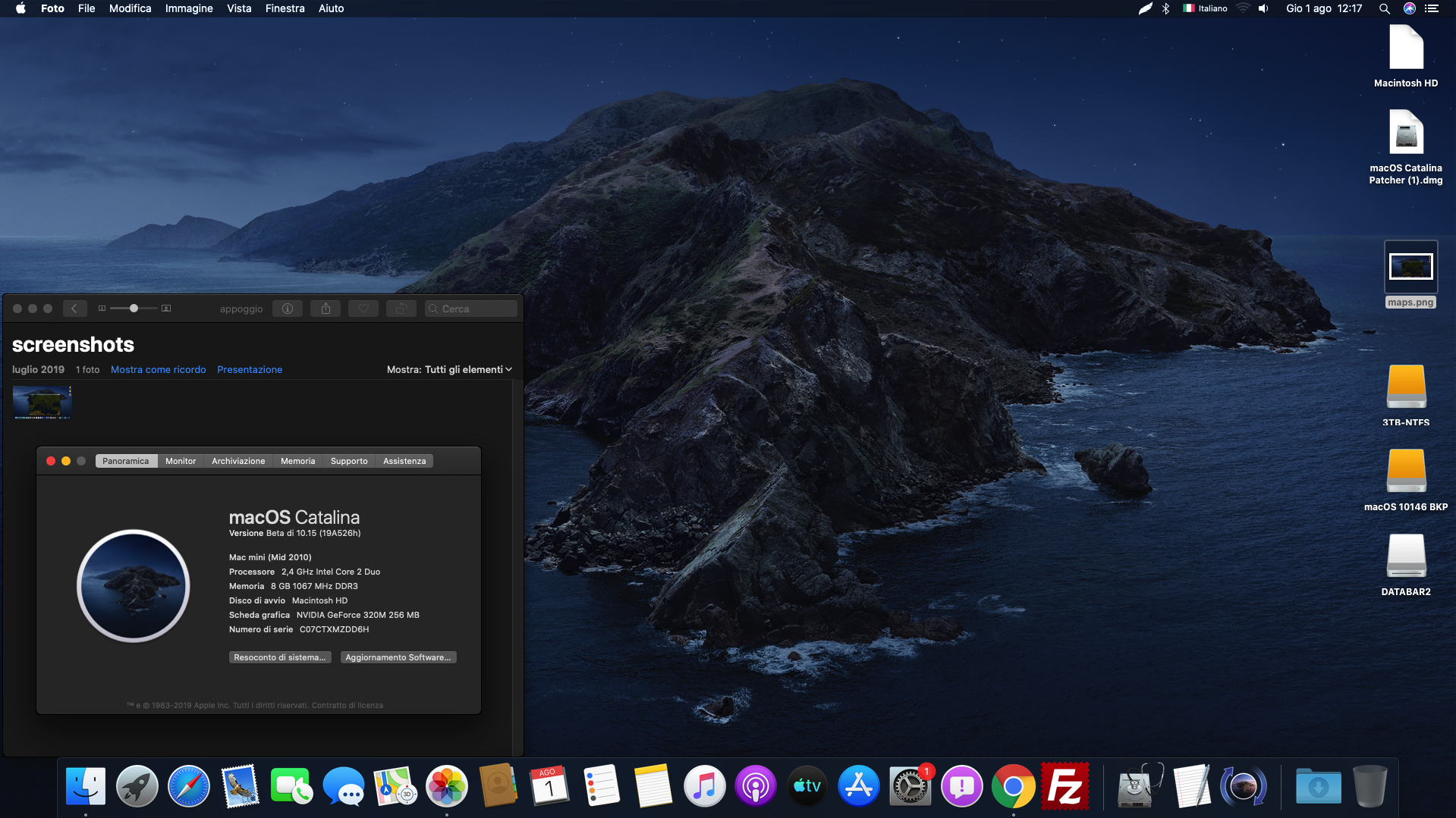

Installed macOS 10.15 beta 5 with @dosdude1 patcher 1.0.3 on Macmini mid 2010 (Macmini4.1)
Now:
- Photo app works fine!!
- Wired Pc usb keyboard works fine (was losing connection everytime with beta 4) excepting Caps Lock key and his led.
- Maps still crashing
- External usb webcam mic audio still missing, video ok (working with Mojave)
- CPU very hot! 70° Celsius with 5500 rpm fan

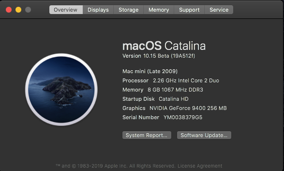

Yesterday I downloaded the latest patcher and a beta from the patcher. I am not sure which Beta I have as when I search for upgrade it says latest. Here is a screenshot.

After installing the latest image that the patcher tool finds you should get build 19A526h - that´s (dev.) beta 5 then. Check the installer version - see page #1 in this thread.
Well I am downloading the latest image from the patcher tool but still beta 4. I just booted from the patcher and asked it to install a copy of Catalina to my disk. Then I will patch and see if that method will work.
The installer app version of DP5 is 15.0.21. Just ensure that's the version of the installer app you have before installing.

OK it downloaded the correct version. I then created a boot SD card. Now I booted from the SD and said install new coipy of Catalina Beta. I did that and patched from the SD but still same version. I then tried to install it directly from the patcher to the Main Catalina HD it patched the files then rebooted to the same old version. What am i doing wrong?
Reactions: TimothyR734
That´s strange. What build does macOS "About this Mac" show?
