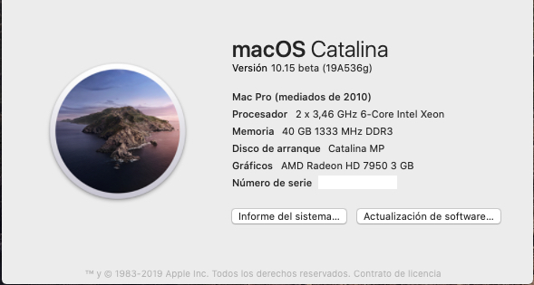

Hello Collin, thank you for the excellent work done
The first 2 installations were updated from DP5 but the following 2 installations were clean installations.
It's late here in France I'm going to bed, I'll try to reinstall DP6 tomorrow and I'll restart with CMD + V to see the errors
Keep trying, cause it works flawlessly.

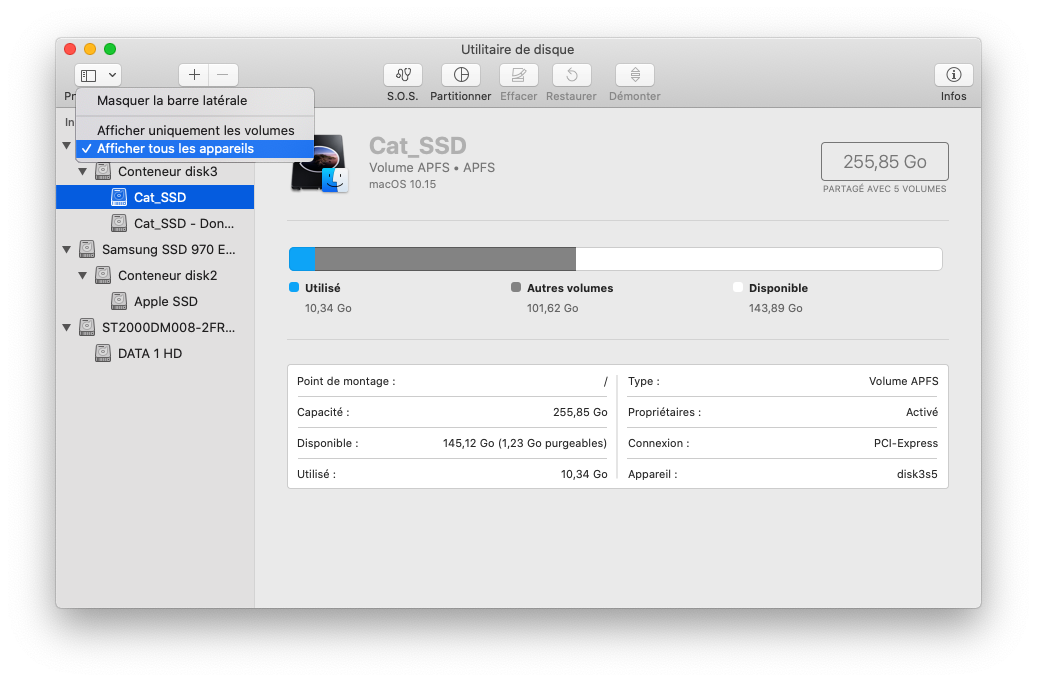

Are you completely nuking the pre-existing APFS partition scheme and starting with a clean gpt? If you aren't doing that and are only erasing the AFPS system volume, it might be picking up the previous stale kernel caches from the previous Catalina installation (which inhibits the automatic kernel cache rebuild). I've never been clear on which APFS partition volume those kernel caches get stored on (Preboot?).
There´s no need for that. If you select the hard drive in the Disk Utility, not the partitions, and you click "erase", that´s what it does, delete all previous partitions, even the hidden ones.

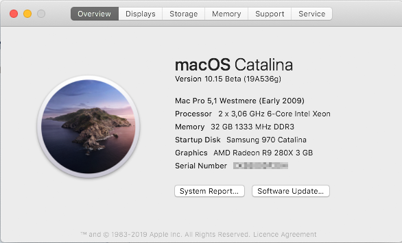

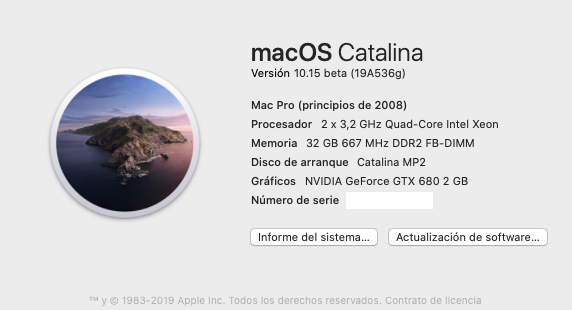

Installed DP6 in my Mac Pro 3.1 All seems to work fine. No problems with reboots (5 by now)

What I/F are you using to connect screen to which GPU in MP3,1?
I find that using GTX680 Display Port to Display Port on 24" Dell loses all video.
GTX680 DVI-D to Dell is OK.
In Cat beta5 GTX680 Display Port to Display Port on 24" Dell is OK.

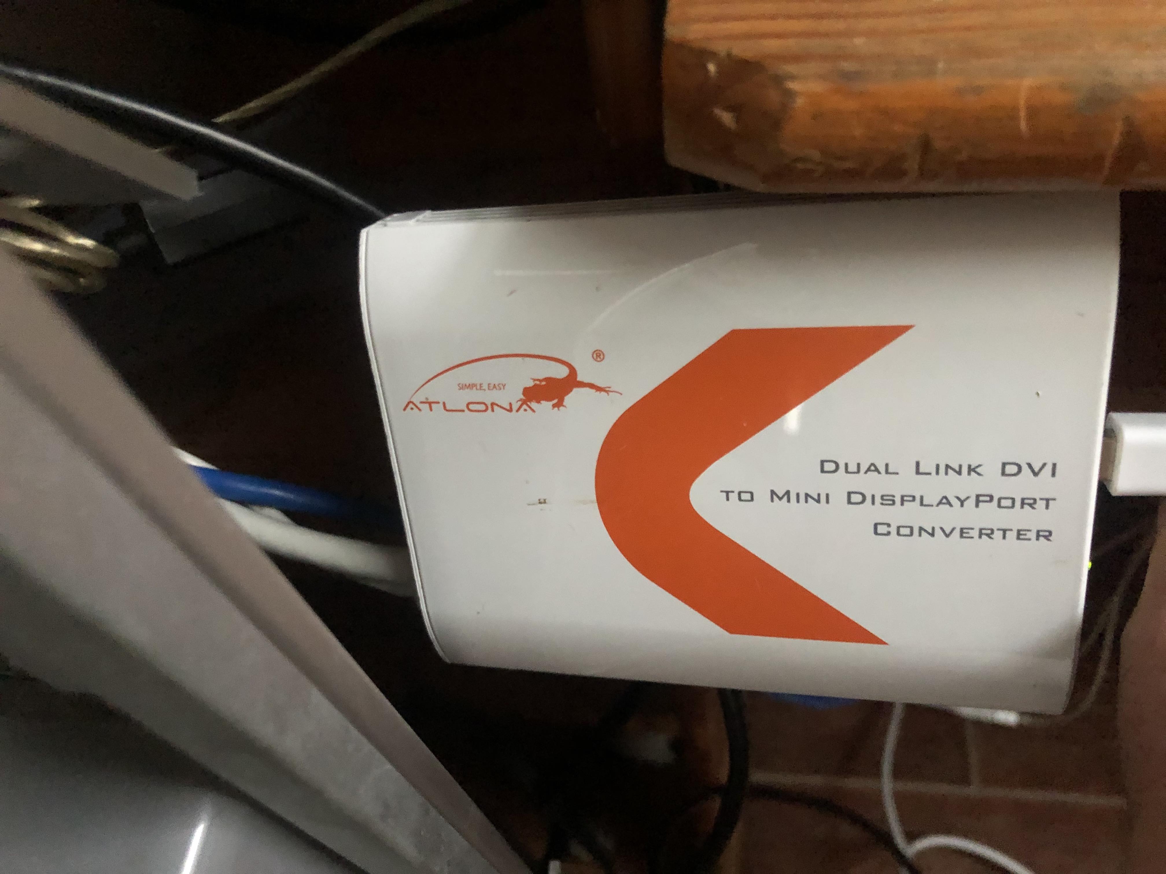

Yes, I´m using this adpater. I don´t remember very well why, but I believe that the displayport to mini display port adapter connected to my Apple Led Cinema display 27 didn´t work right at boot screen.
[doublepost=1566368980][/doublepost]
Nop, now I remember. I was using two Apple displays. When I removed one of them, I left the one connected to this adapter, cause the other one booted at very poor refresh ratio and resolution.

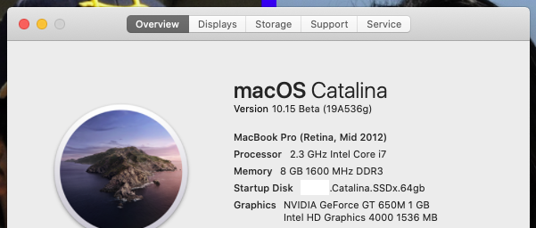

TL;DR – can confirm DP6 works now using patcher v1.0.8.
cMP 4,1/5,1 here. Got the stop/forbidden circle too with an in-place update of DP6 over DP5 on monday. Tried again yesterday with v1.0.7 and a clean install, no dice. Today I was able to repair the last installation by recreating the usb stick with v1.0.8, booting from it, just applying the post install patches again and then excecuting the force cache rebuild. This took about 15-20sec now (only 2-3sec with v1.0.7).
Everything works, thumbs up @dosdude1 for the quick fix.
Except that Disk Utility now hides the devices for those that are partitioned in the display by default now.
