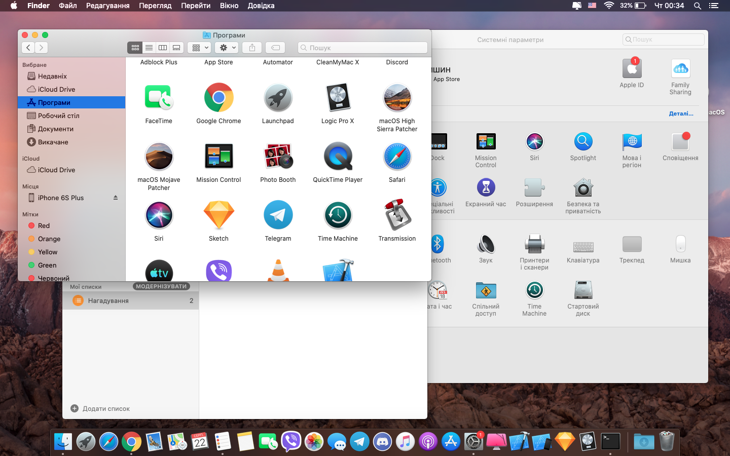

Giant circle also here, tried only after you've seen this. Some picture flashes briefly below the systems settings window before the giant circle shows.

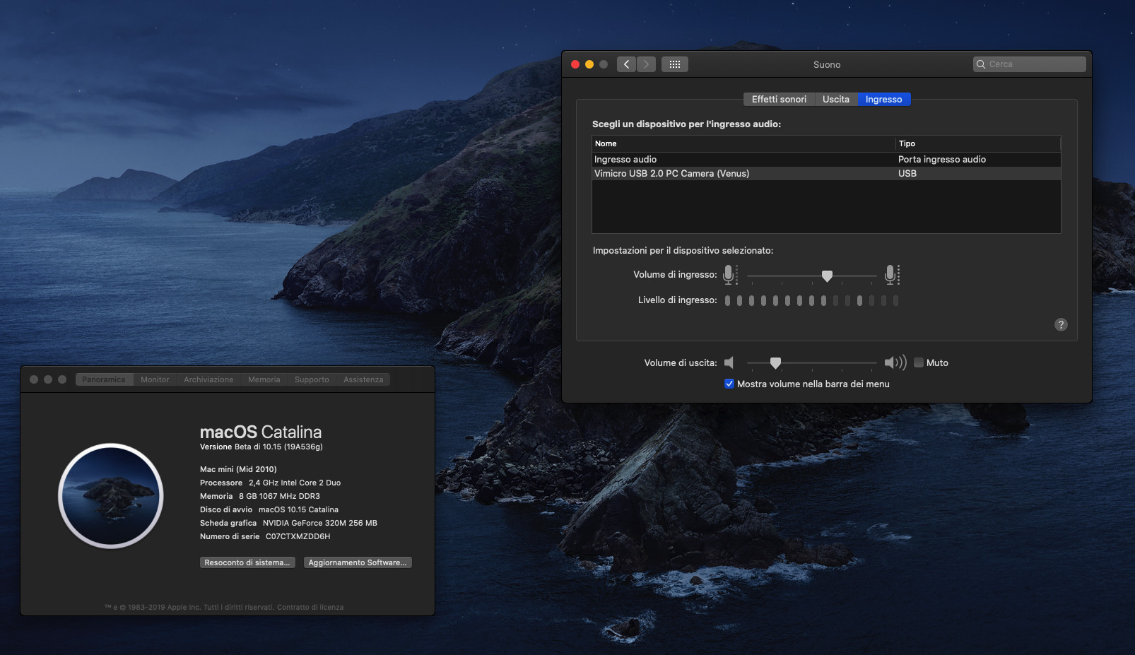

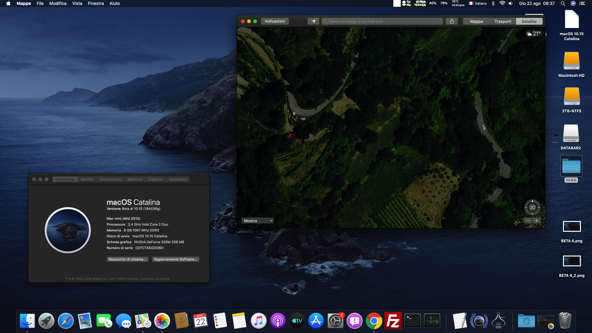

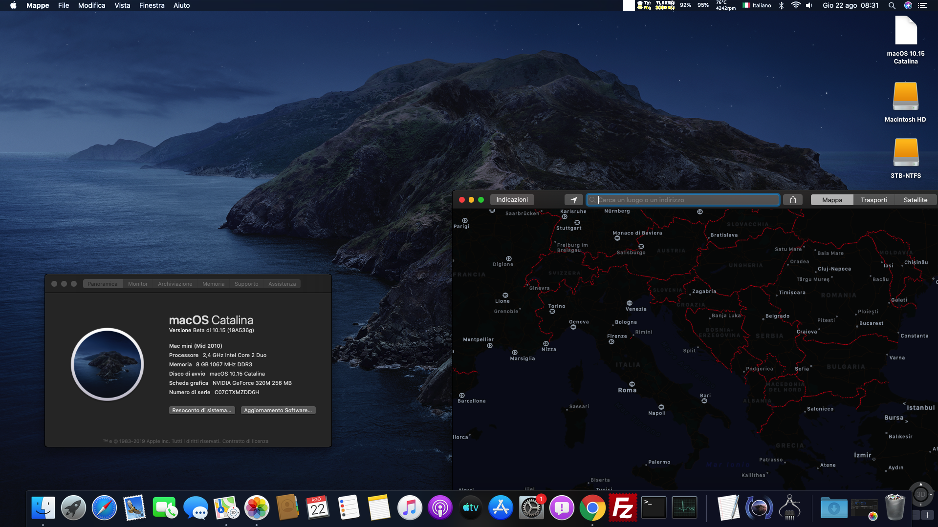

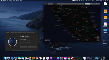

@dosdude1 @ASentientBot Good news for Beta 6 + Cat patch 1.0.8 on macmini 4,1 !
- Maps now almost works (watch images) much less crashes and seems that stability improves while using it. Ask me tests & feedbacks if they can help to definitely solve the issue. :)
- Audio MIC of USB webcam now works! (and so also SIRI)
- Photo works

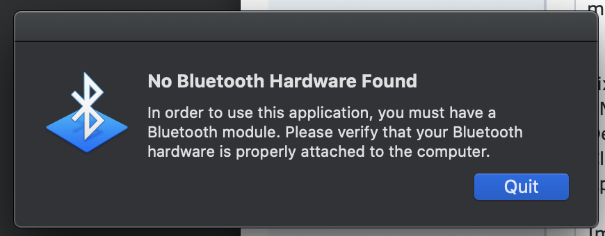

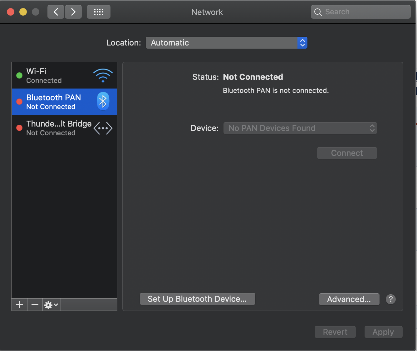

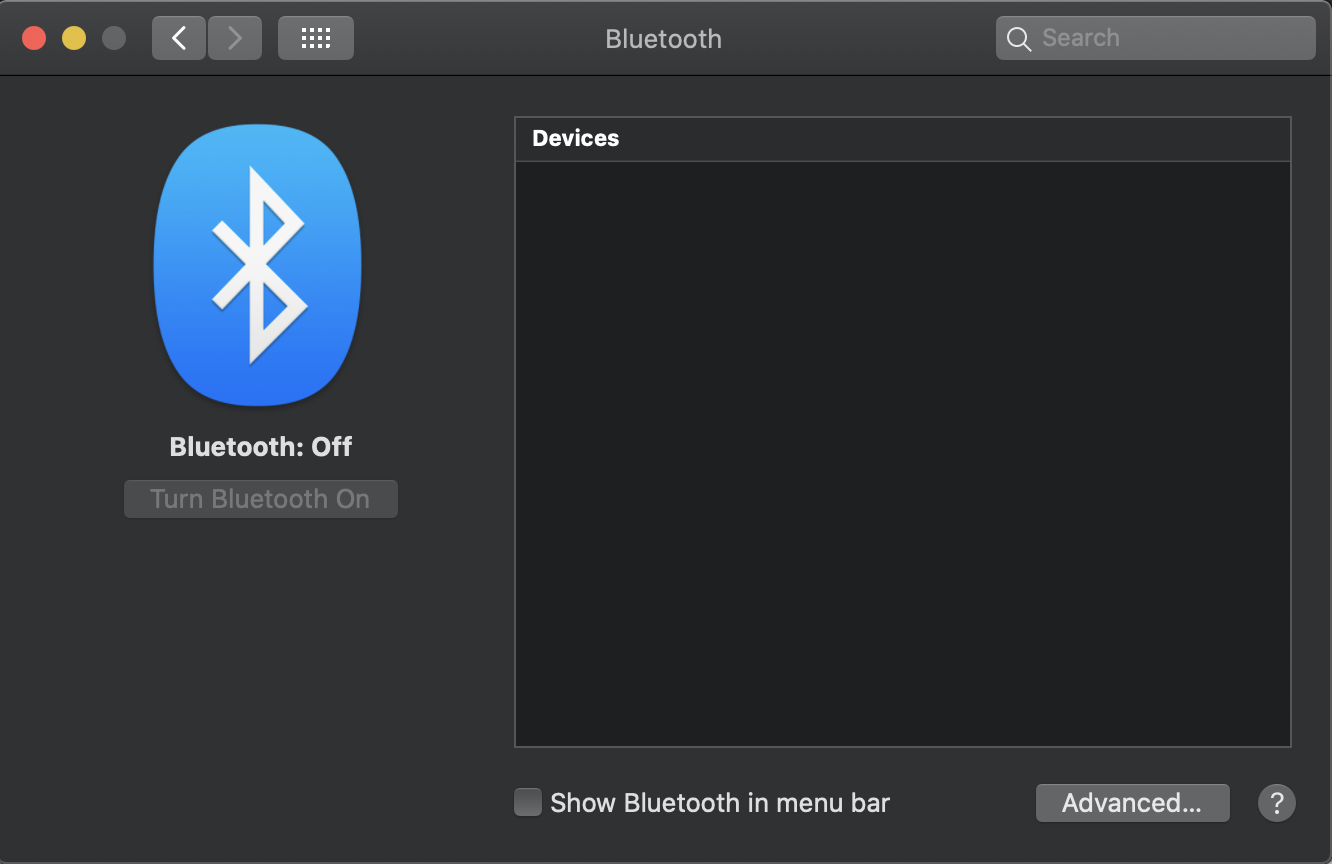

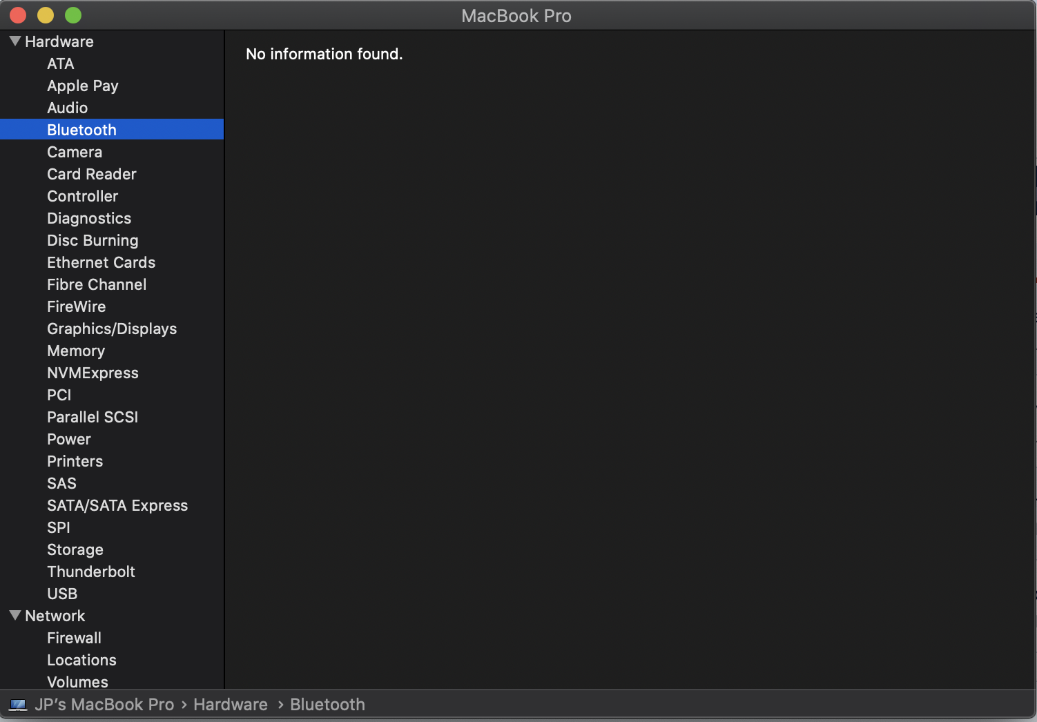

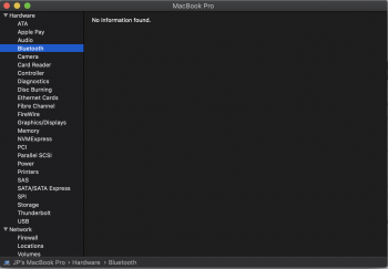

Hi, guys
anyone noticing problems with Bluetooth on macOS upgrading from Mojave to Catalina?
My issues are:
No BT information found on System Reports
"BT Not Available" on menubar icon
BT Pan "Not Connected" (Removing BT Pan and adding it again, it won't connect)
Can't turn BT on
Opening BT File Exchange got a message "No Bluetooth Hardware Found, In order to use this application you must to have a Bluetooth module"
Fixes that I've tried:
SMC, PRAM and NVRAM reset
Deleted Com.Apple Bluetooth.plist
Clean Install Mojave and Catalina as well
Apple Hardware Test " No issues found"
Im on a supported MacBook Pro (13- inch, Nov 2018)
2.3 GHz Intel Core i5
macOS Catalina 10.15 Beta DP6 (19A536g)
Any help would be greatly appreciated!
