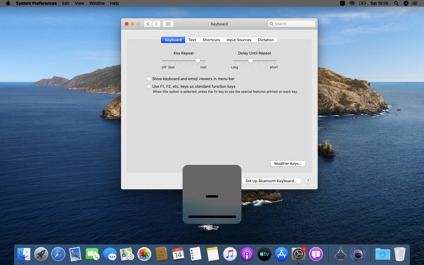

Has anybody been able to use the keyboard backlight on a MacBook Pro 4,1 running the latest Catalina Beta 8? I’ve tried a couple of different things but haven’t been able to get backlight to work every time I try to turn it on it gives me a weird symbol shown in the picture below. Thanks!

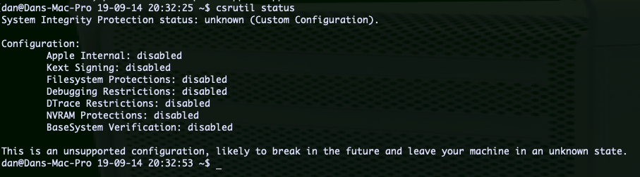

So, everything is running perfectly for me. The thing I am wondering about is System Integrity Protection (SIP). The reason i was searching and then reading the thread was to see if the info I need has been posted already, but i have not found it.
When I boot into Catalina, SIP is not enabled. Is that normal?

Because system files are patched, and extra, unsigned kexts are being installed, SIP must remain disabled at all times when running a patched copy of macOS. Having SIP enabled will cause the system to simply stop booting, or have functionality issues. Catalina Patcher includes an implementation that ensures SIP is always disabled, regardless of what the user sets in NVRAM.
This is great news! I was worried I got off the rails, that SIP was off due to errors in how I installed things. Now that I know SIP disabled is part of the plan for running Catalina on my box, i am all good. I will just have to be careful about how I run chmod and chown and not lose my emergency boot disk drive to restart in the event of an unfortunate incident.
I am going to guess.. rules of the road without SIP:
1. Don't try manipulating files on the "system" volume of Catalina. Leave those surgeries to the people who know what they are doing by running the patch software and then leaving it alone.
2. The "Data" volume is... open season, free for all? No?
Reactions: MacClueless
With your cMP 5.1 you have a few routes you can follow. Using the patcher, as you have found, will keep SIP disabled. I have been running a cMP3.1 without SIP since Sierra and provided you are careful this has not caused any problems. Other advantages of the patched route are that you get NightShift and if you have the original WiFi card then the patches give you WiFi. I also believe dosdude1 has removed the need to have the "no compat check" but I have not tried this way with my cMP5.1.
The other route that leaves SIP enabled is to install with no patches at all. Dosdude1's patcher has the option to do this which is great if you want a system with as little change as possible. However, you will have to have the NVRAM "no compat check" applied. My cMP5.1 is running like this at the moment. I do have an upgraded WiFi/BT card so it is running Catalina "OOB" if you like. To take this route set up the patcher options from the menu before you install - set APFS not to use the software patch and the automatic patching off. After install the cMP5.1 will boot up into Catalina with no further actions needed. SIP remains enabled throughout this procedure. So the choice of poison is yours! At present it seems the cMP5.1 runs Catalina very well.
Last point - make sure your ROM is the latest - 144.0.0.0.0.

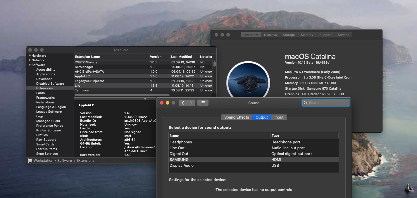

HDMI sound which was working in DP 7
With lilu And appleALC as a plugin
No longer works in DP 8
HDMI Audio works fine here in 19A558d, see attached pic.
Make sure you have installed at least Lilu v1.3.8 or later, and AppleALC v1.4.0 or later.
Thank you for the assist, I appreciate it a lot.
I have the ROM all set.
So the patcher has the option to apply no patches.... what service is it providing in that scenario? I am thinking the main thing it does in that scenario is provide access to catalina download from Apple.
I pretty much have Catalina setup now with what I use it for, such as VMWare Fusion running a four VMs of Debian Linux. They are used for web development, doing the coding on them and pushing the code to live Debian servers owned by my clients.
Plus a few other softwares...
So, to get to the SIP-enabled setup, do I have to start with a new installation of Cataline, either wiping the volume I am running now or maknig a new one?
Last queston, I don't know what it means or how to do the NVRAM "no compat check", needed for Wifi and BLuetooth? I am running original equipment for wifi and bluetooth. I can live ok without wifi, because I run ethernet into the heavy box. I do not move it from place to place, buttttttttttttt... I can imagine that could get ugly too. I'd say it is lame that I am runnng old wifi/bluetooth and should upgrade them, but i am going to need to get a better handle on how that fits into the patch/no-patch and NVRAM no compat check.
In the grand scheme, small small issues compared to what some have had to deal with.
Regarding night shift, well, not night shift but dynamic wall paper in mojave (still in Catalina if you pick the mojave wallpaper, vs.the "automatic" light to dark in Catalina, this is such a small issue, but Apple kicked the pooch on this as far as i am concerned. I love the dynamic changes in the wall paper but i want a dark theme 24 hours a day not just at night. Catalina does not support that with the catalina wallpaper. To get Catalina wallpaper to do the light shifting the way Mojave does, you have to have light theme during the day. I hate that.
Now the other last question... looking for an inkling of what this is about, the icons associated with usernames.

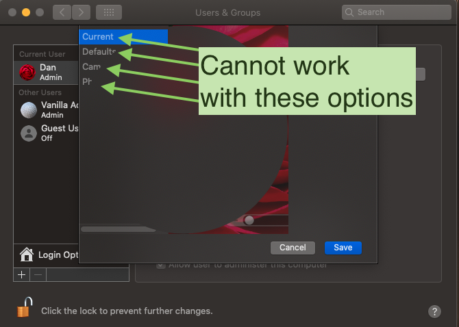

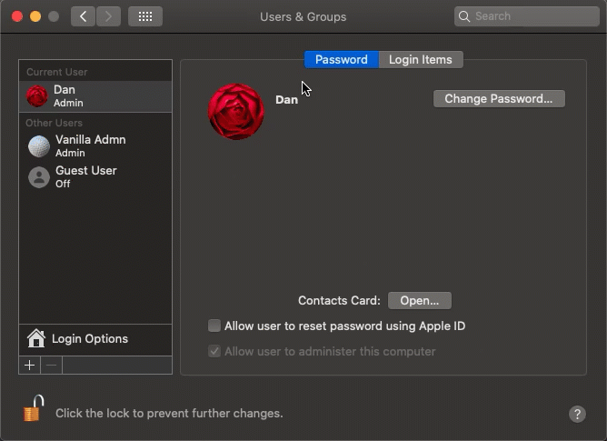

First off, there is NEVER a need for SIP, as it is practically useless in most cases. It didn't even exist in OS X 10.10 and earlier. It's easier to just have it permanently disabled and not have to worry about it getting in the way (about all SIP is good for) when you want to change something in the system.
no_compat_check is just a kernel flag that bypasses the compatible board-ID check of the bootloader, allowing it to boot on machines that aren't officially supported. This value is also set by the patcher in the Catalina Install's com.apple.Boot.plist file, so it doesn't necessarily need to be in NVRAM. I just have the Patcher put it there as a precaution in case it ignores boot.plist, which I have seen happen in some cases.
Lastly, the weird user picture issue you're seeing is a glitch with the Catalina Beta itself, and not an issue with the tool or patches.
