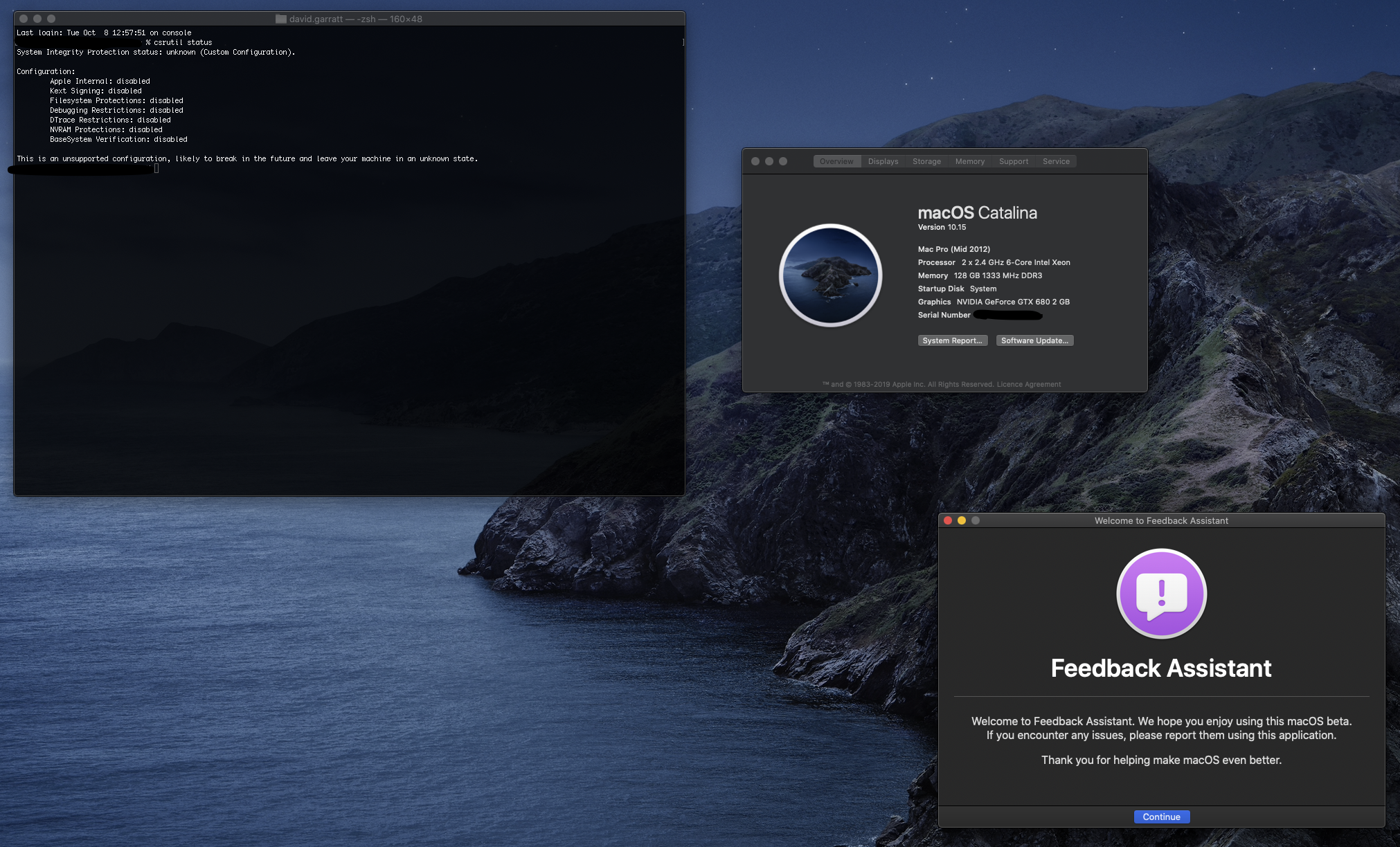

Successfully updated to the full release using dosdude 1.1.6 patcher.
However I notice the following:
1. Feedback assistance is still there and mentions beta??
2. SIP protection is in 'unknown' status and I cannot seem to change when I enable it via the Recovery partition.
Reactions: TimothyR734

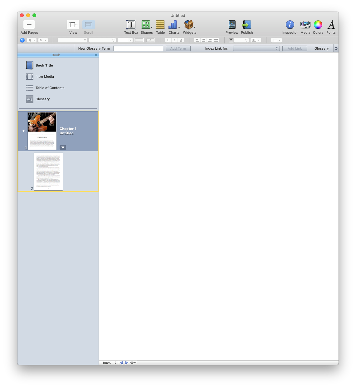

@FilthyMuppetInnuendo I have a MacBookPro5,3 (2009), and iBook Author works fine on my computer running Catalina, so I don't see why it wouldn't work on the Mac 2009 as well.
Yep, still doesn’t work. Thanks for checking, but it was to no avail. I’ll have to do a clean reinstallation of High Sierra… goddamn, that’s going to be hard now that I can’t download it anymore… and manually restore all of my files to their proper locations. Again. Just like with Mojave. Apple doesn’t seem to give a **** about nVidia’s third party drivers, no one seems to have cracked them to shove into Catalina, and I can’t afford a new Mac.
Thanks anyway.
If you installed any of the post install patches SIP needs to be kept disabled
