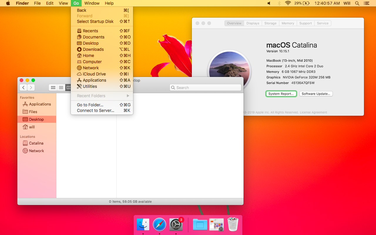

Today I stumbled across a complete non-Metal transparency patch, menu bar included, that doesn't involve any material swapping -- just a couple bytes in SkyLightOriginal.
Code:
0x216c60: NOP
While it doesn't directly use your patches, thank you to @pkouame and especially @testheit for pointing me in the right direction with your discoveries involving materials in SkyLight. It was by looking at related code that I came across this.
The file is attached for testing :) Please report any issues.

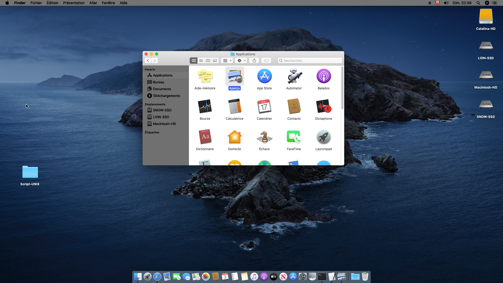

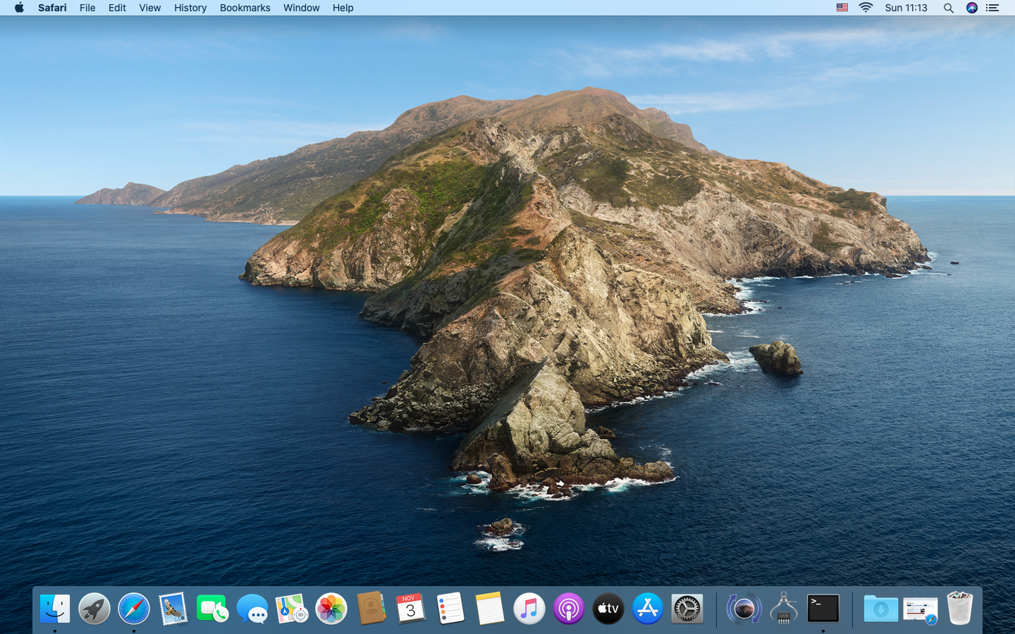

Catalina rocking on my 15" mid-2010 MacBook Pro. Who says a 9 years old laptop is useless :p
Just Did A Clean install on my SSD for Catalina with the latest Patches and now Transparency and everything is fully working. Thank you DosDude1 & ASentientBot you guys rock.
Greetings From Kenya

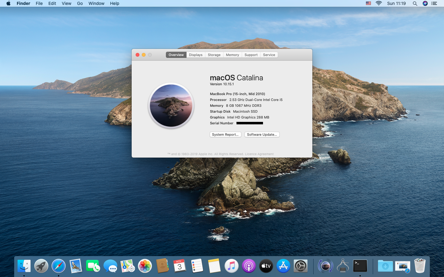

@ASentientBot what a great job. Right from the beginning Material patches are considered to be just temporary fixes. I knew/hoped the will be a better solution 👍🏻👍🏻👍🏻
Well, without the starting point that you and @pkouame gave me, I doubt I'd have ever figured it out.
So happy to be able to work with all you smart people, I'm learning a lot! 😄

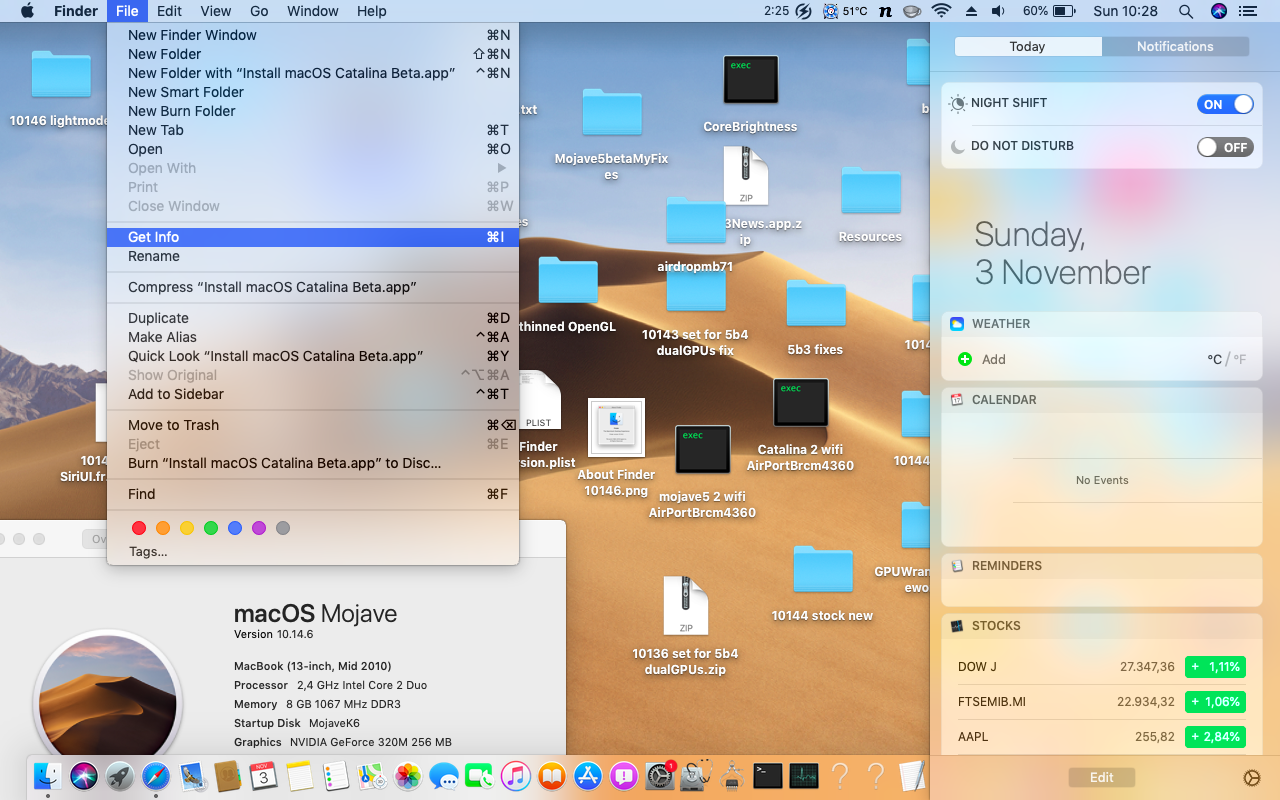

@ASentientBot of course your recent amazing "light mode" Catalina fix works on Mojave too, I just tested it unzipping the "transparency???????.zip" renaming your SkyLightOriginal to SkyLight and placing it in its Mojave /S/L/PrivateFrameworks/ path , even if my previous stock Mojave SkyLight was 4.6 MB, this one instead 3.8 MB (probably due to the i386 lipo) but it works quietly.
I guess the unsupported Mac's "darkmode early adopter users" will start to re-appreciate and enjoy the classic "OSX aqua theme" namely the "light mode".
Thanks once again for your incredible work.

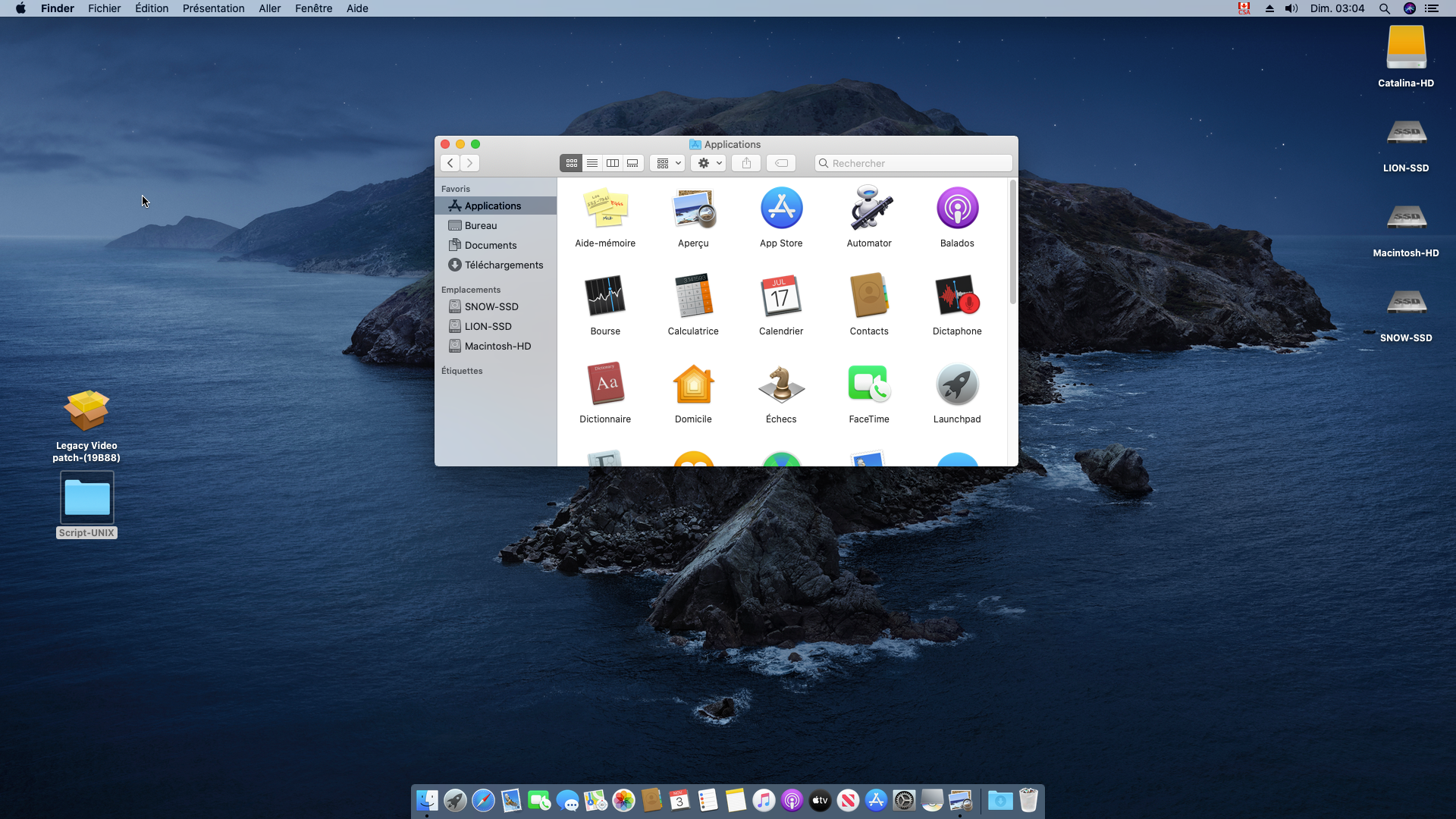

@dosdude1 there is definitely something wrong with this new Legacy Video Patch. I got this patch today again from patch updater and installed it, click restart and still waiting, it never makes a restart just like the yesterday. Patch Updater always makes easy restart but with this new patch it's just stuck.
