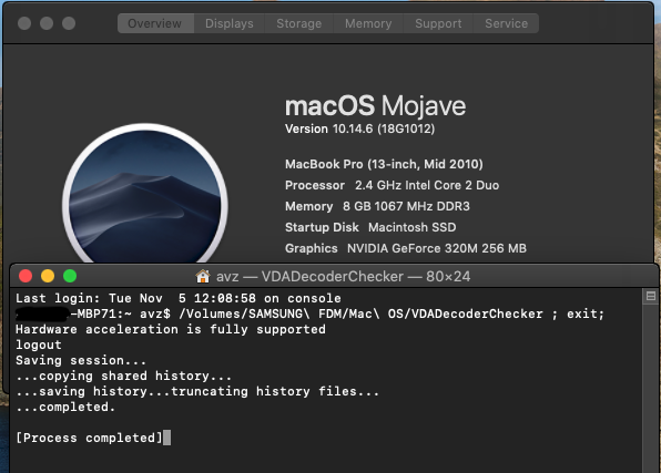

https://github.com/cylonbrain/VDADecoderCheck
I attach the compiled binary exec, but doesn't tell much, on MacBook7,1 from 10.13.6 and 10.14.6 for example it outputs just that a GPU is fully accelerated (click the blur to reveal):
Hardware acceleration is fully supported
while in Catalina it throws an error about a "VDA layer":
VDADecoderCreate failed. err: -12473
An error was returned by the decoder layer. This may happen for example because of bitstream/data errors during a decode operation. This error may also be returned from VDADecoderCreate when hardware decoder resources are available on the system but currently in use by another process.
Meanwhile internally I found these dependencies: CoreMedia.framework , CoreVideo.framework and VideoDecodeAcceleration.framework
  • VDADecoderChecker.zip

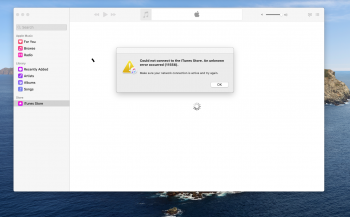

Hi all,
First of all, thanks to everyone that makes our old Macs new again. Just a new problem when I upgraded to 10.15.1 (iMac 8,1). The Music app, TV app and podcast app doesn't allow you to log into your account and won't let you authorize the computer. I have logged off iCloud and re logged into it via settings
Anyone else having this issues?
No issues here I am signed into iTunes,Music,Podcasts,and AppleTV
