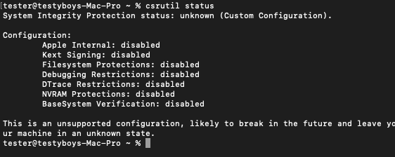

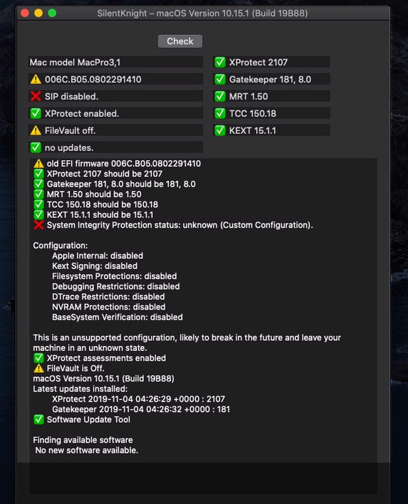

This response to csrutil status in Terminal for Catalina 19B88 seems oddly different from what I've seen before.

Silent Knight shows this:
Reactions: TimothyR734
Its that same in DP8 19A558d
rob@macBook-Pro ~ % csrutil status
System Integrity Protection status: unknown (Custom Configuration).
Configuration:
Apple Internal: disabled
Kext Signing: disabled
Filesystem Protections: disabled
Debugging Restrictions: disabled
DTrace Restrictions: disabled
NVRAM Protections: disabled
BaseSystem Verification: disabled
This is an unsupported configuration, likely to break in the future and leave your machine in an unknown state.

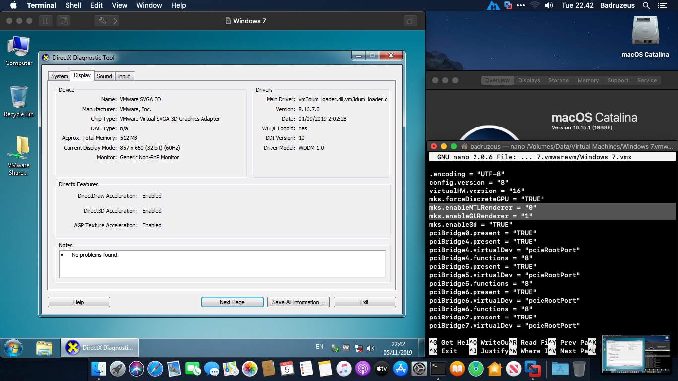

#AFAIK: Recent VMWare Fusion(s) force using Metal instead of OpenGL for 3D-Acceleration by default.
On this case, open your Windows 10 (or any Guest OS) *.vmx file with XML editor then add these lines:
Code:
mks.enableMTLRenderer = "0"
mks.enableGLRenderer = "1"
So, yes.. it' s VMWare Fusion related changes.
I did try these mks commands a few days ago, they do not work (though they should). I will try Parallels on this machine.
That's weird, I see no reason why it didn't work on your case.
I just did some tests with Intel HD3000 and Nvidia Fermi (OpenGL), they were working fine.
Pls note that when editing *.vmx file (adding those 2 mks lines) you've to Quit VMWare completely.
#EDIT: IMHO, this is not OffTopic since we just make sure that OpenGL is running on System & Apps, right?
Exactly, from your picture the Windows VM task bar is transparent, so it's video accelerated, probably the same will work with a Linux VM too, but I don't think is possible to achieve acceleration on any OSX virtual machine guest.
