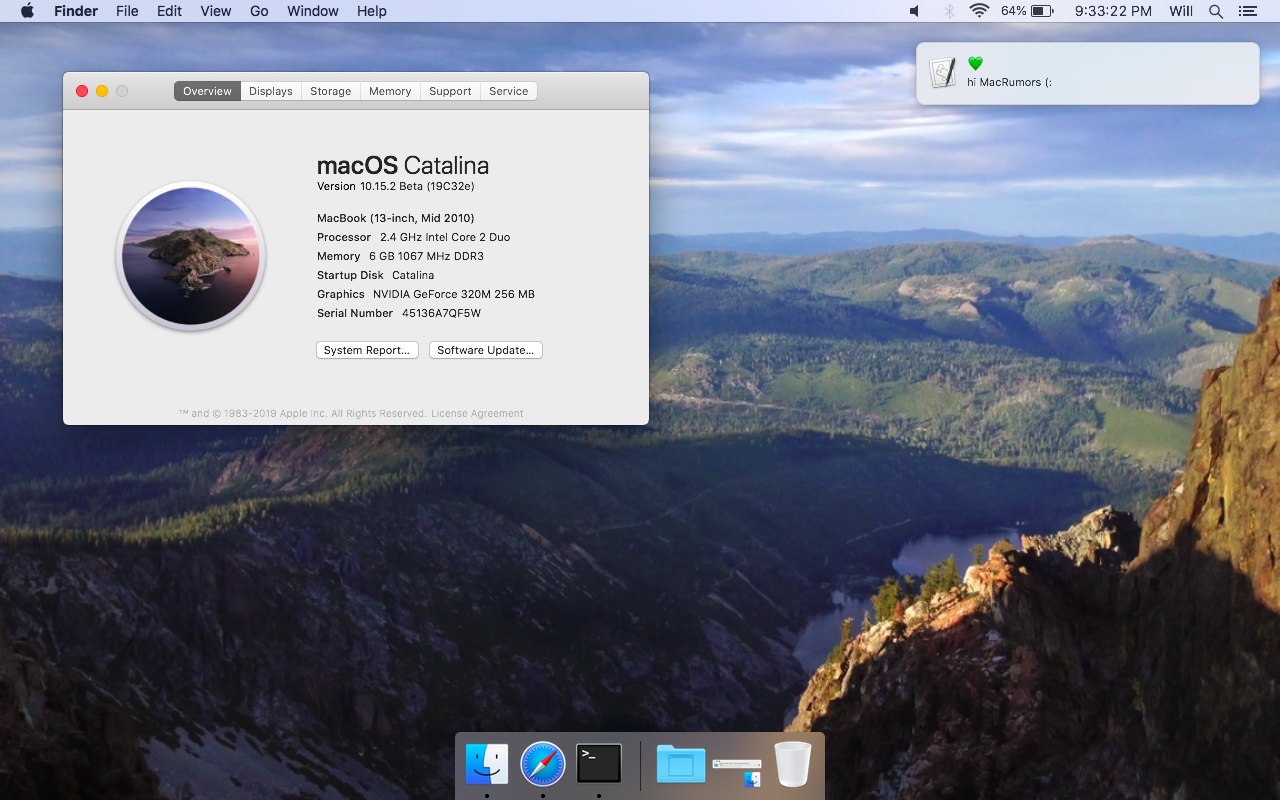

I miss new reports about macOS 10.15.2 DP1 Build 19C32e. Has not anyone tried to install? On my native Hackis it runs without any problems. I'm testing it tomorrow on my hack book, not underscored, (Medion Akoya P8610) where already the 10.15.1 final runs without any bugs 1a.
Just confirmed that Catalina 10.15.2 DP1 is working adequately on my non-Metal MacBook7,1.
I'll comment further on stability after using it for a little while. (I'm finally trying to make Catalina my primary system and I'm cautiously optimistic so far.)

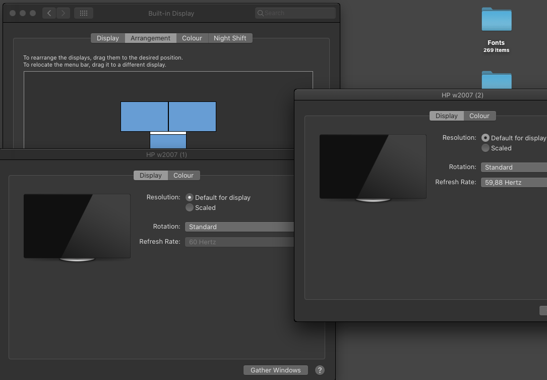

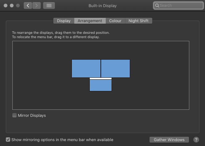

Hello
After Patch Updater asked me to update Legacy Video Card Patch my external display(s) no longer work... I re-installed the Video Card Patcher but no luck, the system knows they are connected, but no image at all :-(
I'm on a MacBook Pro 8,1 with Intel HD Graphics 3000 512 MB, Running macOS 10.15.1 (19B88)
Reactions: TimothyR734
Did you try to boot with no external monitor plugged in? Than plug one external M. in and look and configure it. Than plug in the second and configure it.
