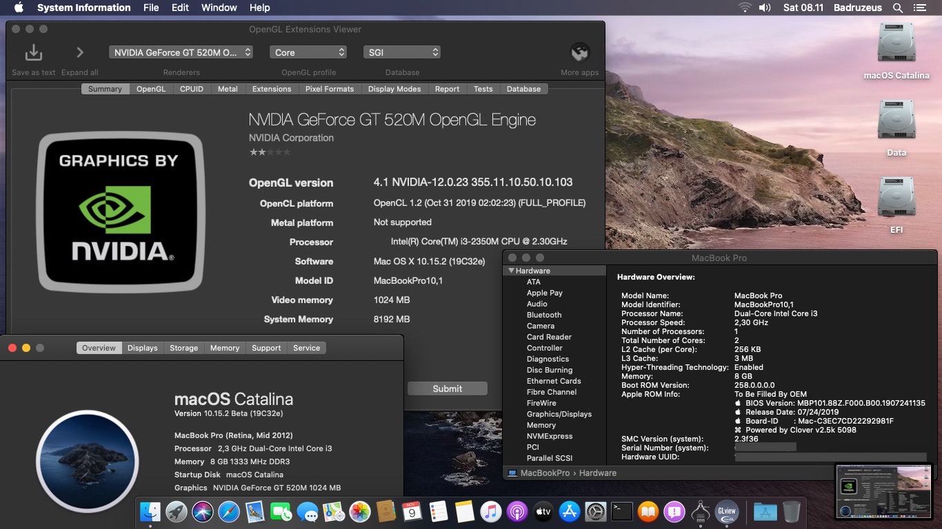

That's weird, I see no reason why it didn't work on your case.
I just did some tests with Intel HD3000 and Nvidia Fermi (OpenGL), they were working fine.

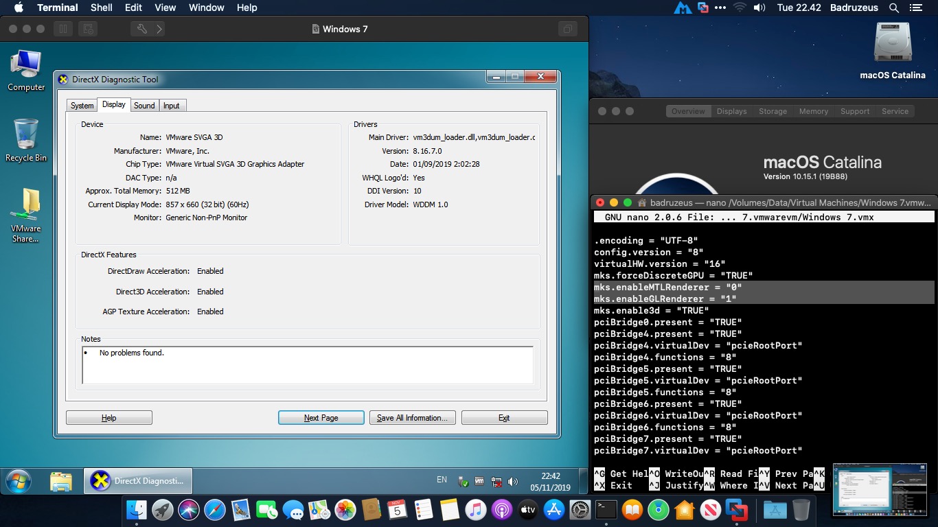

Pls note that when editing *.vmx file (adding those 2 mks lines) you've to Quit VMWare completely.
#EDIT: IMHO, this is not OffTopic since we just make sure that OpenGL is running on System & Apps, right?
Hi, Windows dxdiag does show, that 3D-accelartation does work, so the poping window does not mean anything. This is a only a small glitch, that VMware Fusion 11.5.0 does not recognize that.
3d-acceleration does work.
