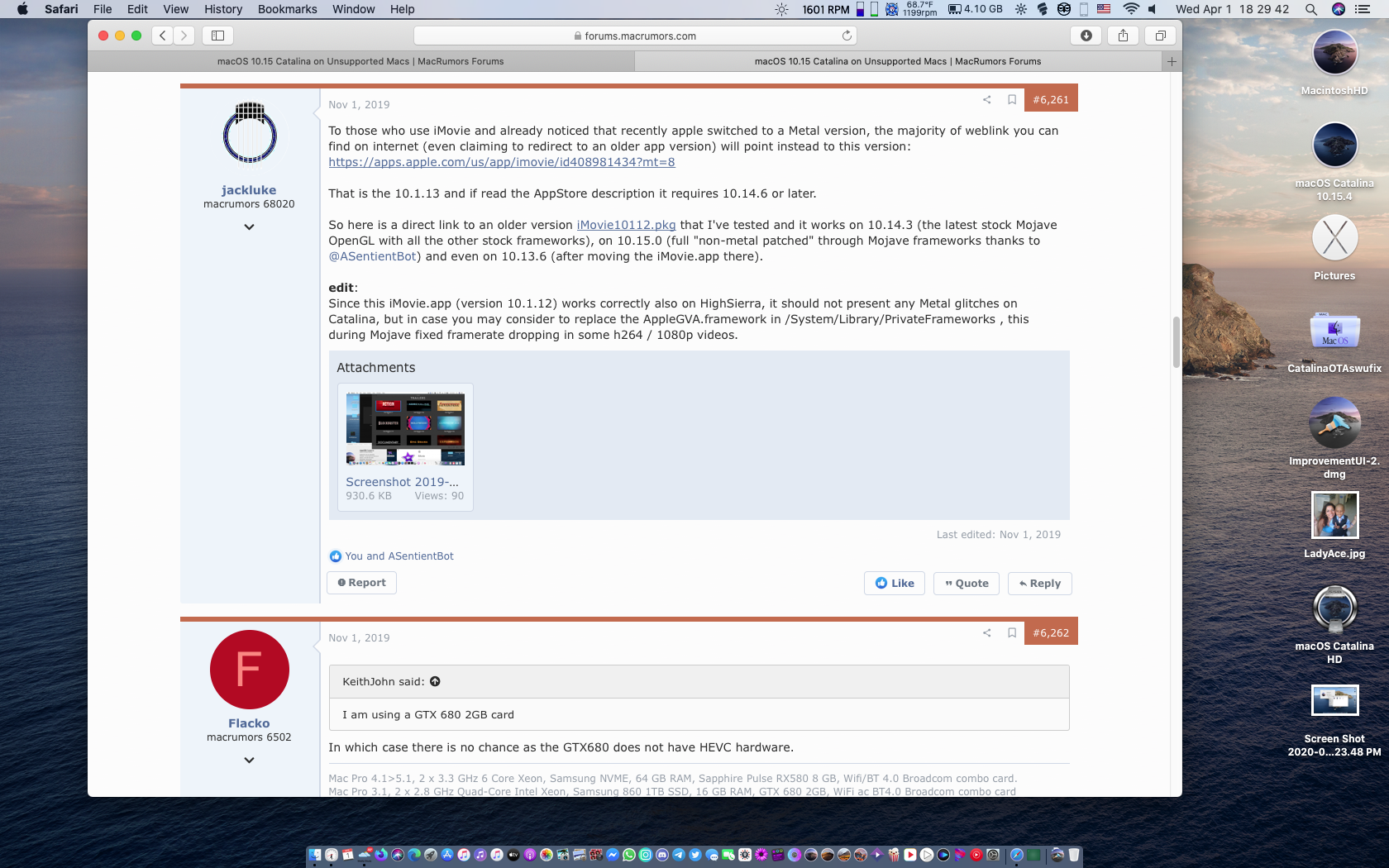

I just tried and mine is blacked out, I have 10.1.14.
looks like I need to find 10.1.12, if someone has a copy or knows of a link that would be great :)
There is a link to iMovie in that post 6261 install that one :)
The iMovie you want is part of the High Sierra install suite. If there is an old back-up on a drive somewhere it can be copied on top of the current iMovie without issues.
