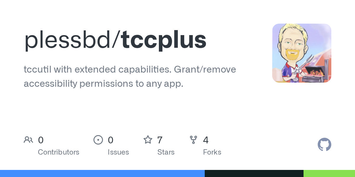

I can confirm this works for me
How to Use:
Open a terminal app (terminal or iterm2)
Find the App Bundle ID
Code:
grep 'BundleIdent' -A 1 /Applications/<APPLICATION NAME>/Contents/Info.plist
use CFBundleIdentifier with tccplus application
Code:
<PATH TO TCCPLUS>/tccplus add Microphone <CFBundleIdentifier>
Bash:
GrimMethos@iMac ~ % grep 'BundleIdent' -A 1 /Applications/Discord.app/Contents/Info.plist
    <key>CFBundleIdentifier</key>
    <string>com.hnc.Discord</string>
GrimMethos@iMacc ~ % grep 'BundleIdent' -A 1 /Applications/zoom.us.app/Contents/Info.plist
    <string>us.zoom.xos</string>
GrimMethos@iMac ~ % ./tccplus add Microphone com.hnc.Discord
Successfully added Microphone approval status for com.hnc.Discord
I cannot locate Bundle id APP, but i can open package content (selecting the installed APP on aplications, right click it) and then i can find info.plist and look for CFBundleIdentifier.
I'll try later to use tccplus... For camera is the same thing, put Camera instead Microphone, right?
in my example you need to replace <APPLICATION NAME> with the actual application
if you look at the "full example" I do it for zoom.us.app and Discord.app (your way of show package contents and then opening the Info.plist also works)
And yes for the camera put Camera

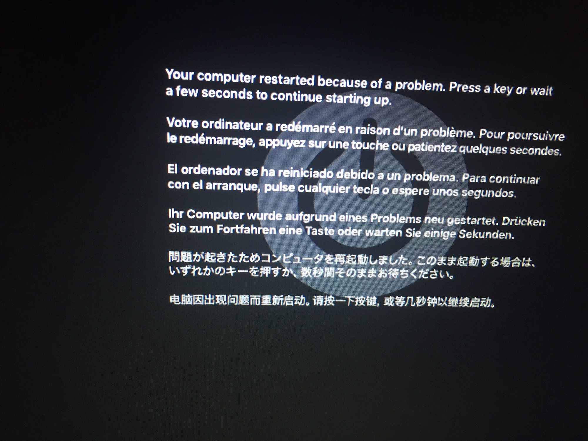

Can you post a screen of this reboot error?
Are you sure you applied the post-install patches targeting the correct Catalina volume?
If you retry to update, after OTA installation, when you re-apply the post-install patches try to don't select the APFS patch, that should keep the opencore bootloader installed (hold alt-option key after power-on picking EFI boot).
When you installed a patch you can't (easily) revert back, unless you re-install, so pay attention.
Thank you for the reply..
the message is in multi language. “The os has crashed, click any key to continue ( like the black screen message) except this I’d a white screen message.
I have to revert to the dosdude1 installer to go back to 10.15.4.
i do use the post patch installer, does not make any diff.
holding down the opt. Key only shows the startup drive. No Efi boot volume.

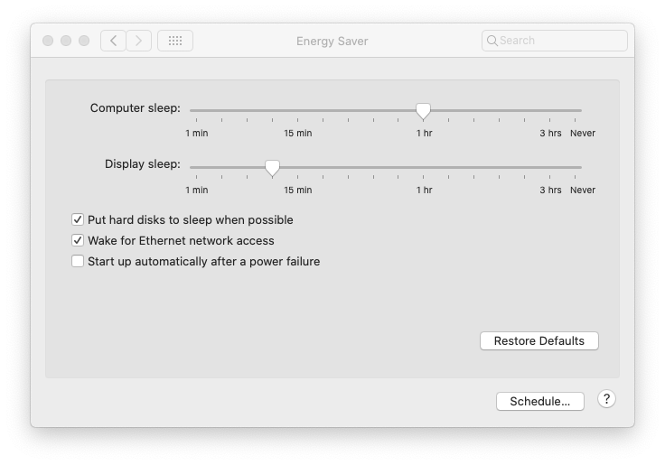

Pretty much what it says. When I tried to wake the MacPro from sleep in those instances, the monitor would never come back from black when the machine was supposed to wake. It appeared to be unresponsive and required a hard reboot. Fortunately that issue hasn't happened for quite sometime. My Energy Saver panel settings are just...
and in the Desktop & ScreenSaver panel I set a hot corner to 'Put Display to Sleep'. Normally, I shove the mouse to that corner and wait for the machine to sleep on its own. I never bother to explicitly sleep it from the Finder menu.
