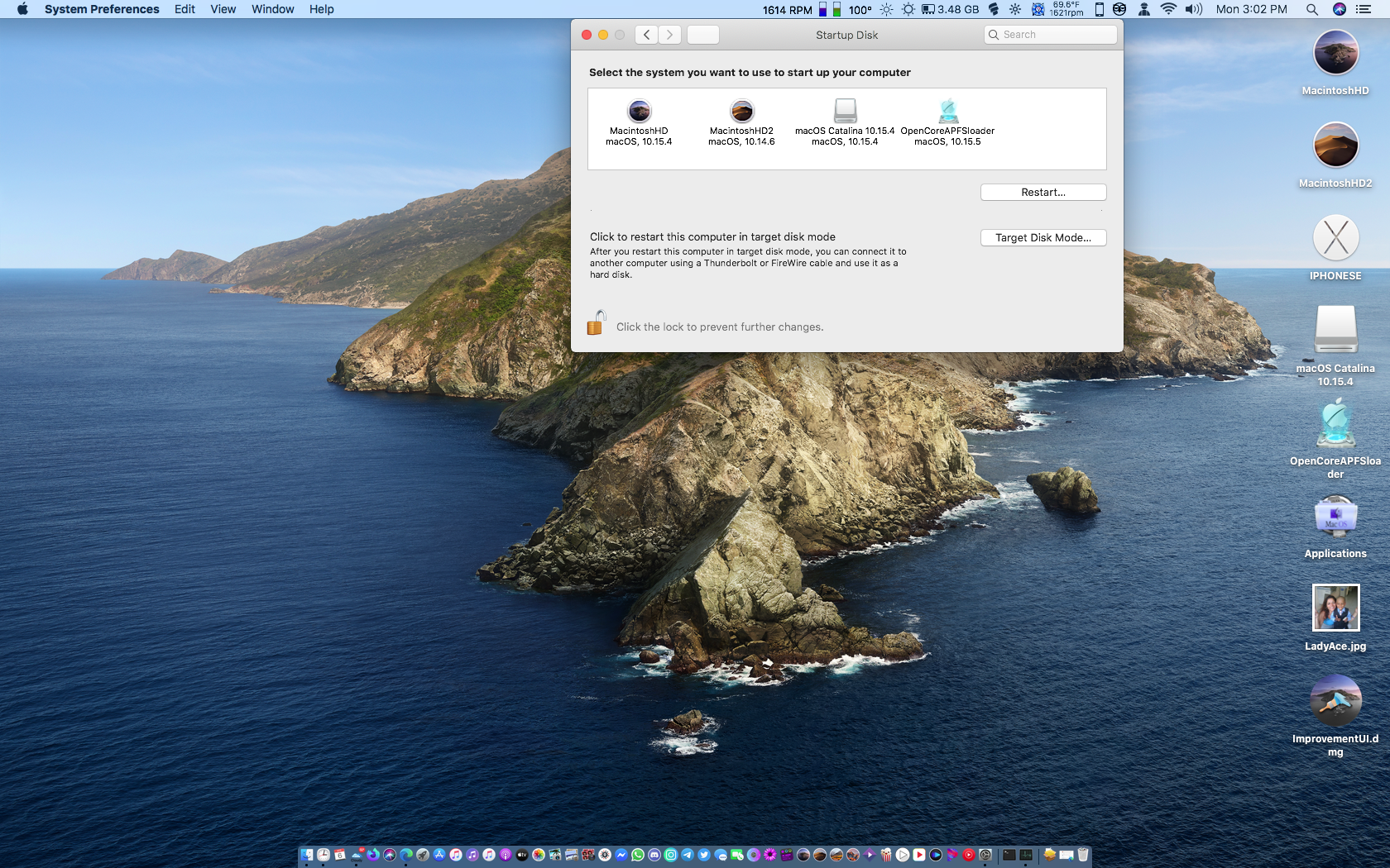

boot into one of your patchers Mojave or Catalina and at the top Apple logo click on that there should be an option to choose start up disk
Thanks, but this doesn't work – this is the standard startup disk selection which doesn't seem to be able to switch between patched installations on the same disk. Can I do the change manually via terminal? I see that APFS Boot Selector mounts the EFI partition, writes something and unmounts it again. It would be very handy to be able to get back to Catalina from Mojave…
What does the startup disk look like in SYSTem Preferences another option is if you have a spare usb at least 512mb I used a 4gb and created the OpenCoreAPFSloader it works to choose a disk to start up

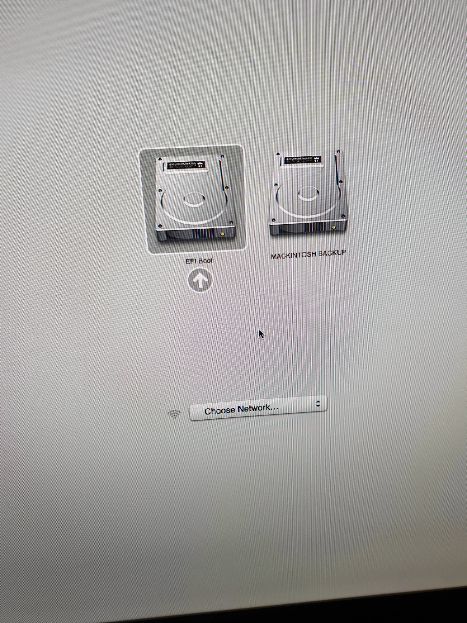

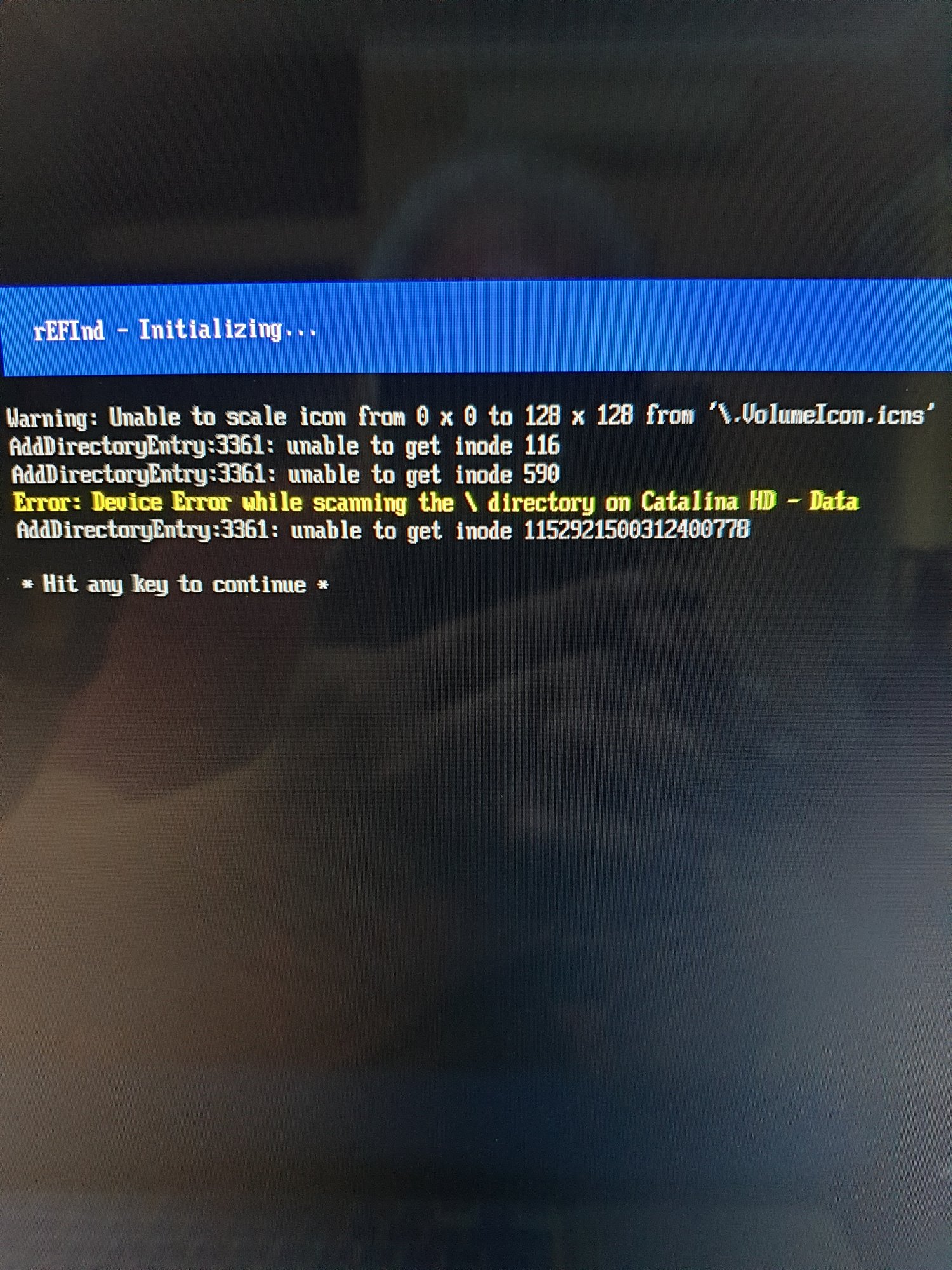

It seems I have had bad luck for a while. Eve since I took a jump to upgrade catalina from 10.15.2 to .4 all is hell.
I lost 2 ssd disk volumes as suddenly my drive doesnot show up even while pressing option key to boot. I have to format the internal ssd again and load OS.
See images below
I lost My Mojave volume hd as well as Catalina OS Volume.
Now I dont know what to do.
I wonder I should go back to 10.15.3 using Dosdude patch 1.3.1 or back to 10.15.2 which was working ok.
Why has Mojave crashed too I dont know. I have right now installed both High Sierra & Mojave on external drive of which Mojave volume does not show. I see round circle with dash diagonally like a stop sign which means the volume is corrupted. Need to re install mojave too.:eek::eek:
@Dilli proceed this way:
1) Do a PRAM: https://support.apple.com/en-us/HT204063
2) to boot Mojave, plug and boot from any USB Installer (also an HighSierra installer), open a recovery terminal and type:
Code:
csrutil disable
nvram boot-args="-no_compat_check"
reboot
3) That refind issue is because you uninstalled OpenCore, so try use this again: OpenCoreAPFSloaderupdate.app.zip
My OpenCore setup configuration can't corrupt any Volume, it's just a coincidence in your case, I guess there some incompatibility with your non-EFI Metal GPU.
From that refind verbose message scanning directory "Catalina HD - Data" this is due to a faulty hard disk or a failed upgrade process from 10.15.2 to 10.15.4 rather than opencore, so I can assure it's not opencore your main issue.
