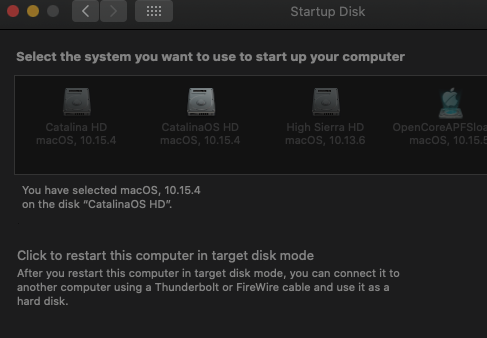

Yes Now its showing correctly in prefpane. Catalina HD is already selected
Do I still need to do PRAM after shutting my machine.

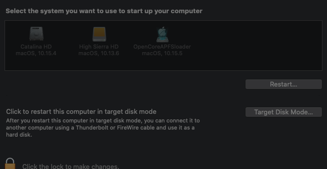

Here is what I did. I installed fresh Catalina 10.15.4 on new partition of Crucial 1TB SSD, once OS was loaded I opened iMac and installed SSD internally.
I started the system normally and it took me to login screen. When I pressed option key I see all volumes listed again. That means the SSD of Samsung is working but maybe the Catalina OS is corrupted.
here is image of startup disk
Thanks @jackluke for all your support and guidance. Now my iMac boots to login screen with normal startup.👍
