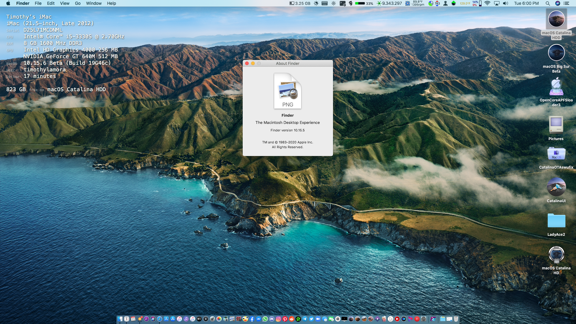

Hi Barry. I held down the Power Button and the MBP turned off. I turned it back on but still the "Flashing folder with Question mark". Thank you for providing the reassurance that I'm using the most current Boot ROM.
[automerge]1592960570[/automerge]
Can anyone search your Mac for the finder.png I tried one I found from MacOS Big Sur and doesn't work thank you :)
