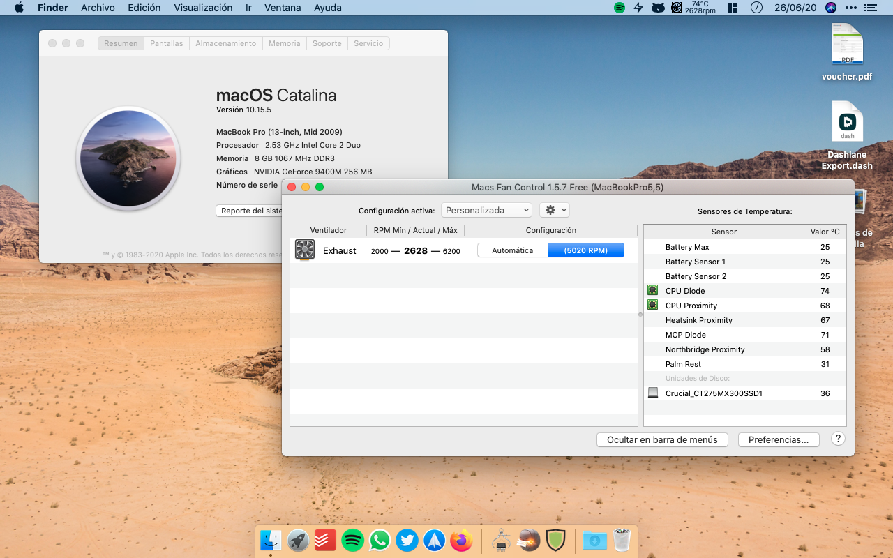

Hello!
I was on Cat 15.3 and my fan started making a weird noise (since Cat 15.5 was available I didn't take it seriously)
now after two weeks problem reappears ... I put manual setting to 5000 RPM and only got half capacity and the weird noise continues
any idea how to solve it without a clean install?
Reactions: TimothyR734

I would say your fan is faulty. It´s very easy and cheap to replace it.

Replace fan

You are using a free Mac Fan Control version which is only allows monitoring. Are you sure you don't have to pay for the full version?

Could be a dust bunny or long hair in fan assy. Try compressed air before replacing that fan?
