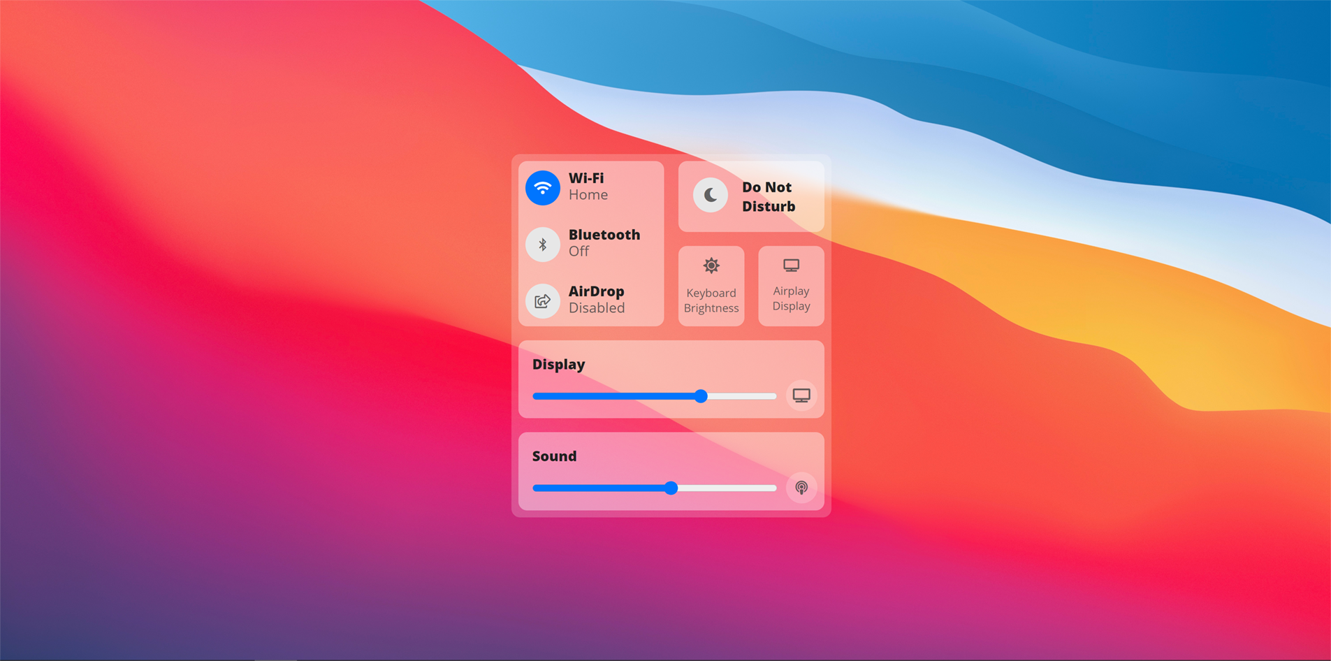

Does anyone know how we can get this to work in Catalina
  • macos-bigsur-controlcenter-css-master.zip
Reactions: telepati

I know, but that patch got rid of the annoying transparency in the menu bar
well if you don't like transparency you could go into /System/Preferences /Accessibility /Display and turn on reduced transparency

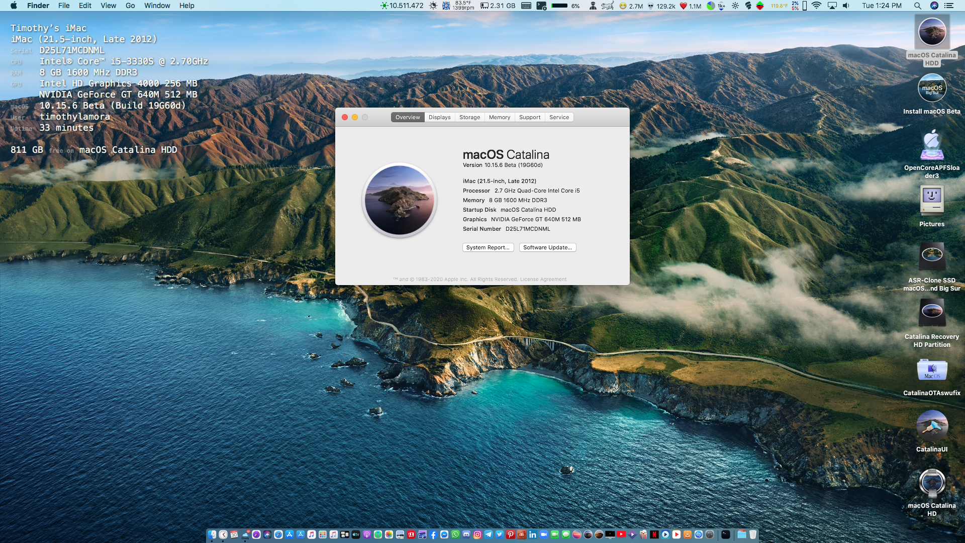

[automerge]1593549246[/automerge]
installed 10.15.6 Dev Beta 3and for those who changed your icons to the Big Sur icons the only one that changed back to the original was Safari the rest didn't change :)
