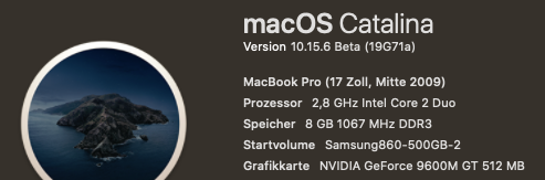

Dot 6 beta 4 is out.
On MBP5,2 beta 4 installed OTA and running fine, transparency is there.
(usual tools - CatalinaOTAswufix, OpenCore boot for 2nd OTA phase, 1.4.4 post-install patches, patch updater for NightShift)

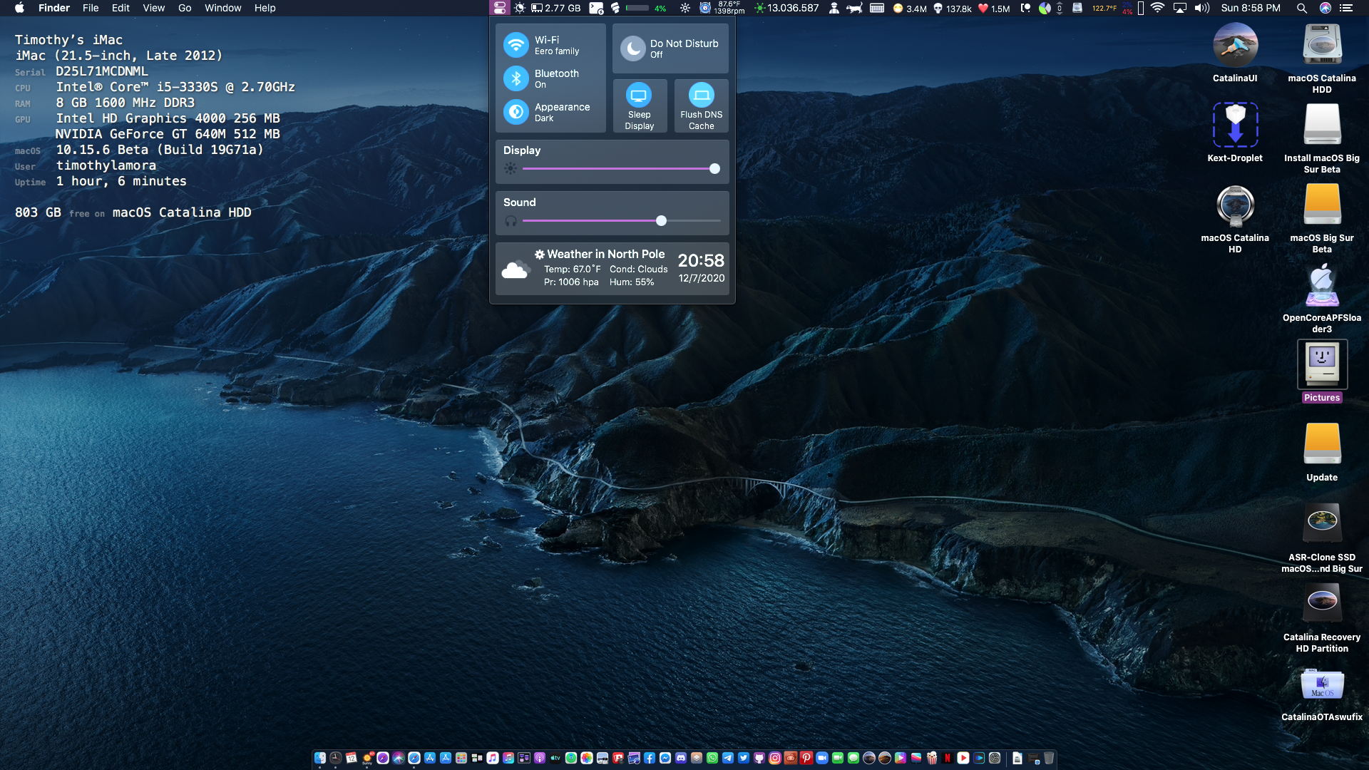

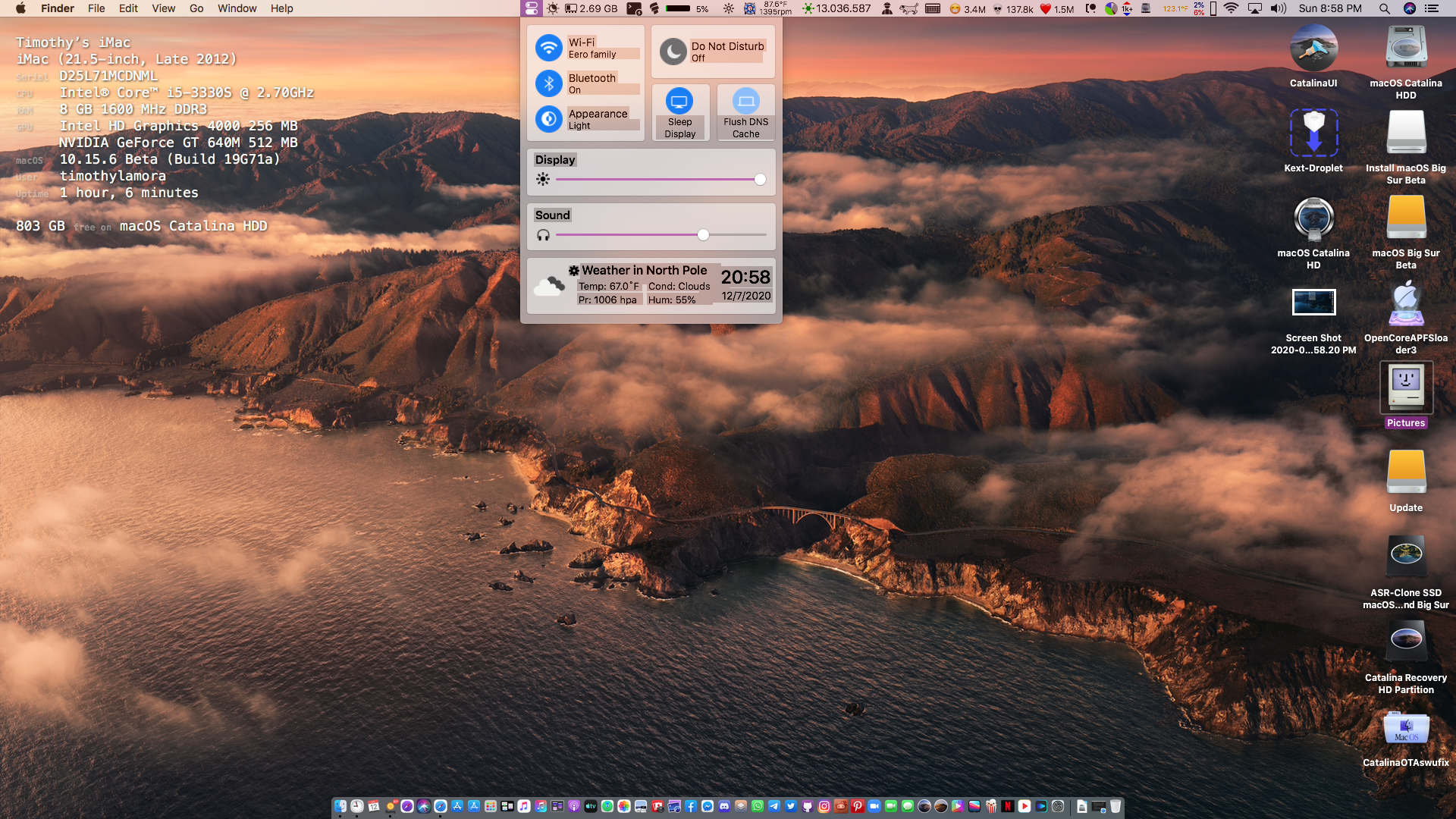

View attachment 933385View attachment 933386
[automerge]1594612932[/automerge]
very good thank you Minh works good :)
Looks really good, but I cannot get it to run: Gatekeeper or Xprotect prohibit execution... "it´s recommended to discard the app to trash" or so. I even tried to self-sign it on my machine, which works without complaint but it still throws the same message and does not start...
(10.15.5 build F101).
Any clue here - or does it have to be compiled for that build of Catalina?
Run in Terminal sudo spctl --master-disable
