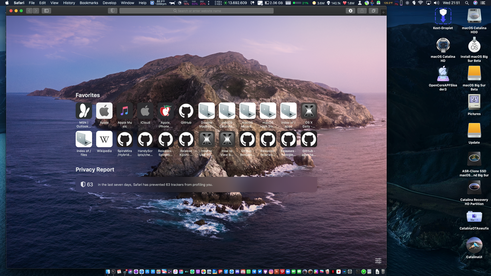

cool feature of Safari 14 you can change the background

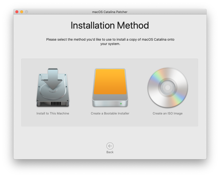

I assume you are using a Metal graphics card in a cMP5.1 which does not have a boot screen. Dosdude1 put an option in the patcher to help with this. See left hand icon selection below then follow the instructions. I have used this method for both a cMP3.1 and cMP5.1 with no issues and it is faster than using the usb method. You can make a usb later for emergency use if required. Another issue you may not have used is in the menu bar of the patcher under options. Make sure "disable APFS booter" is ticked before you start as the cMP5.1 does not need this. If you give us more detail of your setup in the signature then advice can be more specific. Good luck and back up first!

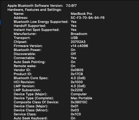

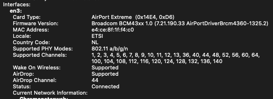

I have a MacBook Pro 8,1 with a Bluetooth ASUS BT 4.0 dongle (which has a Broadcom BCM20702A1 chip).
Here is what system report says:
AirDrop in Finder works 100% with both older Macs and new and my iPhone 11 Pro.
In older versions of macOS this ASUS BT-400 dongle was recommended for using Continuity Activation Tool. Obviously that doesn't work on Catalina anymore, which is when I found your great work.
Thanks for all your help!

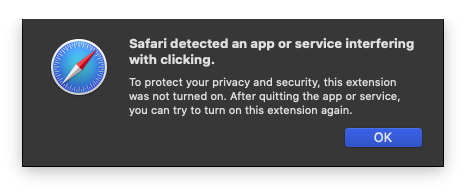

I updated my iMac 9,1 with v1.4.4 looks everything ok. But there is a new improvement about Safari extension but I don't get it what that it is. (which app or service that is it mention) Maybe @jackluke @dosdude1 @ASentientBot lightning us about this. Now when we click to extension, the extension gives a pop up why we cant activate the extensions. Here it is;
BTW I found an apple article about that I will try it;
Edit: I follow the article suggestion but it didnt help still giving the same pop-up warning on Safe Boot. 😢
