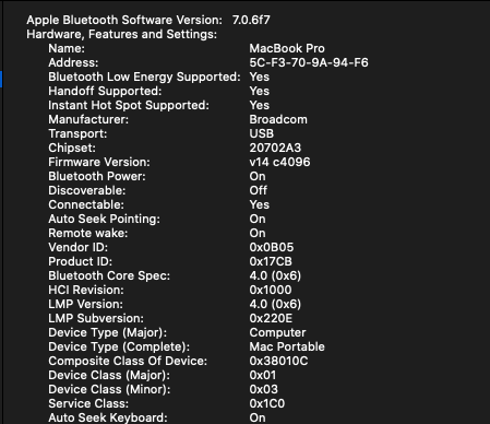

I have a MacBook Pro 8,1 with a Bluetooth ASUS BT 4.0 dongle (which has a Broadcom BCM20702A1 chip).
Here is what system report says:
View attachment 934341View attachment 934344
AirDrop in Finder works 100% with both older Macs and new and my iPhone 11 Pro.
In older versions of macOS this ASUS BT-400 dongle was recommended for using Continuity Activation Tool. Obviously that doesn't work on Catalina anymore, which is when I found your great work.
Thanks for all your help!
Even with the new Bluetooth file, no dice.
thanks for all your help, if you can help fix it, great, otherwise no continuity.
If you have AirDrop on Catalina Finder, applied the catalinacontinuity fix and replaced the Bluetooth file, then try to plug with an USB cable your iOS device to the Catalina Mac, then from Catalina Finder select it and click Trust, after from the iOS device tap Authorize .
If still for example handoff is not working, then try from Catalina System Preferences to sign-out from your Apple ID , reboot and then sign-in again, your iOS device and Catalina Mac must use the same Apple ID (iCloud account), and I guess you need also the iCloud 2FA two factor authentication enabled.
That worked!!! Thanks so much!

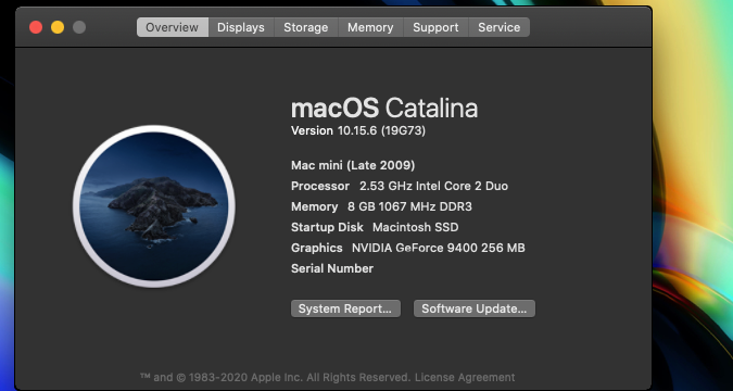

Yet another success via Patcher 1.4.4 by USB over 10.15.5supp. Total install effort took less than 1 hour w/ no drama, dot 6 uses a tad less overhead than dot5supp. This is the 7th iteration of Catalina on this Mini3,1 via dosdude1 patchers which have become very reliable.
yat another success w: 1.4.4.png
