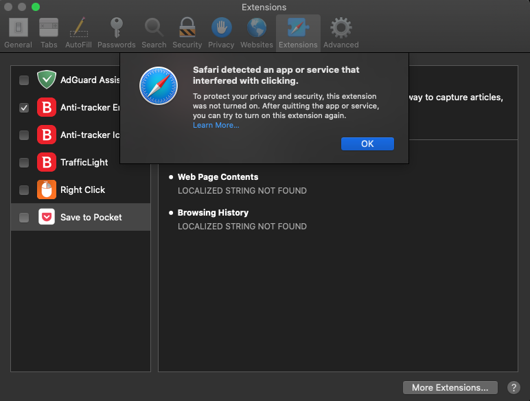

Updated Safari to version 14, Seed 1 on my unsupported MBP from 2009. Getting this error whenever I try to enable an extension:
"Safari detected an app or service that interfered with clicking."
What app or service is this? And is there a command that I can run from Terminal to permanently disable this app/ service that is interfering with clicking?
I checked the Learn More link, which only talks about booting into Safe Mode to enable extensions. And Google did not show any other results for this error.
I also updated to Safari 14 in my 10.15.6 setup, and saw the same error.
In my case I had enabled an extension by mistake. Disabled it then (even uninstalled I think). I think it was an ad blocker. In my case I don't miss Safari extensions. Maybe Safari wants to do such things on its own now.
