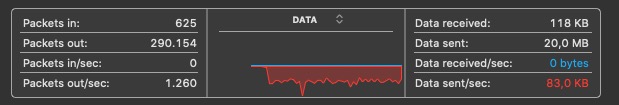

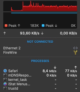

Day to all.
Just did a clean install of 10.15.7 to my MacPro 3.1 with dosdude patcher. All is working OK, but 2 things.
1. internet connection works fine, but I don't get a speed readout in activity monitor for downloads. It stays on 0 all the time, same as iStat menus. I do get a download speed per process, but not combined (pic 1 & 2)
2. the icloud ID picture shows up in system preferences and disappears randomly.
Did anyone have such problems? View attachment 960083 View attachment 960082
