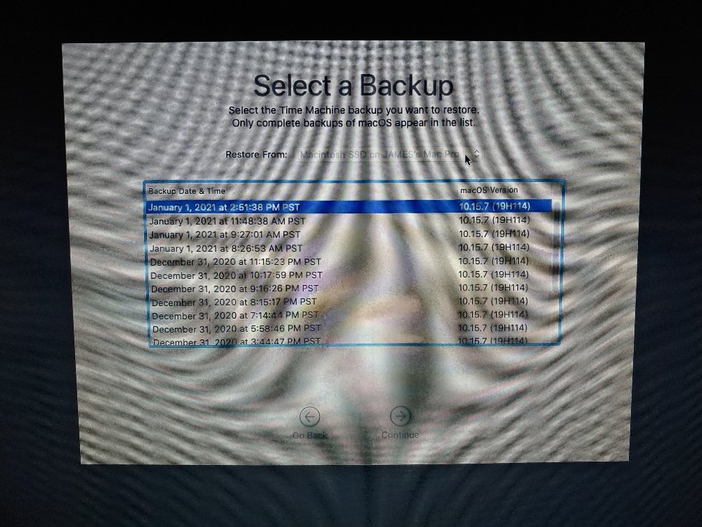

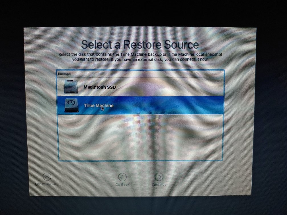

When booting into recovery from an external drive such as the one created using the DosDude1 installer, why does the Time Machine 'Select a Restore Source' menu show both my internal HFS+ TM drive as well as my APFS SSD boot drive?
Further complicating matters is that if the TM drive is selected and you go into the 'Select Backup' menu screen, the 'Restore From' drop down is grayed out and defaults to the SSD boot drive. This makes a full TM restoration from the TM drive to the boot drive impossible.
I haven't tested this but I'm assuming the only way to perform a full TM restoration from a TM drive to a boot drive would be to format the boot device first so there's nothing on it. Is my assumption correct?
In the meantime, I'm going to look at some other backup and recovery utilities, but would like to get a definitive answer on the above. The behavior of TM in Catalina is far different than that of High Sierra or any Mac OS preceding it.
Well, I think I figured out what's going on. Since my 2008 3,1 MP can't boot from an APFS drive natively due to Apple not updating the BIOS or firmware, recovery won't allow a TM restore to the boot drive.
I made this connection after trying to boot from a CCC backup and realized that CCC at the beginning of the backup process, reformatted my external USB hard drive using APFS rather than HFS. My Mac did not show the CCC backup drive as being an available choice. To get around this, I used OpenCoreAPFSloader3 on a thumb drive, and voila! My CCC APFS backup volume was visible and bootable.
Now I just have to see if OpenCoreAPFSloader3 can be used to start recovery from my internal boot SSD. If it can, then TM restoration should work the way it was intended.
Just thought I'd post my findings here in case anyone was curious.
Edit: nope. Still can't initiate a TM restore from recovery even if using OpenCoreAPFSloader3. I still get the same error message about not being able to boot from an APFS device. Looks like CCC will have to be the primary backup and recovery tool. Time Machine can be used for small file recovery but that's about it.
