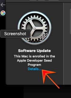

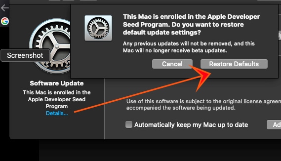

From the SW Update CP -
No more Betas.
No more Betas.

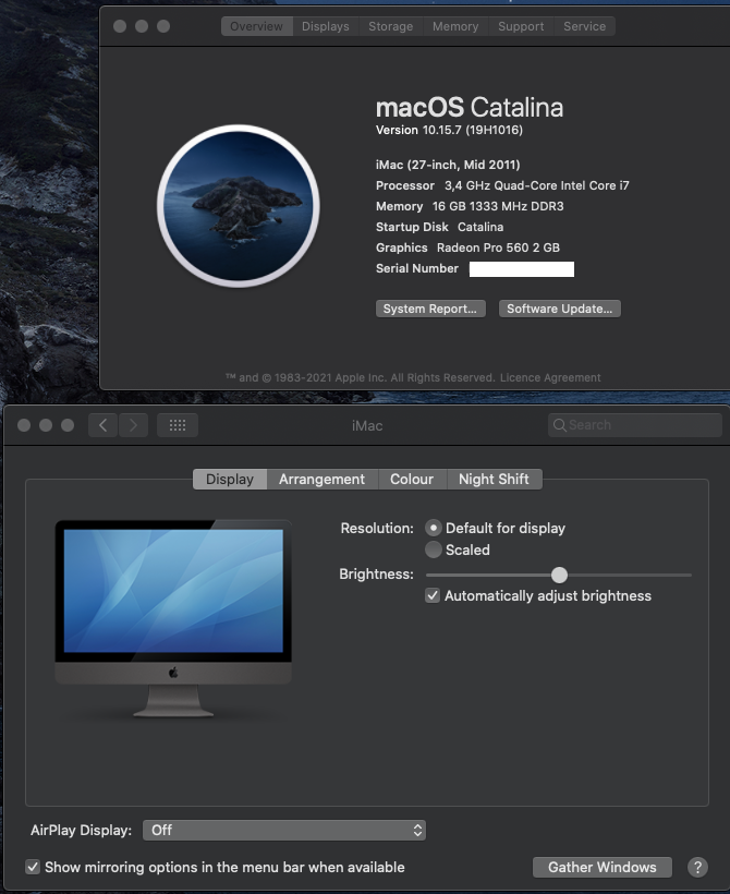

Not really sure if I should post this right now, but I left the @dosdude1 way completely three month ago starting to build my own OpenCore based special config for iMac12, 2 and 11,x systems (using the @jackluke OC USB installer as a blue print and the list of extension to inject with OpenCore I got from my own system after @dosdude1 patching).
And yes, I simply installed 19H15 yesterday (fresh using the unpatched Catalina installer) and applied the 19H524 via OTA, switched then to the DeveloperSeed and did the same with the 19H1016. I had to reboot in both cases twice to get the system (nearly) fully working, recognition of the internal screen seems to be broken after first boot. But this may also be a limitation of OpenCore.
Sound is broken without patching. But I use a BT sound cube to overcome this. It is a desktop system. The users really familiar with OpenCore and building hackintosh style configs should take a look at the OCLP (OpenCore Legacy Patcher) for Big Sur and use this a a starting config.

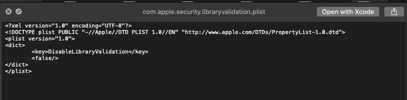

I don't have too. How is it look your libraryvalidation.plist under Library/Preferences;
Could you please check your boot args with nvram -p command on Terminal? Do you have any boot args?
