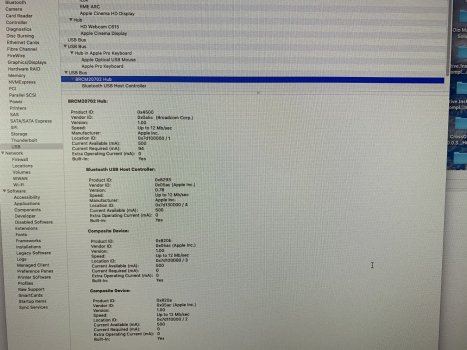

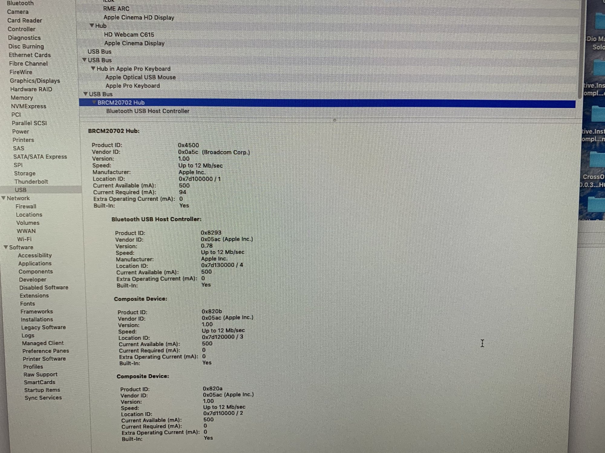

It’s the no Bluetooth hardware message that worries me... faulty card, adapter or driver issue? Time will tell when replacement comes.

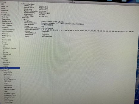

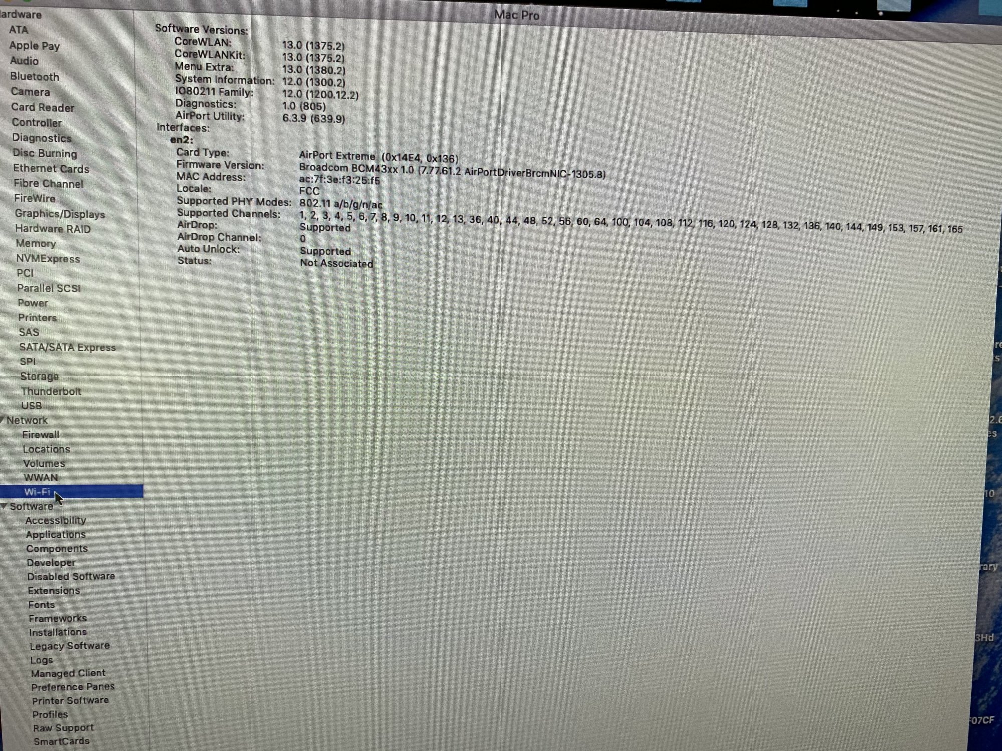

After reinstalled Mojave without Broadcom WiFi patch it looks like our cards are the same based on screenshots and the card shows up in USB devices as a Bluetooth USB Host Controller but in the Apple menu under the Bluetooth icon it says “Bluetooth: Not available”. Also WiFi cannot be turned on. I have tried deleting WiFi and re-adding in Network preferences but makes no difference.
Update: I booted up holding shift, control + option as someone suggested and now the WiFi attempts to connect and then tries again every five or six seconds similar to what you described. I checked the contents of the IO80211Family.kext and the AirportBrcm4360.kext is present. Totally confused now. Hoping replacement card and adapter will function properly when it comes.

I will make screenshots of mine so we can see if it is the same card.
This is mi card. Is it the same?

Ok. I got it. You have to make a SMC reset. Unplug the power cord. Wait 1 minute. Plug it again and wait 5 seconds before switch on.
Okay. Did SMC reset followed by PRAM reset (3 chimes) and still WiFi attempts to connect over and over. Bluetooth still not available and no system preference pane for it.

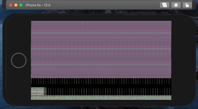

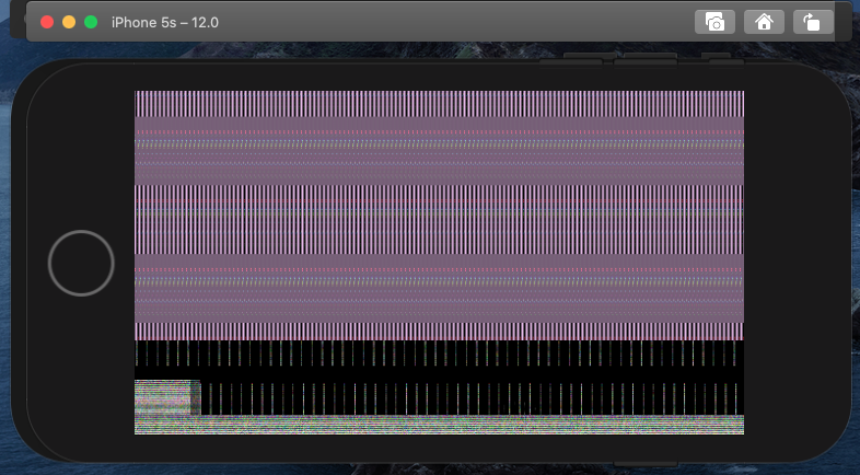

Hey all!
I managed to get this installed on my 15 inch Late 2011 Macbook Pro which is awesome! BUT.... I noticed something funky with the graphics/display/driver(?).
When I drag windows around, there is noticeable lag and tearing, minimizing/maximizing window into dock the animation is definitely slower, there are odd artifacts in window elements that go away when moving things around and most worrisome is now some simulators on Xcode are completely unusable because they have massive graphic glitches and artifacts :(
Does anyone know what could be the issue? I'm hoping I could install some sort of graphic driver update or something.
Thanks in advance for the help! :)

Hey all!

You own an MacBook Pro with an AMD Radeon 6xxx GPU?
Check the first post, especially the "Spoiler: AMD Radeon HD 5xxx/6xxx Series Video Card Acceleration". You can disable your AMD GPU. Search this thread, the forum or the net how to do this....

There is no kind of acceleration available for this particular GPU family on Mojave, Catalina or Big Sur. What do you expect to break?
You have there options:
1) Go back to High Sierra
2) Disable the GPU and stay on Catalina or Mojave
3) Buy another system with a metal GPU
There are (to my knowledge) two ways:
a persistent solution good for broken GPUs
a software solution using some NVRAM data not persistent (does not survive a PRAM reset)
P.S.: I am not an expert on this, just replaced my Radeon 6970 with an AMD WX4170 - an option you do not have.
