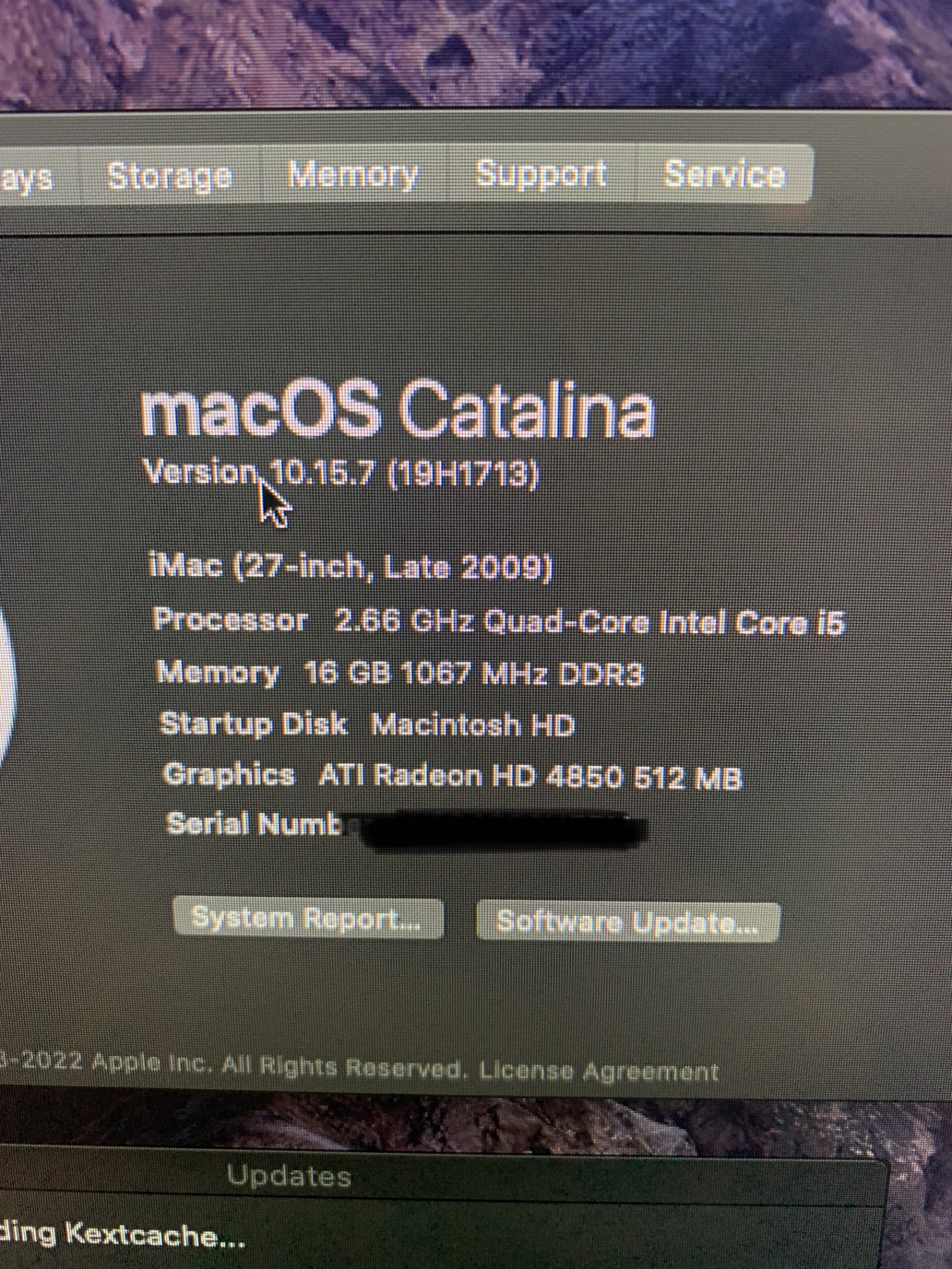

looks like I got it!!!

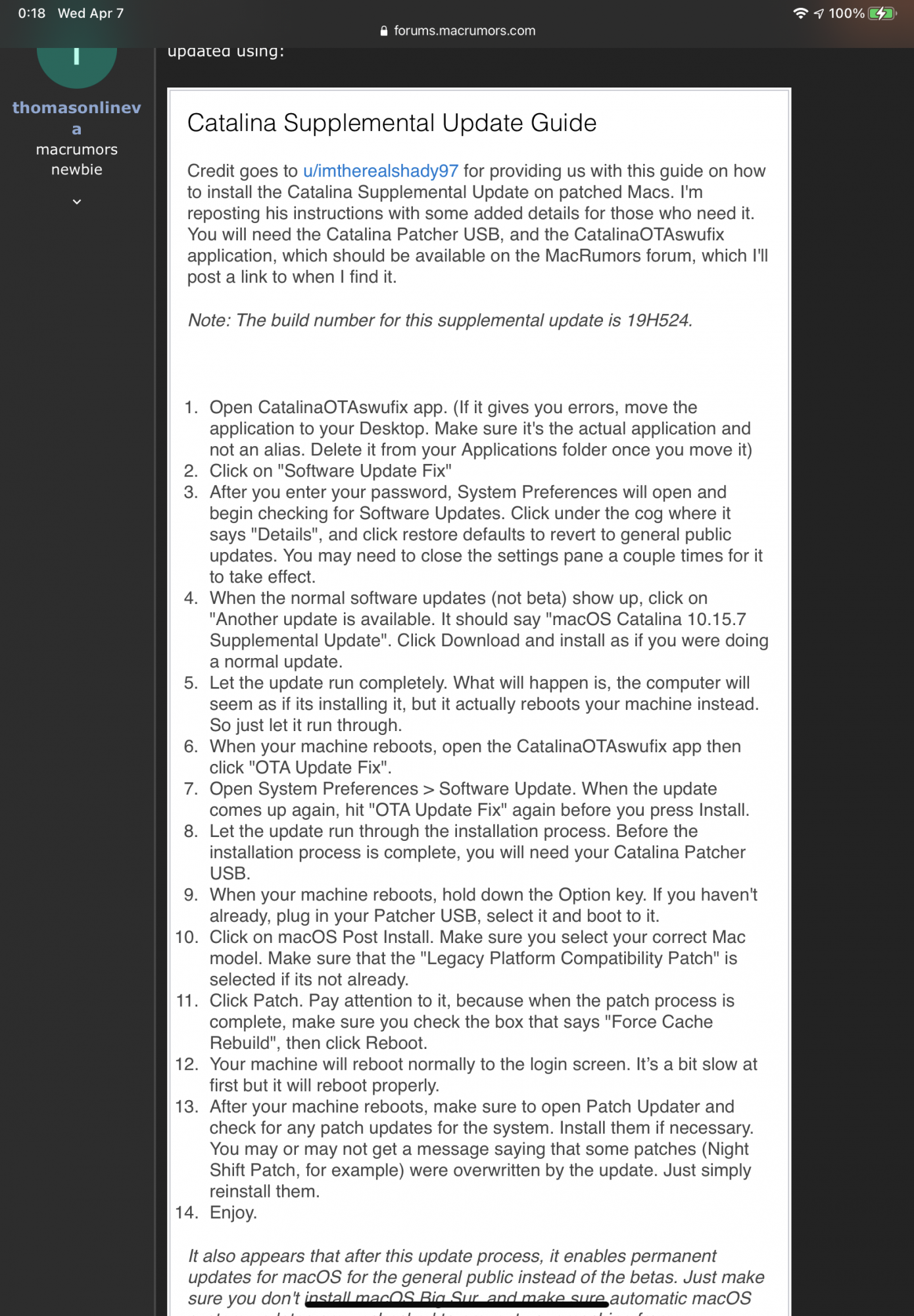

To update dosdude1 patched Catalina properly, please read the first post of this thread about “enabling Ota updates.” Its right at the top.
You must follow the steps outlined in post #13,956 very carefully.
THIS POST IS THE LAW
there is no room for improvisation.
Read it a few times slowly and go through the process slowly and follow the steps exactly as they are written.
Reposted again below. If you have trouble, follow K two’s advice about deleting files in post # 15,270.

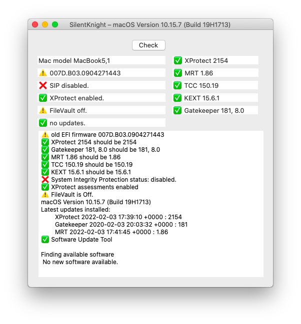

Sorry, it took me a while. I recently bought a new M1 13" Macbook and I do not start the old one so often anymore.
Thanks to all of you - Everything worked smoothly as usual for the installation (incl. the latest version of SilentKnight 1.18).
