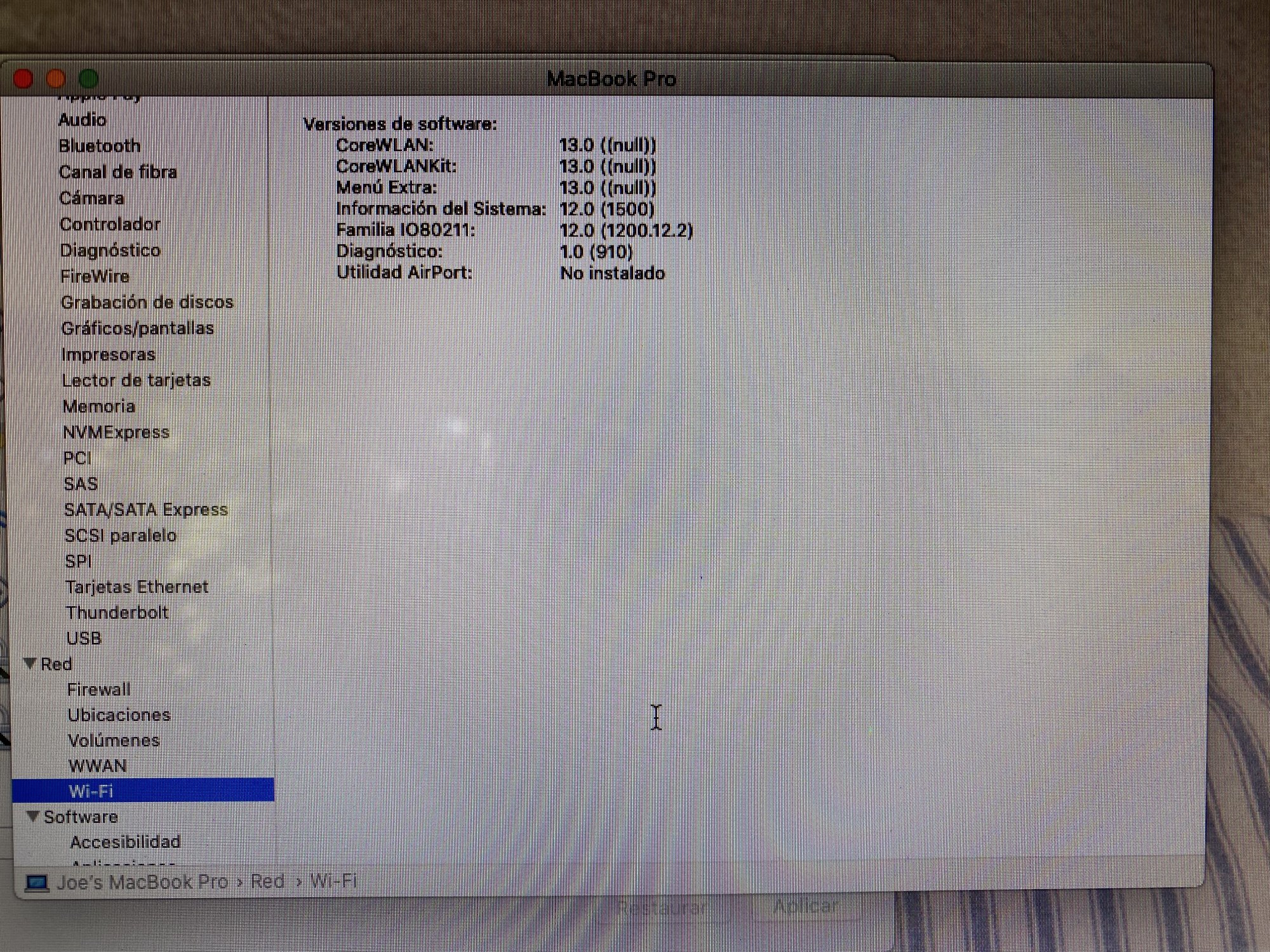

*UPDATE* Resolved now as after updating the patcher, the wifi is working!
I'm wondering if anyone could help :) I have upgraded my 2011 15" MBP from High Sierra to Catalina and everything is working fine except that WiFi seems to be disabled? I can click the icon in the menu bar, but no networks appear, and this appears under system information. I've run the patcher's recommended patches for a MacBook Pro 8,2. Any help is appreciated! View attachment 1970110
Did you try an SMC and PRAM reset?

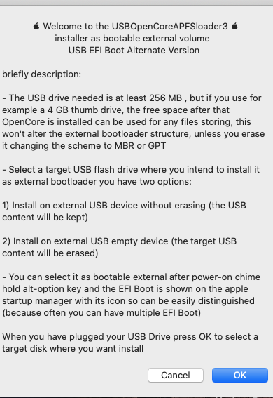

I am getting the following error:
mount_msdos: /dev/disk9s1: Resource busy
mount: /Volumes/EFIext failed with 71 (71)
If I hit OK, I eventually get a notification that says:
USBOpenCoreAPFSLoader3 - Do not remove the USB drive during this phase. USB preparing please wait a couple of minutes.
After leaving it for over an hour I received no further updates, am unclear if anything happened as the drive seems empty still.

You might try that and make sure your usb is formatted extended journaled instead of APFS

Ok, the extended journaled was necessary. I am getting the same error at the end and a notification that says, Almost done, to complete the USB drive allow the script with your current user. Even though the drive mounts again successfully and appears to be 1.85GB down from 2GB. Did this work?

Try a USB >=4GB capacity, even though the app is very small and is going to be installed in the EFI part of your USB.
