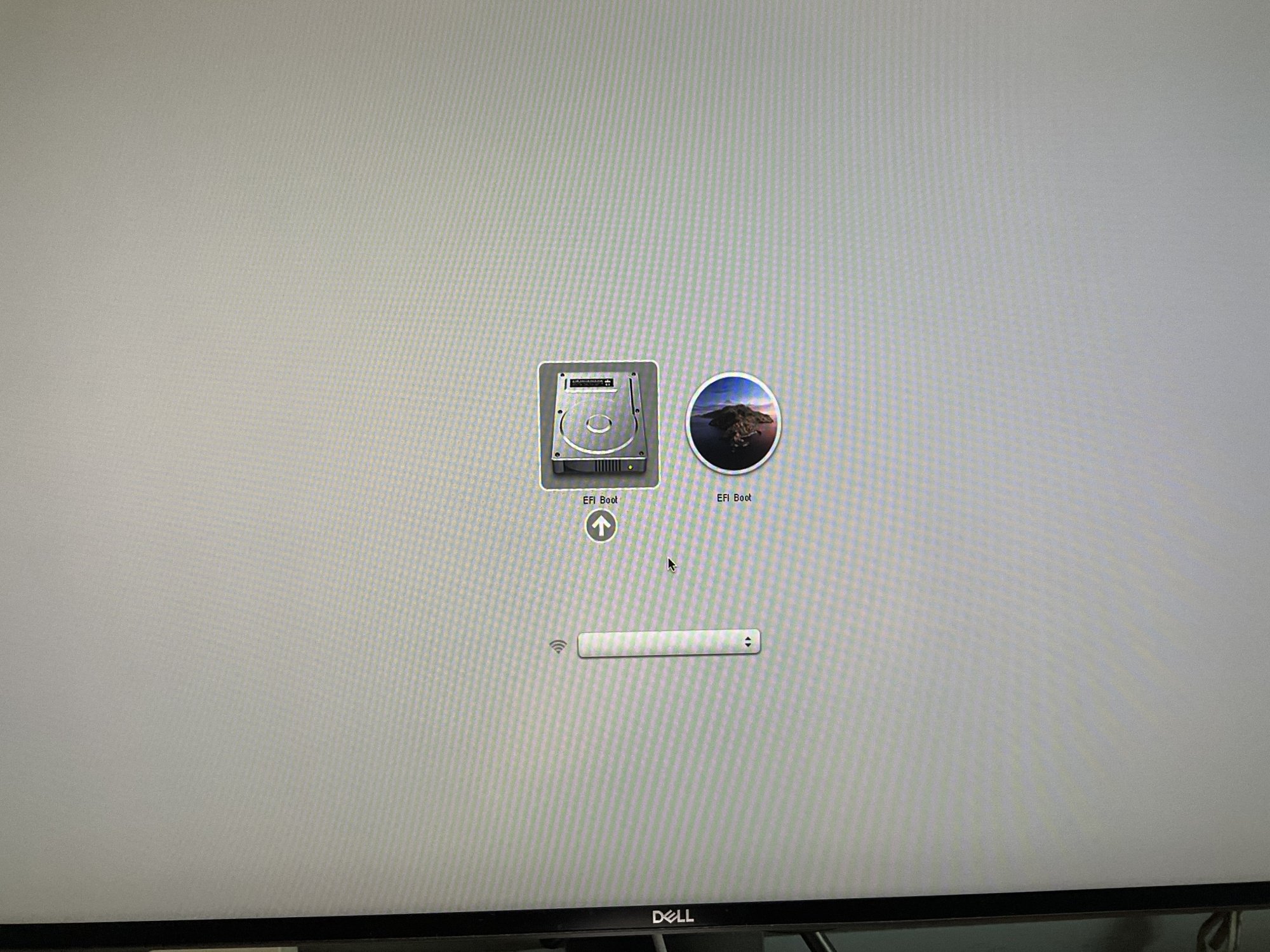

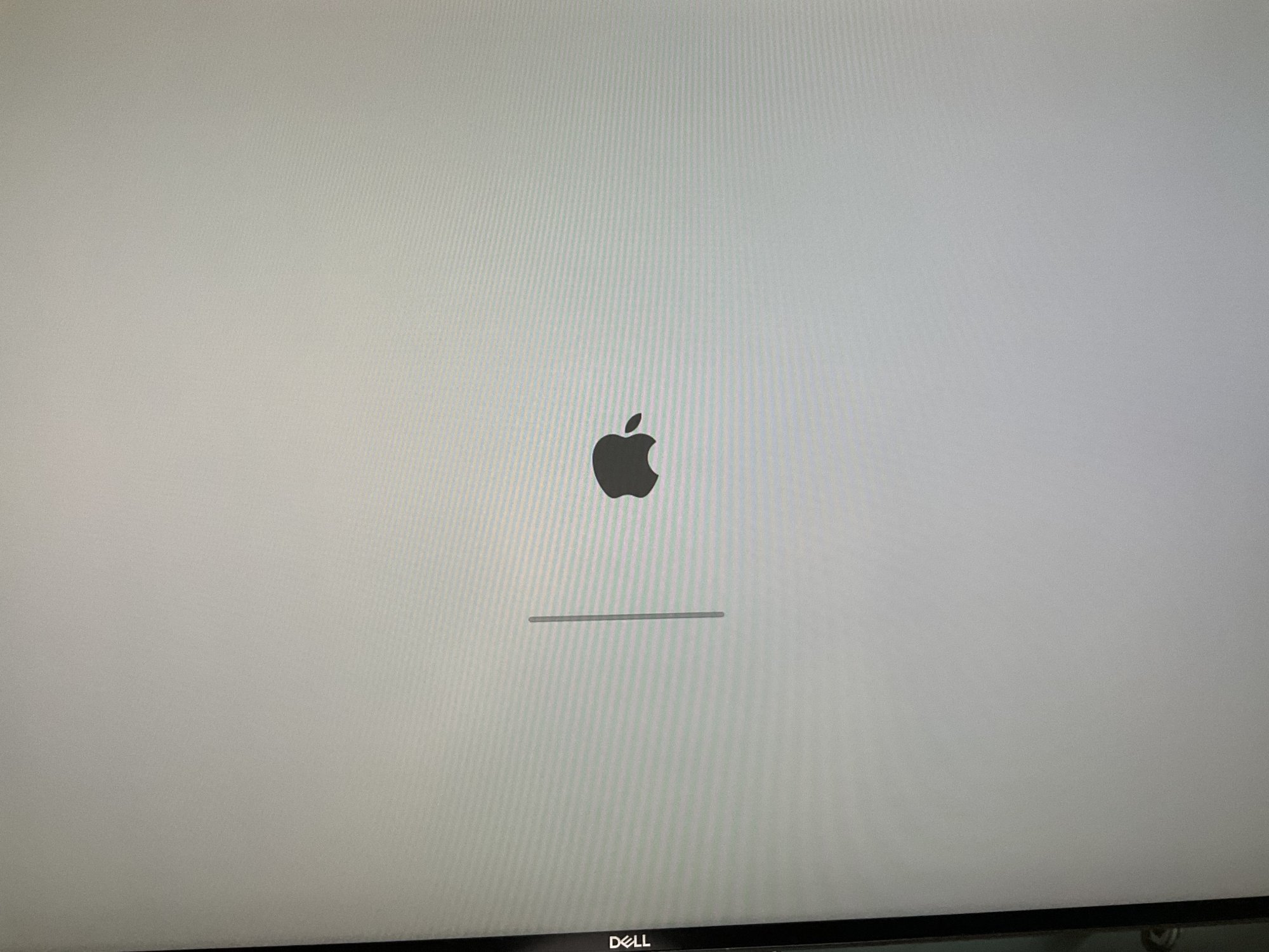

I just update patch 1.4.7 on Mac mini late 2009 and now It stuck on Apple logo without any process bar movement. What should I do?
Edit: I try to boot from USB bootable drive, I press option to choose the drive to boot as shown on the first photo.
It run EFI boot and then stuck at Apple screen, USB drive flashing for a while and then nothing happen at all.
It might be the end of this Mac mini 3.1, I create the boot drive with new patch and try to install via USB - Same symptom again.
Edit: I even try to use the old version of Catalina Patch to create the boot drive, nothing works.

I did that twice, pressed option and select the USB boot drive - it stuck at Apple logo without any progress for at least an hour. Also, I recreate boot drive on my 2018 MacBook Pro with Monterey using Catalina Patcher which download Catalina from Apple Website. It stucked on Apple Logo at the same spot. Even go far to downgrade Catalina patcher to 14.4 and recreate Boot drive, nothing change.
Before update patch 14.7, everything works fine for me. Never open music app at all. Just browsing web and download BitTorrent.
BTW, the USB drive show as EFI boot. Is that ok?
It should show up named as "macOS Base System". Try a different USB drive, that'll probably help.
