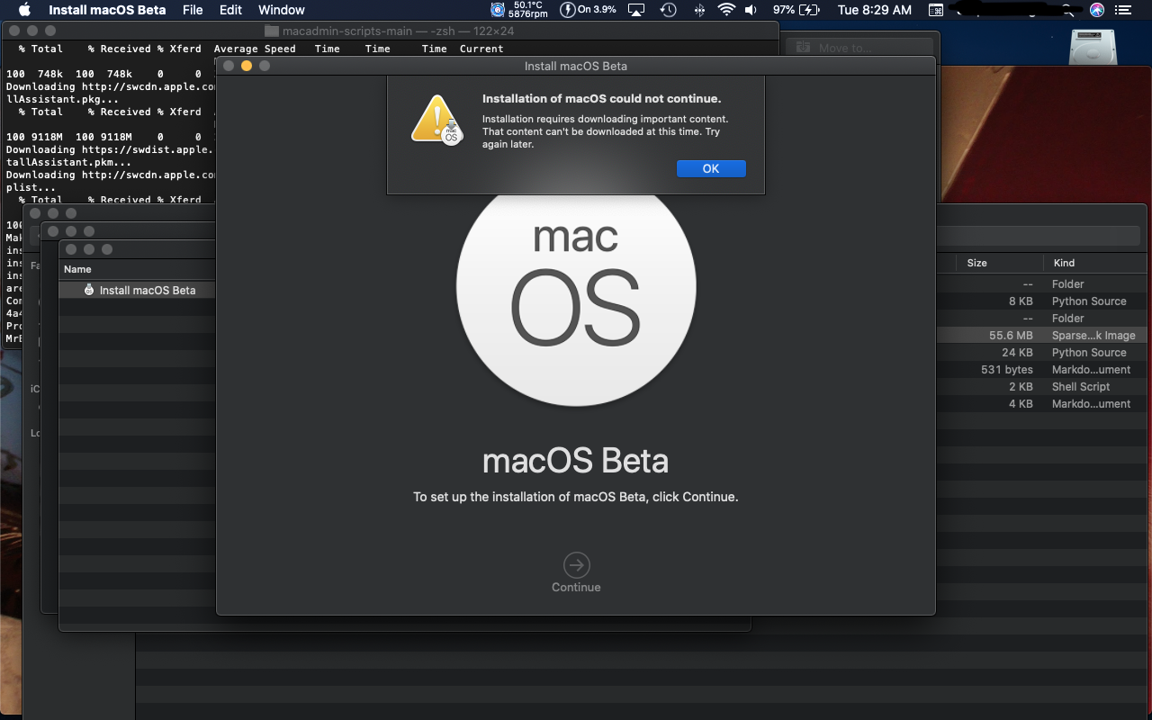

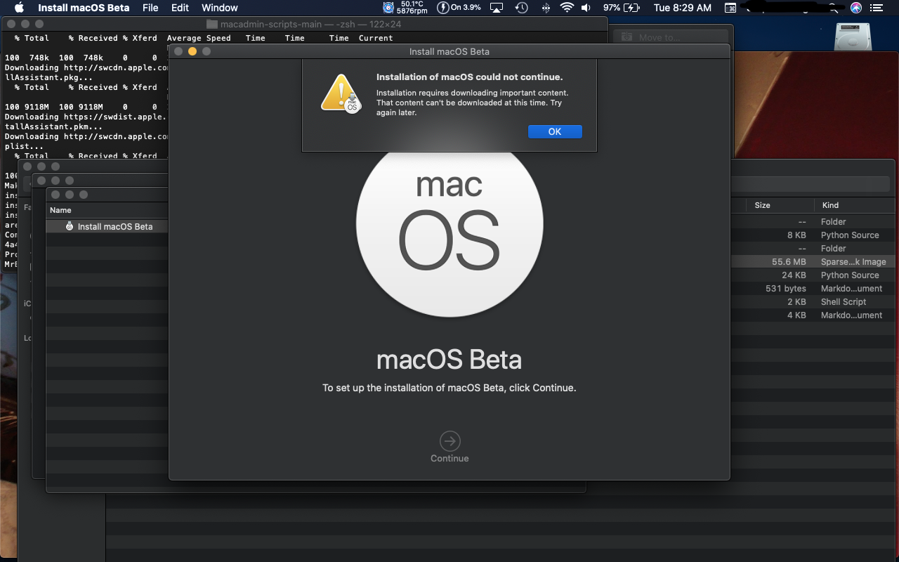

i hit a huge speed bump
[automerge]1592915557[/automerge]
ok, I haven't been in my hacking days since Maemo... not sure if you guys know about that dinosaur😁. but i just downloaded a python script from here: https://github.com/munki/macadmin-scripts and I'm going to attempt something.
i will keep you guys up to date with my findings. if I'm headed in the wrong direction LMK🤞🏾
Reactions: TimothyR734

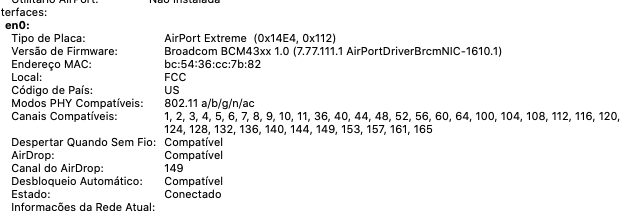

Great finding!
I've upgraded my rMBP 15 mid-2012 wifi card years ago due to the lack of AC compatibility. It's a cheap and easy upgrade that is totally worth it.
Hope that's why the first generation of rMBP were put off the table. Because it sure has the necessary horse power to work with Big Sur.
