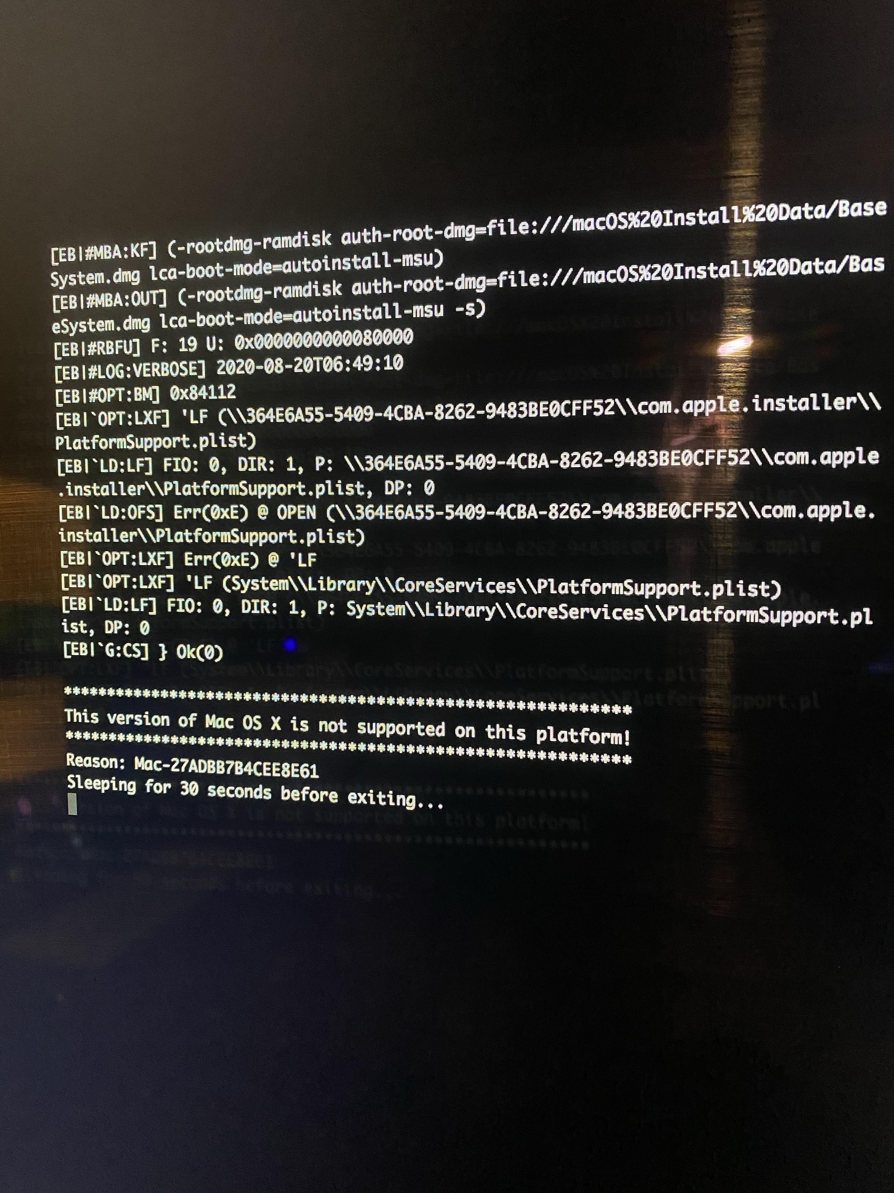

Install of dev beta 5 with 0.1.0 micropatcher gives nvram boot arg errors for data not found in the terminal.
Script gives okay for install however.
After 13 minutes of install, iMac late 2013 shuts down, no reboot. Gives NO OS symbol.
Go back to USB via normal boot & single user boot to "nvram boot-args=-no_compat_check" which gets set with no errors.
Reboot again. Same NO symbol. Booting to single user from disk for verbose boot gives the above output in the photo.
Maybe Apple working on blocking us in plist?

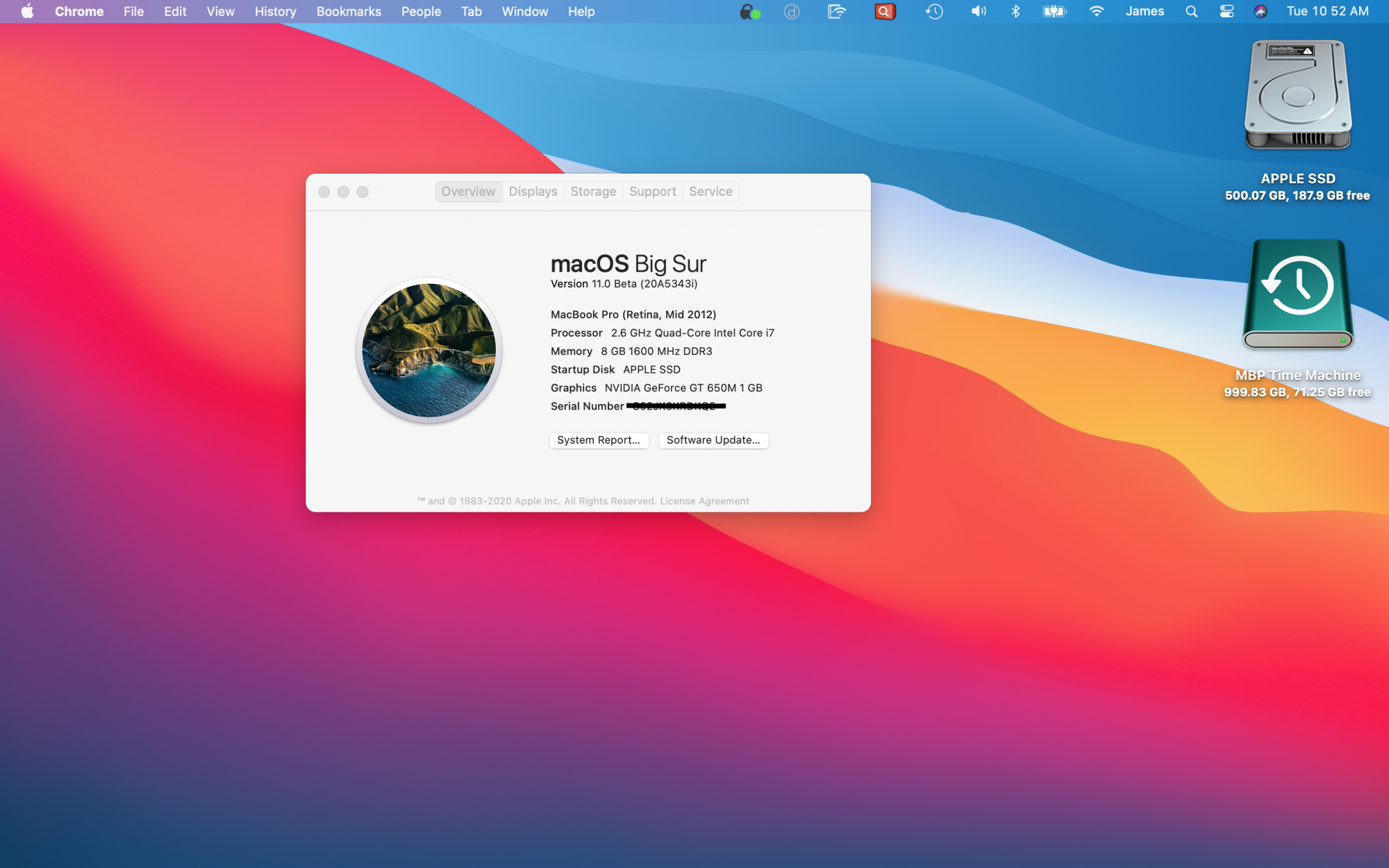

MBP 2012 13", micro patcher 0.1.0 - Installation went without any issues. 20A5354i incl. Wifi is up and running after booting up from USB again and applying patch-kexts.sh.
In this case this time I got an BIerrordomain error2 instead of error3. (FYI)
Seemingly this installer looks for 30GB free space on the disk. I could not proceed with the installation, until Time Machine snapshots were deleted manually (to make space obviously). Installer reported 22GB free space but internal ssd become not available until then.
Cheers!

That's useful to know. (I didn't realize before that the disk space error could show up as BIerrordomain error2.)
That reminds me, for anyone who's doing an upgrade from a pre-Catalina release of macOS, upgrading to Catalina first then upgrading from Catalina to Big Sur requires much less disk space than upgrading directly to Big Sur. (A fresh install is going to require less space than any kind of upgrade, of course.)

As far as I can see the only step difference in what you have suggested is that the micropatcher folder with it contents be placed on the desktop
How and why will that make a difference ???
Why don't you switch to verbose mode you may get some clue there?
