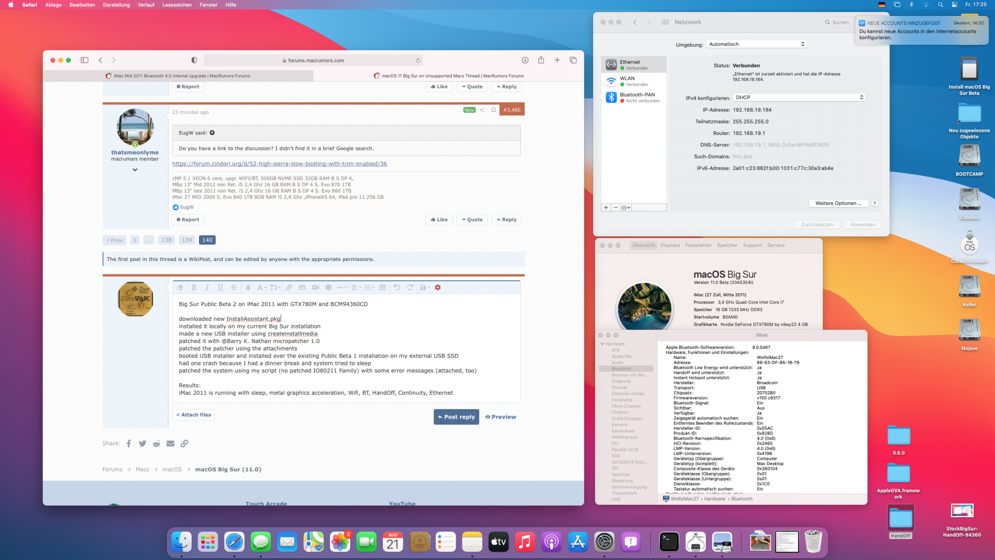

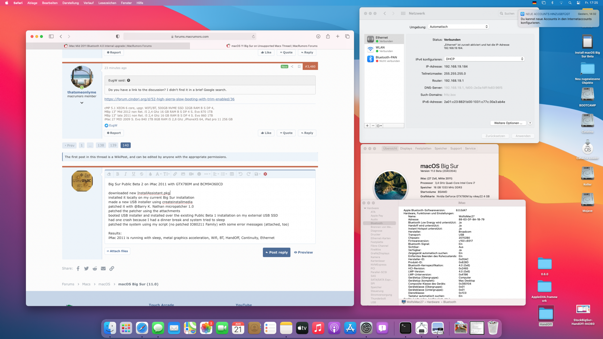

Big Sur Public Beta 2
iMac 2011 with Nvidia GTX780M and BCM94360CD
  1. downloaded new InstallAssistant.pkg
  2. installed it locally on my current Big Sur Public Beta 1 installation
  3. made a new USB installer using createinstallmedia
  4. patched it with @Barry K. Nathan micropatcher 0.1.00
  5. patched the patcher using the attachments, put the iMac2011Family-highvoltage12v.zip into the kexts folder on the USB installer and use the patch-kexts-iMac-2011.sh instead of the stock patch-kexts.sh to patch the installed system after successful first boot (basically follow micro patcher instructions to install Big Sur)
  6. booted USB installer and installed over the existing Public Beta 1 installation on my external USB SSD
  7. had one crash because I had a dinner break and system tried to sleep (possibly because the setting where inherited from the former installation, had this not with the very first one)
  8. patched the system using my script (no patched IO80211 Family) with some error messages (attached, too)
This patch-kexts-iMac-2011.sh scripts runs only from the booted system. It needs some system tools to find out the GPU type. There are two new command line options, --2011-iMac and --2011-iMac-no-wifi for the people already modded their iMac with an ac compatible wifi card (94360x family). Not the most elaborated piece of code :)
Results:
iMac 2011 is running Big Sur with sleep, metal graphics acceleration, Wifi, BT, HandOff, Continuity, Ethernet like the iMac 2013 models, I would assume.

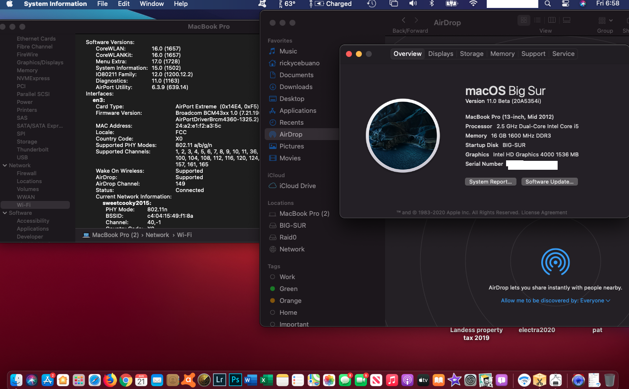

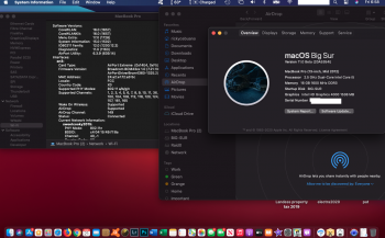

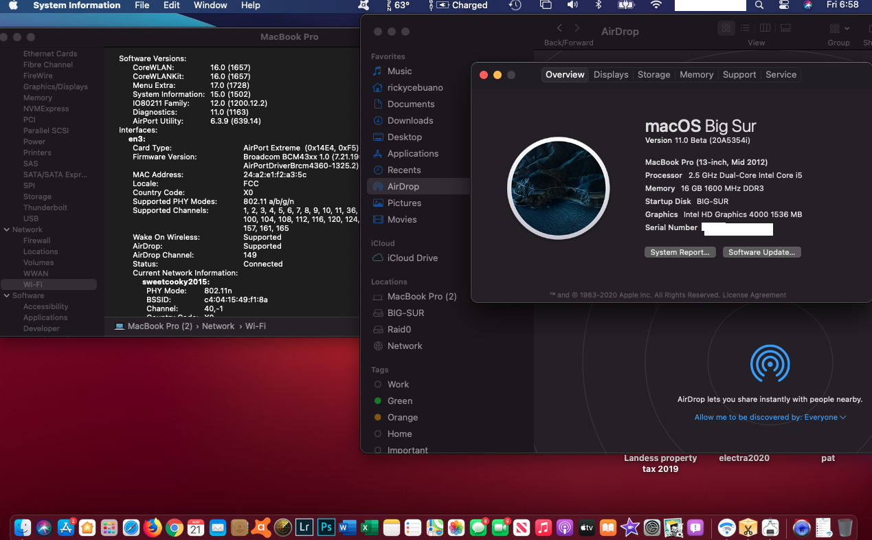

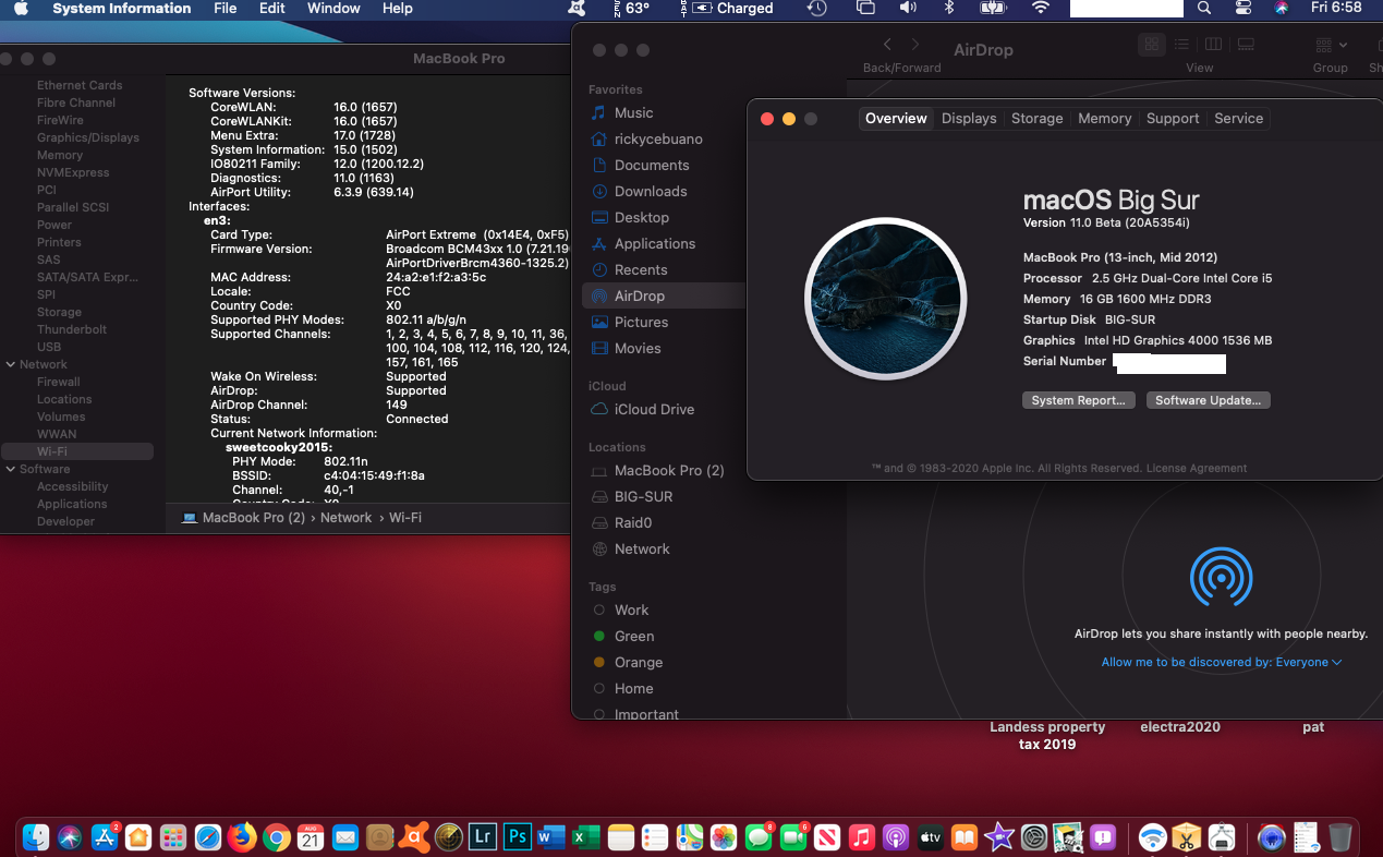

The most easy way would be to check the zip file I attached. Basically we are using the HD3000 @Barry K. Nathan already added, with Catalina we needed some more, with Big Sur other extensions. You may check the link in my signature and search the first post for "sleep" - you will find the post @highvoltage12v made. I am just using what he has collected. @dosdude1 unfortunately never added real iMac 2011 support to his patcher (although the HD3000 were included in all patcher versions, too). The best we got was not installing the legacy video patch by default - which we did and do not want with a metal enabled graphics card.
Using Micropatcher Barry K. Nathan 0.1.0 BS DP5 on MBP 2012 13"
Airdrop is missing
What wrong?
Is anybody success fix this ?
Reactions: TimothyR734
