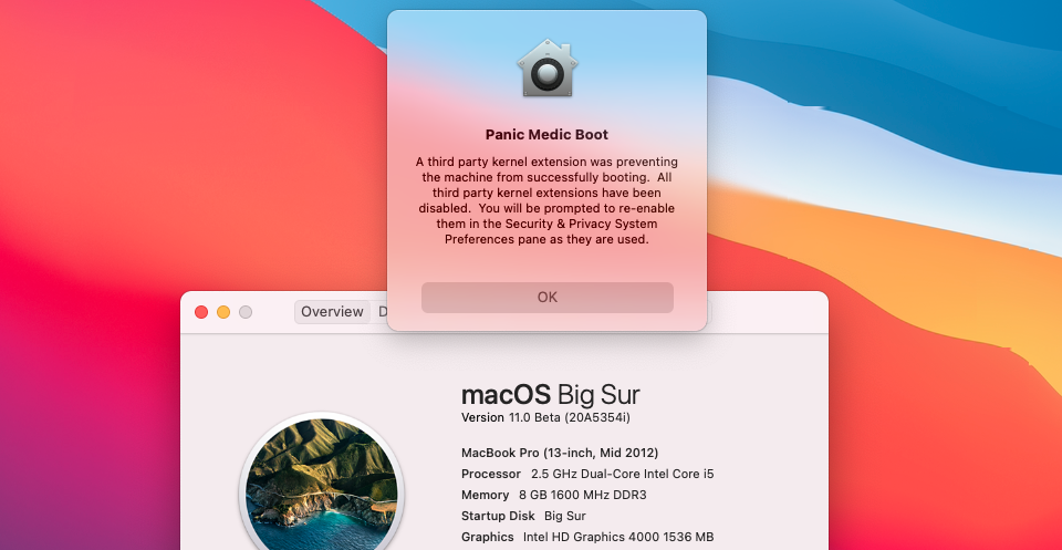

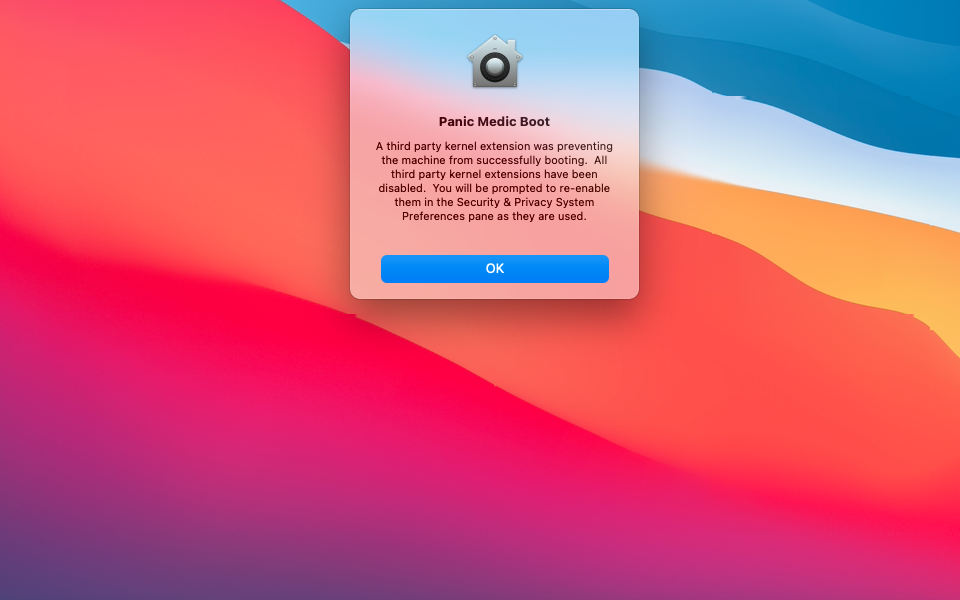

successfully installed Dp5 but unable to make wifi working with old patch and it is giving random restart and this message after open

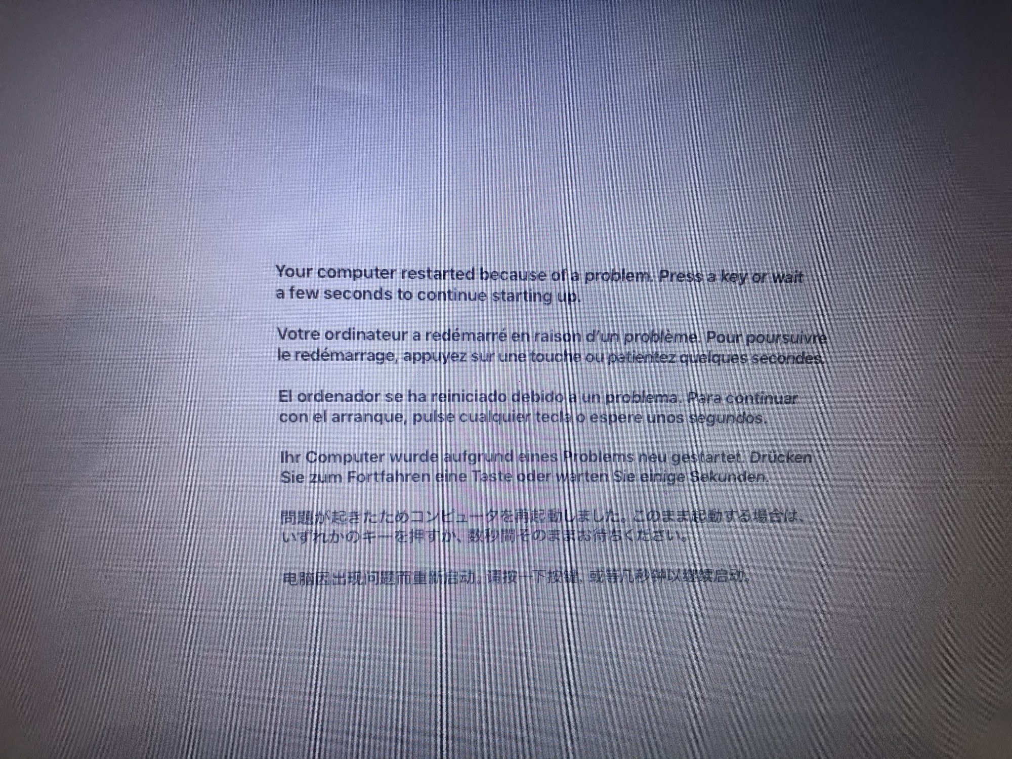

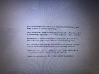

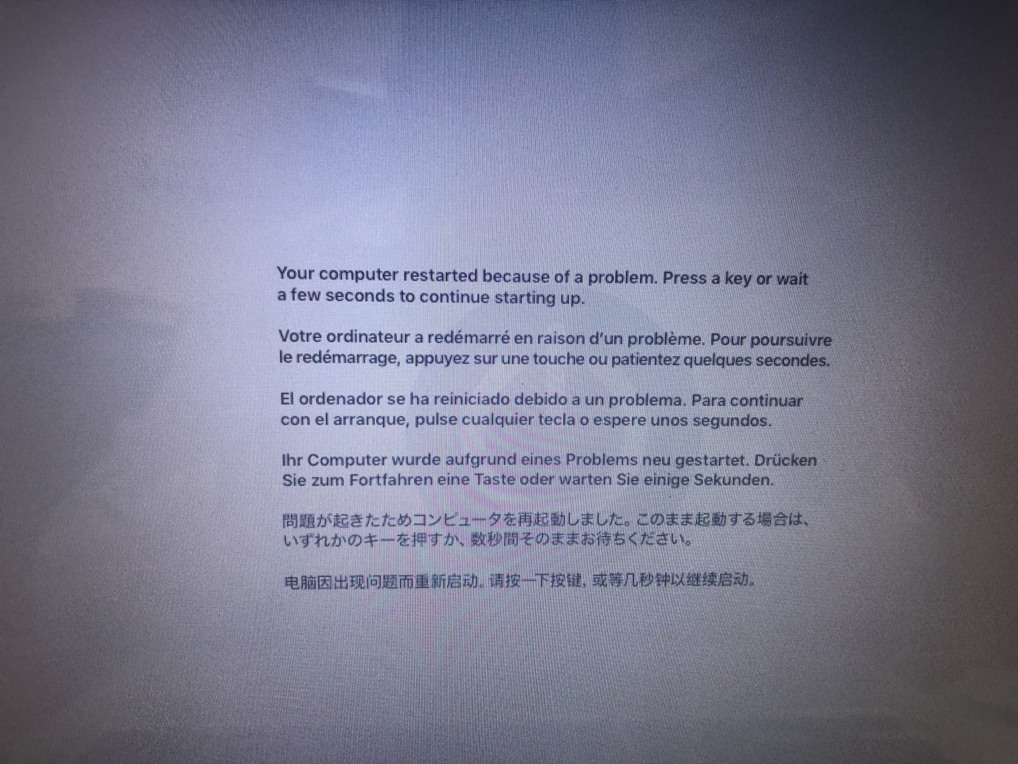

update , system failed to boot from Big Sur Partition Dp 5 , several time system restarted
