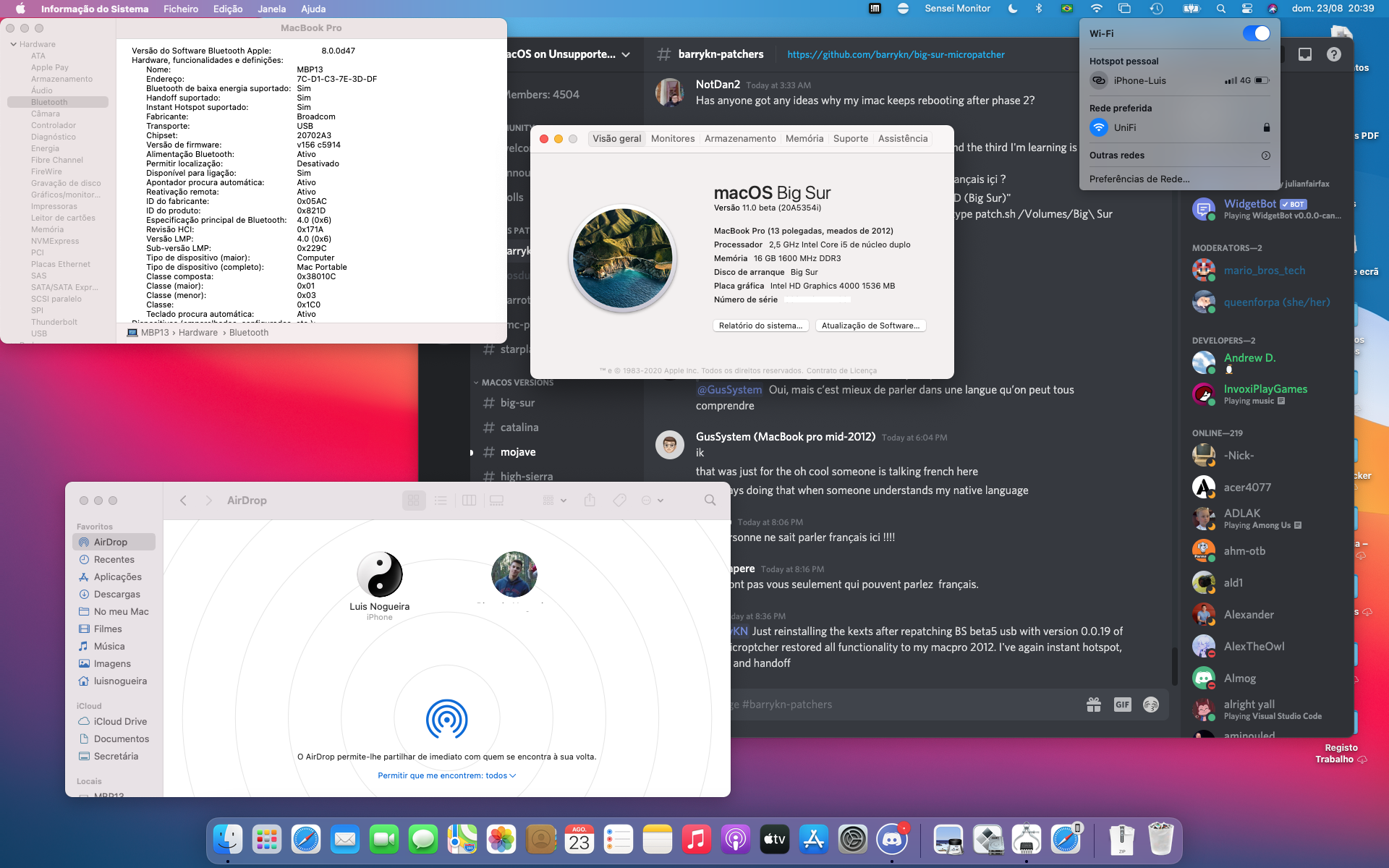

I ran the unpatch.sh in 0.0.19 using the usb installer I already had with 0.1.0 after that I repatched it with micropatcher.sh, rebooted to the usb installer, ran the setvar script and then the kext script without rebooting between them. Reboot and, hopefully, all will be working

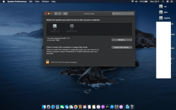

If you want a working airdrop and handoff there is no other way to fall back to PB1 and then following the above steps. I left my MBP on DP4 for this reason. My late 2011 went back to catalina for there I had the possibility to get CAT working with the result to have working airdrop.
OK. No Problem to re install DP 4...

YES It'S WORK !!!
Briliant
TQ Bro

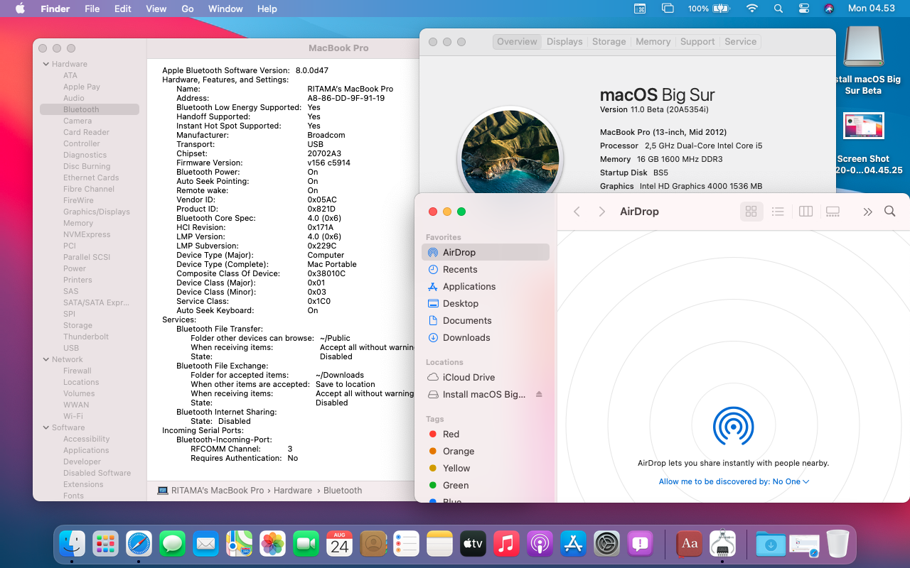

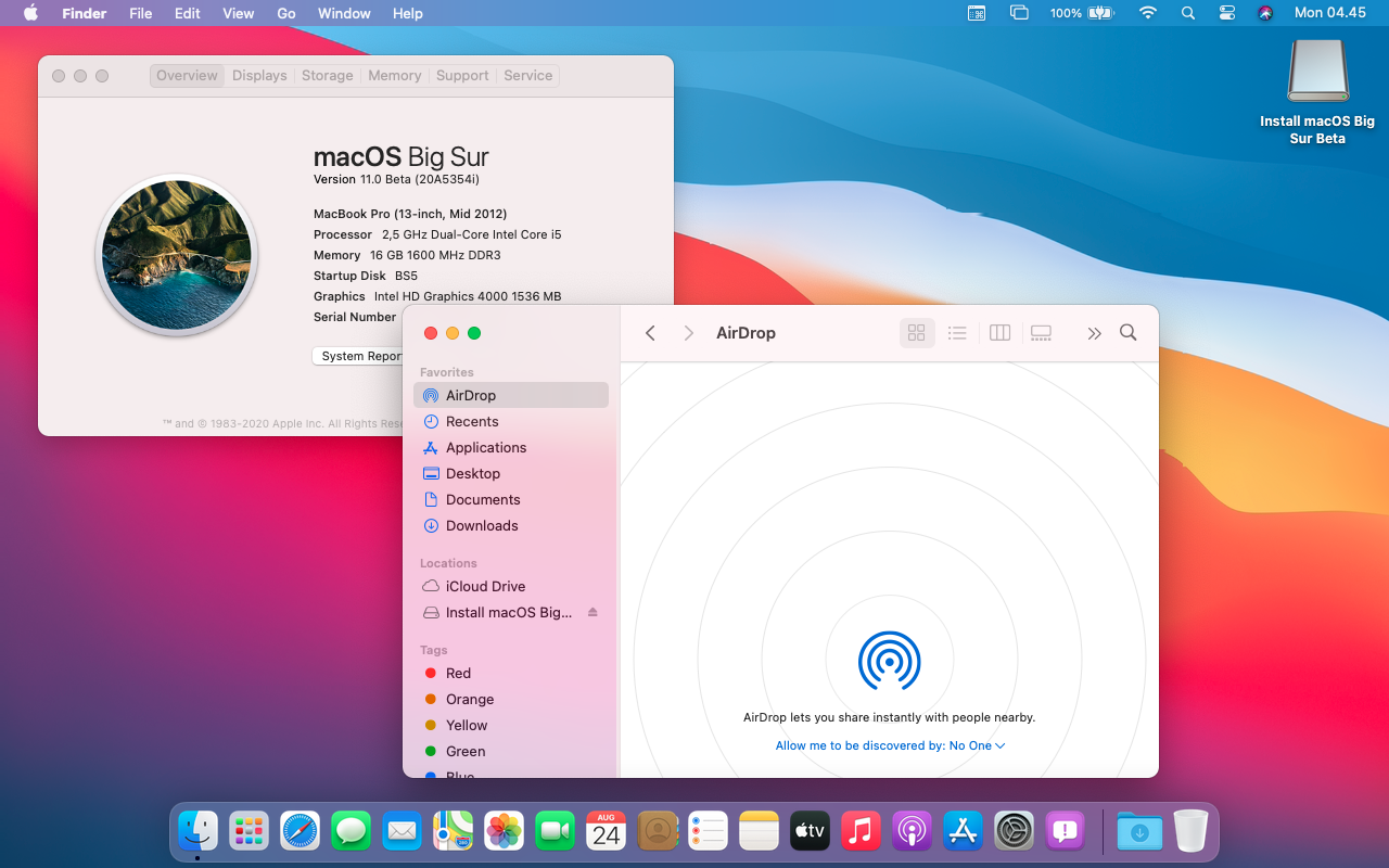

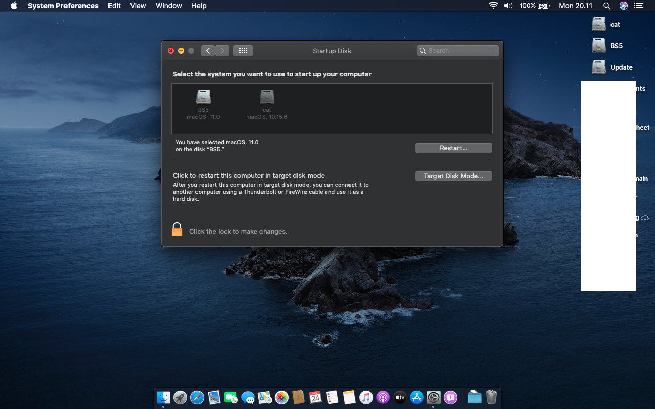

Big Sur PB 2 MBP 2012 13" Work Ok
BS dual Boot Catalina MD101

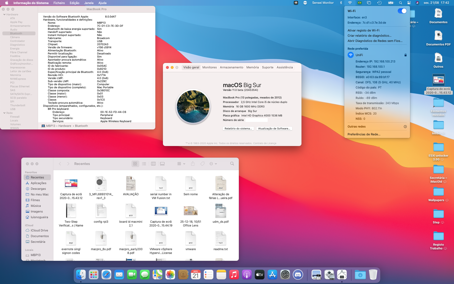

THX --> working now especially Handoff now working in both directions.

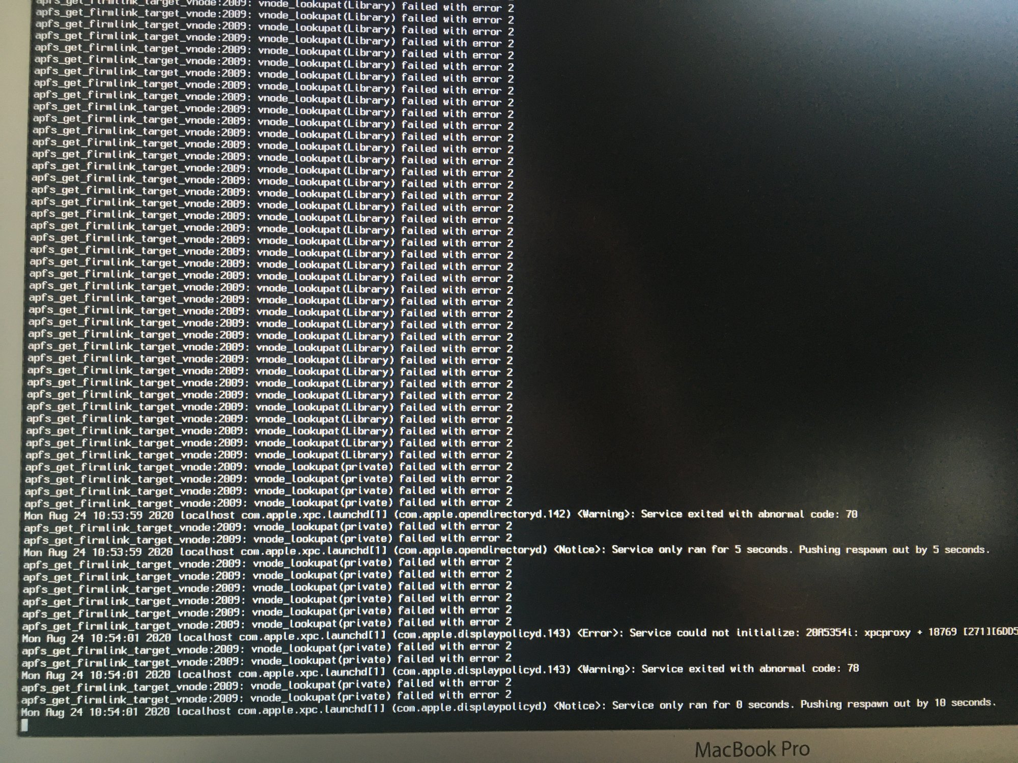

On MBP5,2, PB2/DP5 (version 16.0.16).

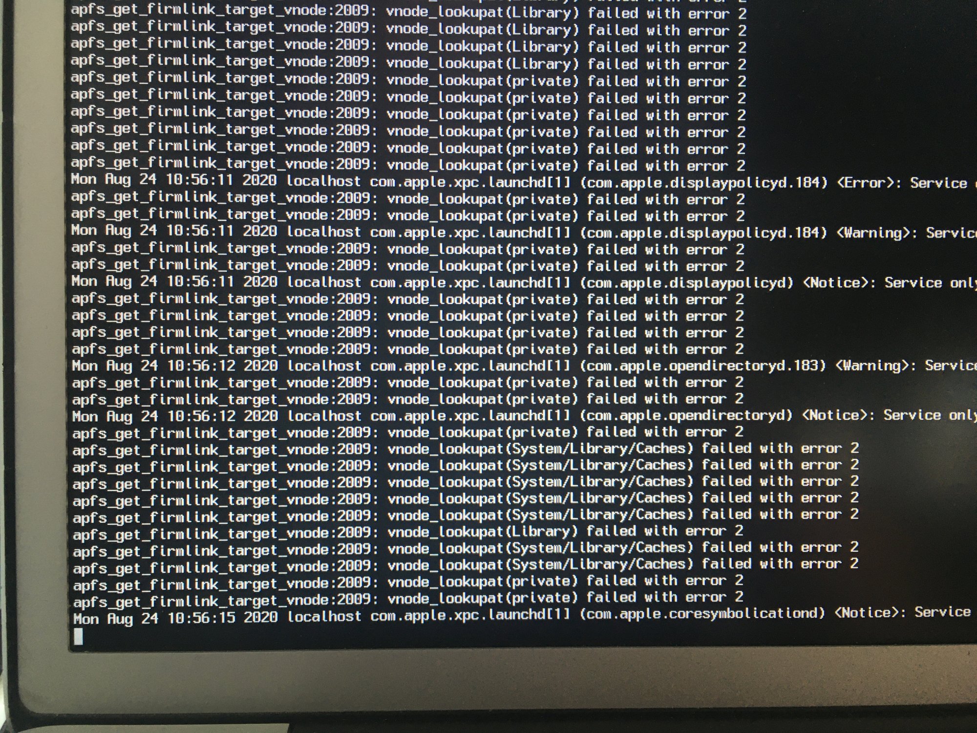

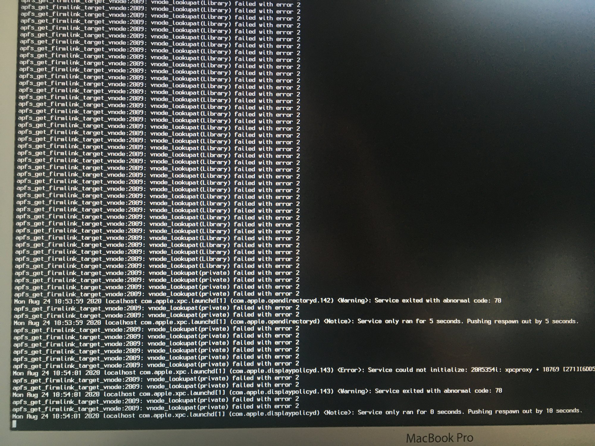

I followed the same procedure to produce the USB BS installer, and to install to a freshly erased SSD on SATA. The disk is now on USB.

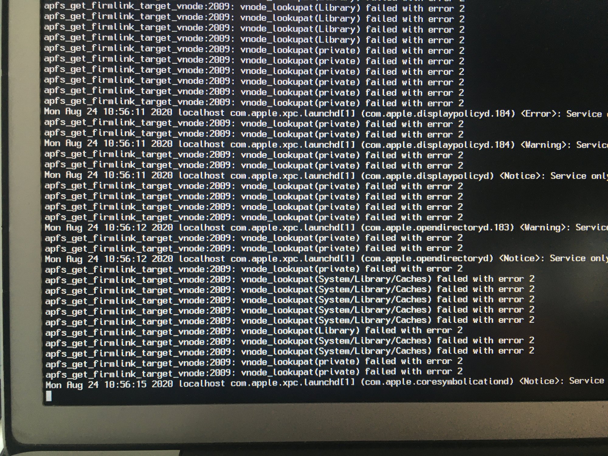

Same result as iMac-Oldschool saw for booting: it will hang at the end of the progess bar, with OpenCore (from USBOpenCoreAPFSloader4) or with the Apple boot selector. I only report here for a small piece of diagnostic:
When booting with CMDS+S into single-user mode and then typing exit, the hang manifests itself as shown in the attached photos. Looping on apfs_get_firmlink_target_vnode:2009: vnode_lookupat(xxx) failed with error 2 where xxx regards private, Library, or System/Library/Caches.
On a different SSD, I have DP4 running fine. USB BS installer for that prepared with the previous BigSur BaseSystem legacy usb fix.zip. (EDIT: it is not PB1, but DP4 (build 20A5343i) on that disk - should make no difference.)

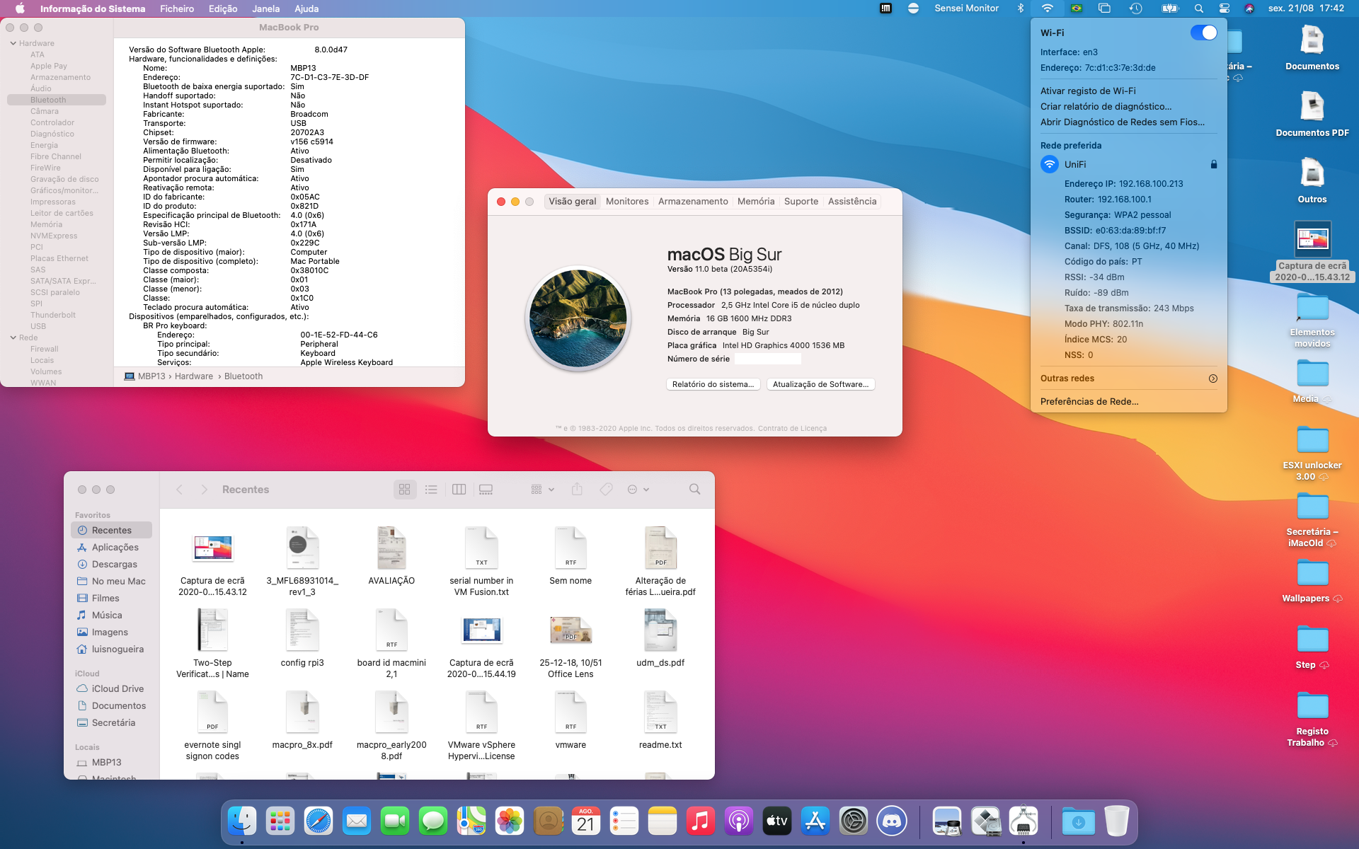

LuisN thank you for the idea! Did just that and worked. The only snagg was that I tryed after unpatching and repatching, to run the vars.sh and then the kexts.sh but the second did not take! Told me it can't find my volume! So I rebooted and ran the kexts.sh from the terminal in the OS. Worked! Rebooted and it worked! So thank you very, very much!
