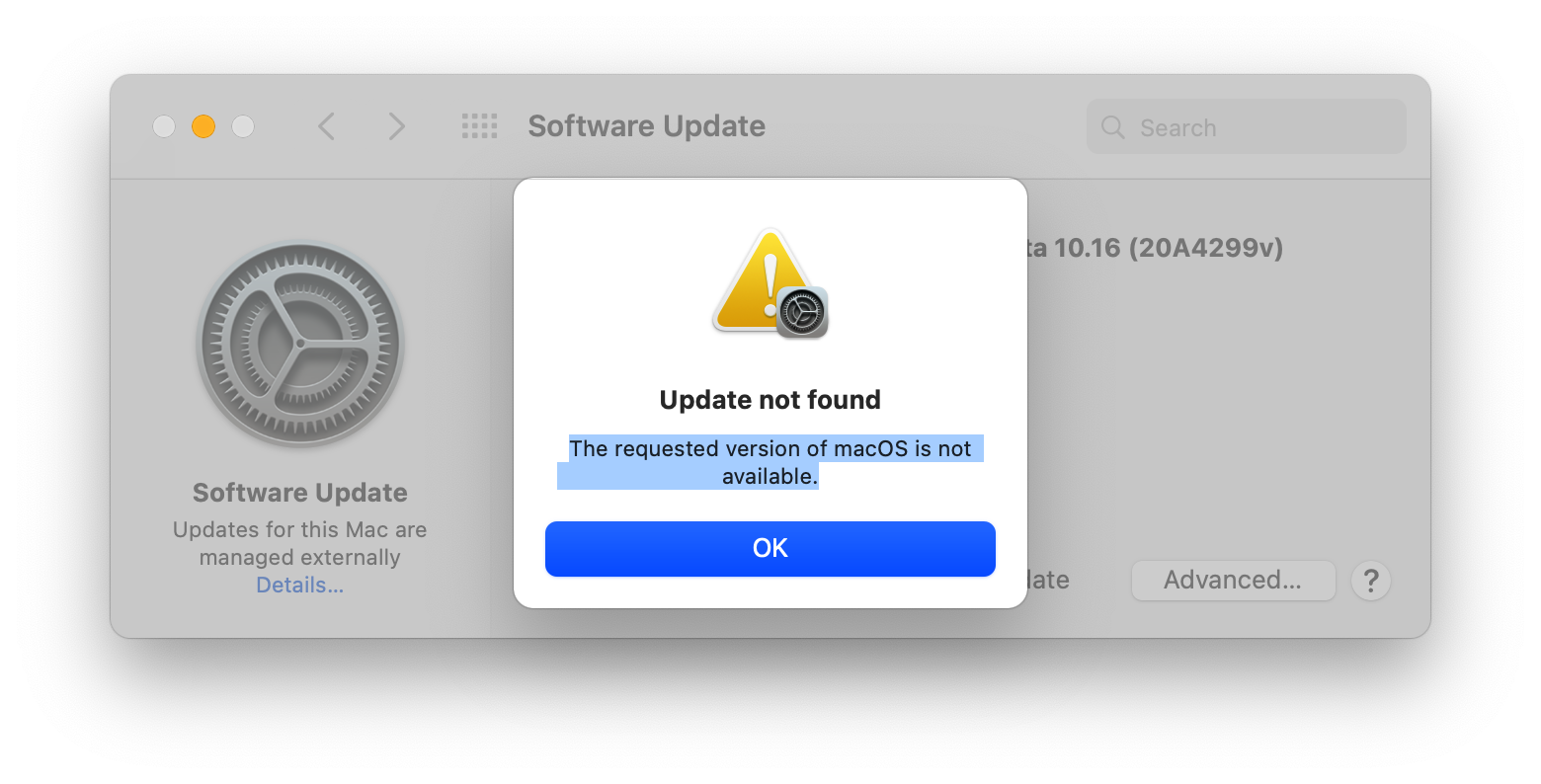

Tried your method booting from a Mojave system backup partition. Same, no Big Sur updates have been offered, "Software Update" reported that my cMP 5.1 has the latest release installed.

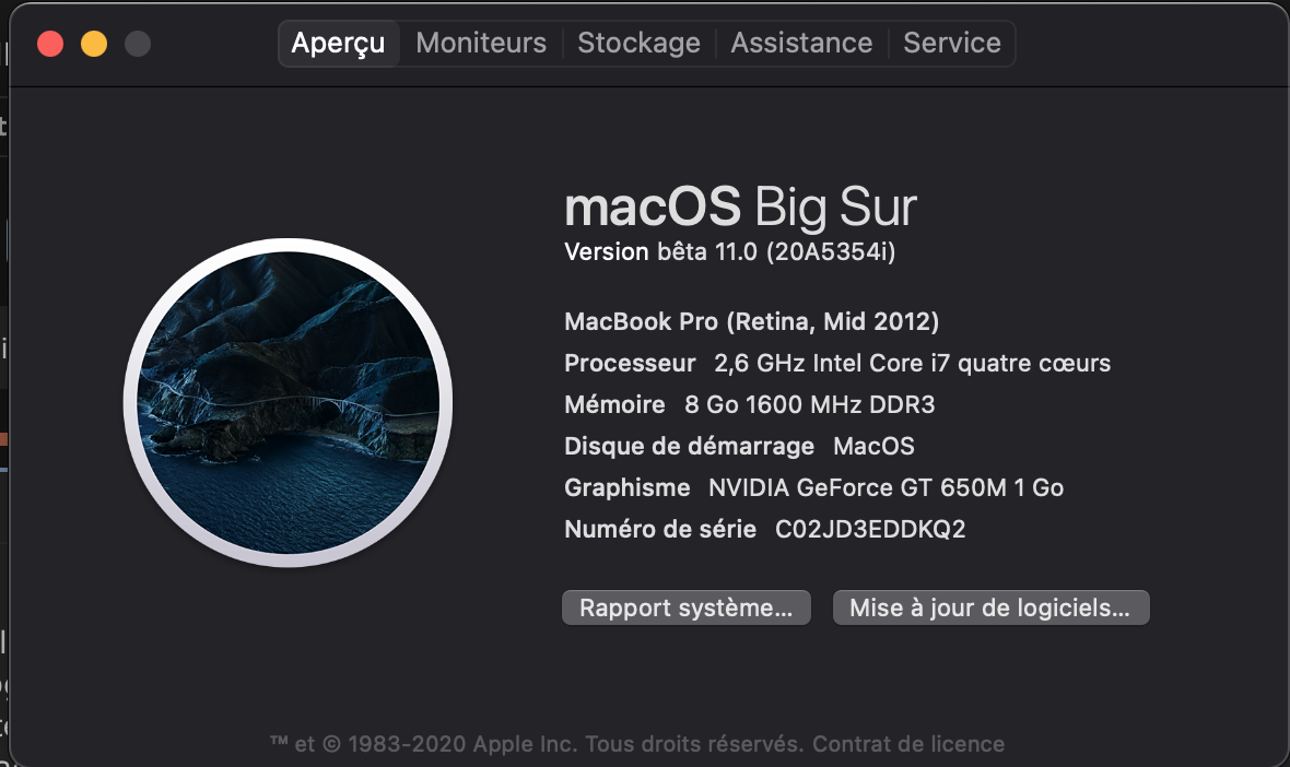

I installed PB1 on MBP mid-2012 when it came out (and followed this forum), and all was working fine that I could see.
Just upgraded to macOS Big Sur 11 beta 5 (20A5354i), Wifi not working at first reboot.
Restarted on USB and reran the kext Patcher and now it is working again (posting from it actually )

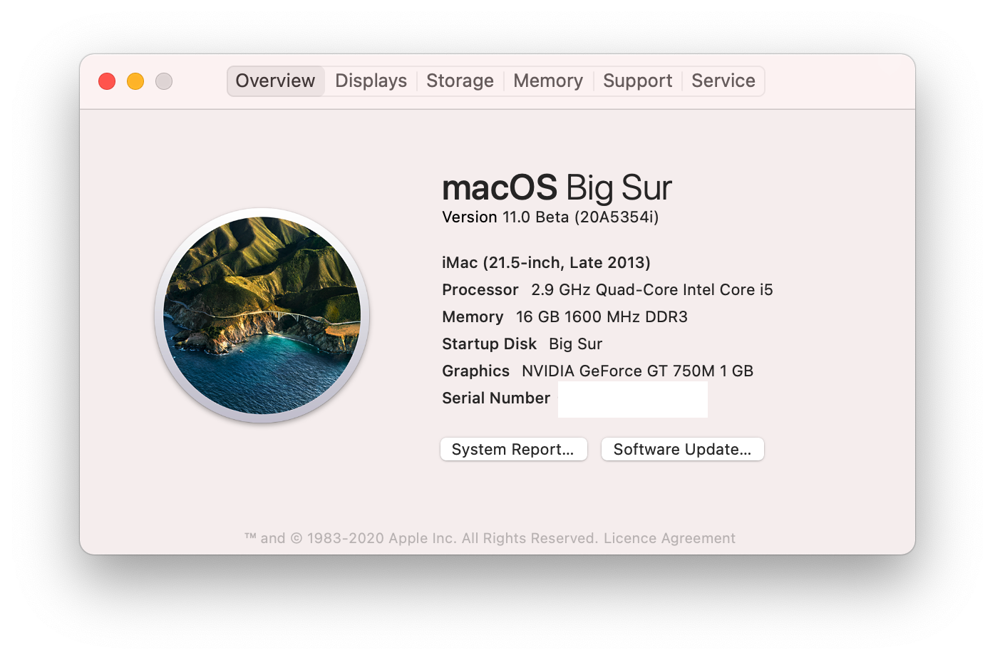

It worked! Late 2013 iMac updated to Beta 5. No problems with Airdrop etc.

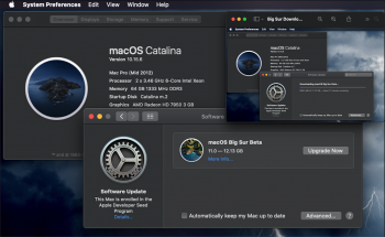

The Big Sur Beta update is showing on my cMP mid 2012 5,1 during updating the Catalina 10.15.6.
The Big Sur Beta (20A5354i) 12.13 GB.

I don't have any problem to update at all with Barry micropatcher v 0.0.20 on my cMP. See my post #3426 of my cMP hardware listed.
