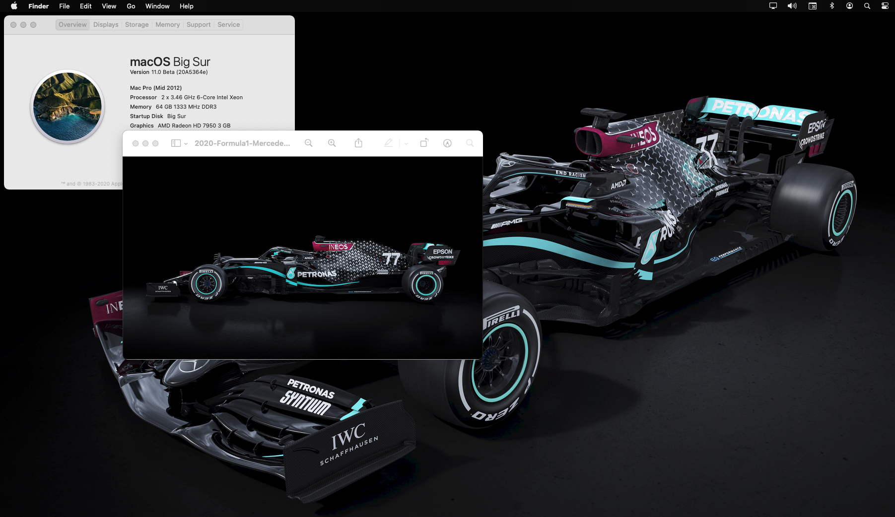

cMP mid 2012 5,1 successfully updated Big Sur Beta 6 with Barry-micropatchers V0.1.1.

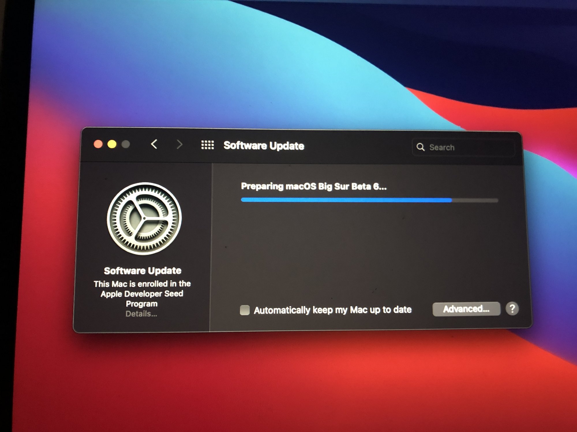

Has any tried to update beta 5 to beta 6? Mine is kind stuck at preparing mac is beta 6. I think I just might leave it alone and see how long it takes

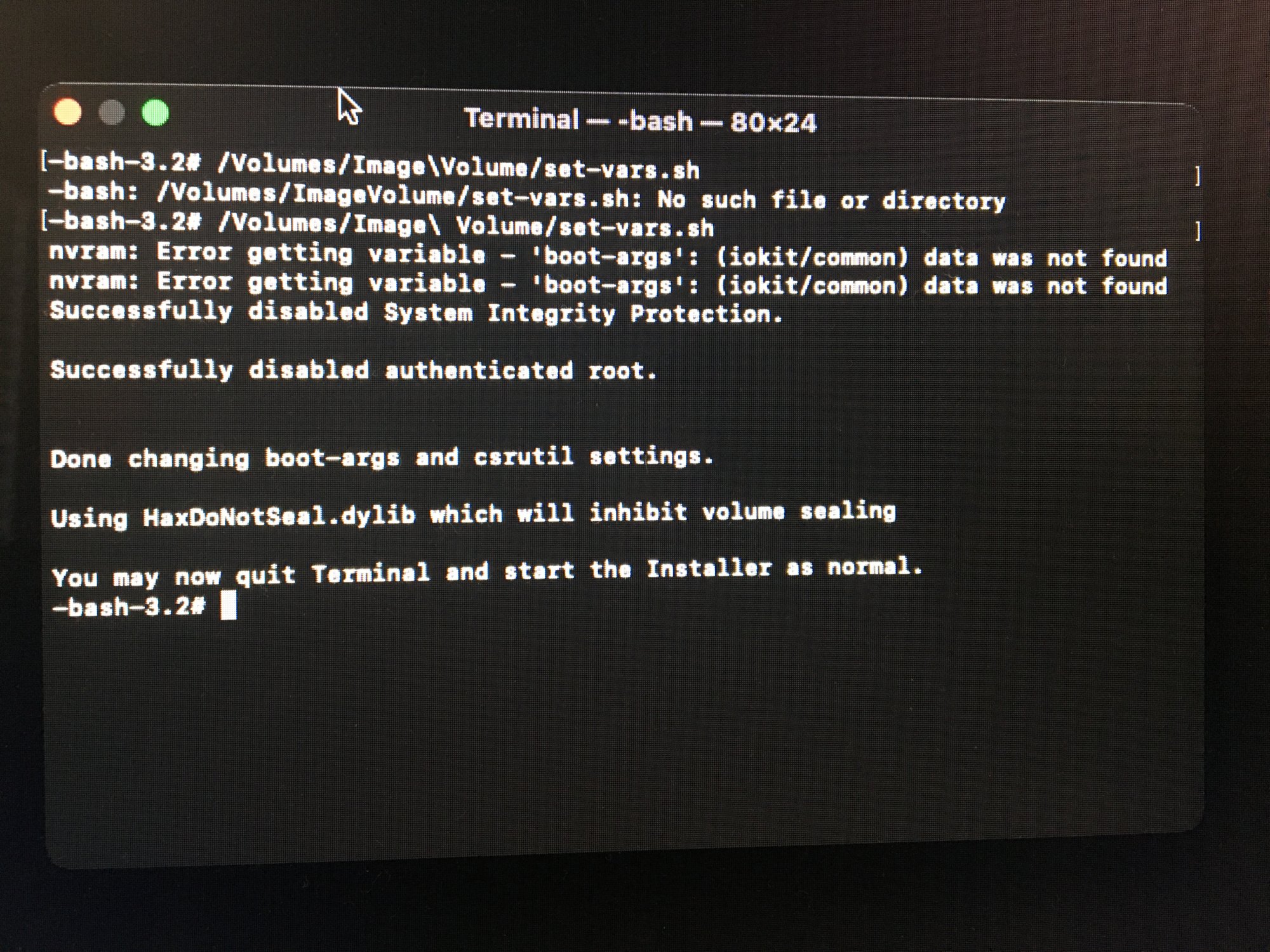

I have iMac late 2013 Need help on these trying to install they always got stuck on 12minutes with forbidden sign then I did notice after resetting Nvram on the terminal said boot-args data not found please see picture attach. Thank you in advance
You may have to follow Barry's instructions will help.
