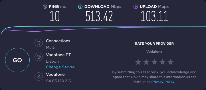

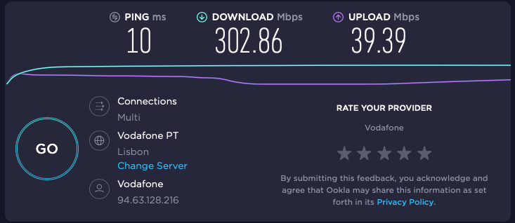

@Maclinux:
Same machine 500/100 ISP speed
WIFI:
WIRED:
