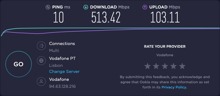

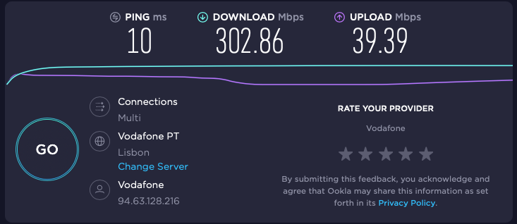

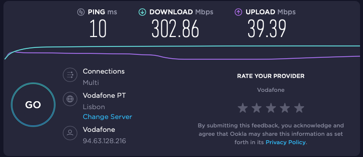

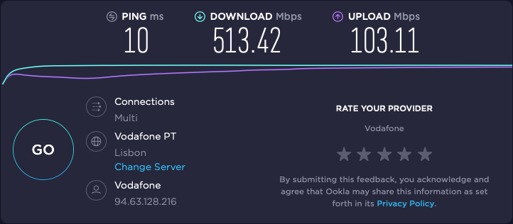

@Maclinux:
Same machine 500/100 ISP speed
WIFI:
WIRED:
Attached are two screenshots showing speed from my ISP under Mojave and Big Sur. No discernible difference in the performance. Unfortunately, these are from a 100/20 connection, not 500/100. Be interesting to see from other users if Big Sur has problems with faster connections. The hardware is an iMac 13,1.
I also have an iMac 8,1 in another location with an ISP offering 300/100. Upload speeds over WiFi are never better than 75-80. Problem appears to be hardware iMac hardware related. All versions of macOS are more or less the same. Over Ethernet, 300 is possible and sitting at the desk with an iPhone manages 250-275.
WIFI speeds are always lower because they are half duplex and depend on a clean wifi signal. Wifi connection in my MacBook Pro 2012 is 450 Mbps with is the maximum for a 3 antennae n card but transfer speed varies with traffic, interference and other factors. I have an iMac 7,1 with upgraded wifi ac card that connects to my router (UniFi UDM) at 1800 Mbps but but transfer speed is always far from that

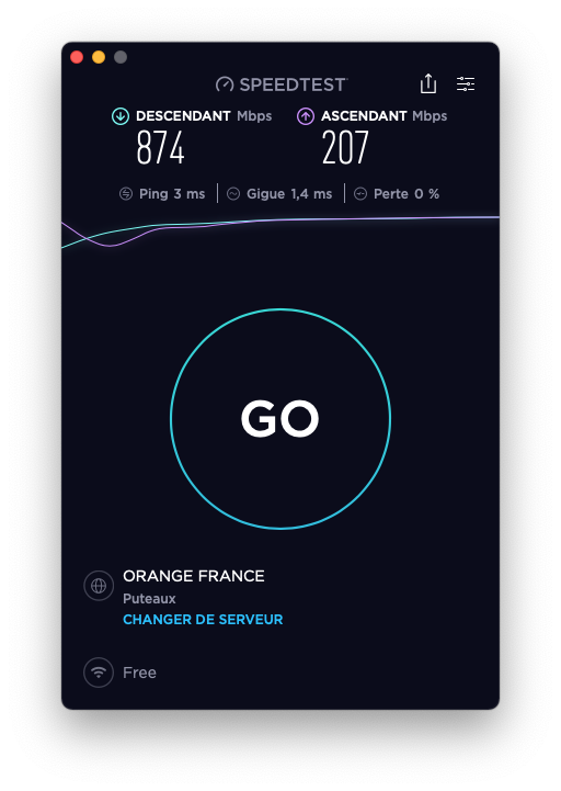

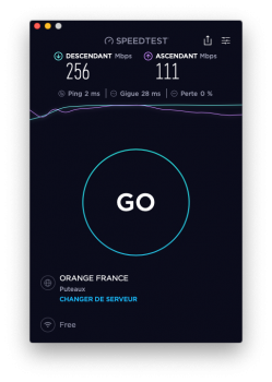

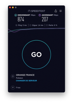

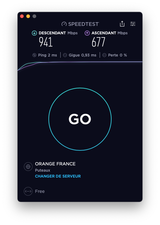

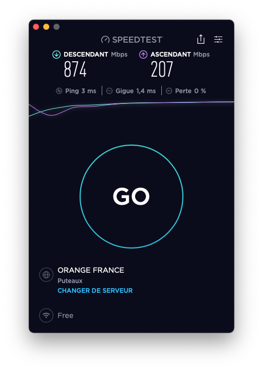

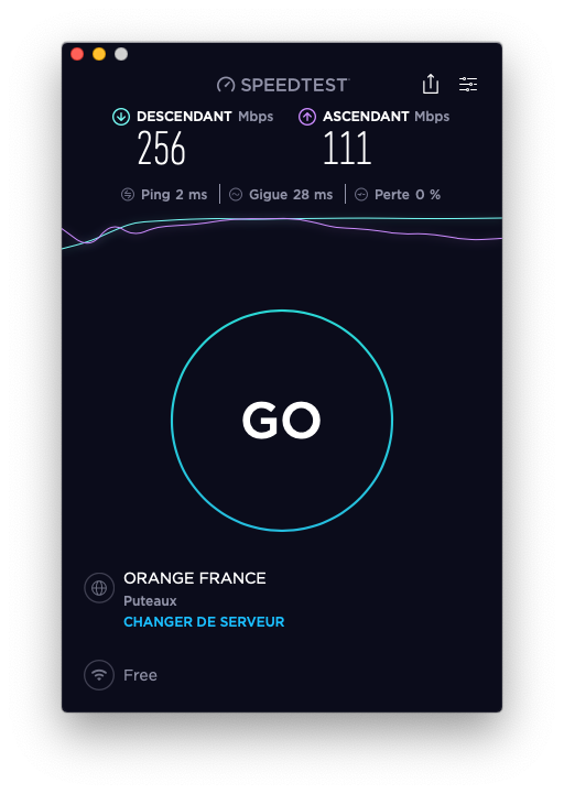

Bonjour,
I was curious and tested on my wife's iMac 2015 (supported him).
I hallucinated I didn't think there was any obvious difference with my 2011 machine under Catalina.
Capture d’écran 2020-09-12 à 11.48.35.pngCapture d’écran 2020-09-12 à 11.40.21.png
Edit: In ethernet
Reactions: Maclinux

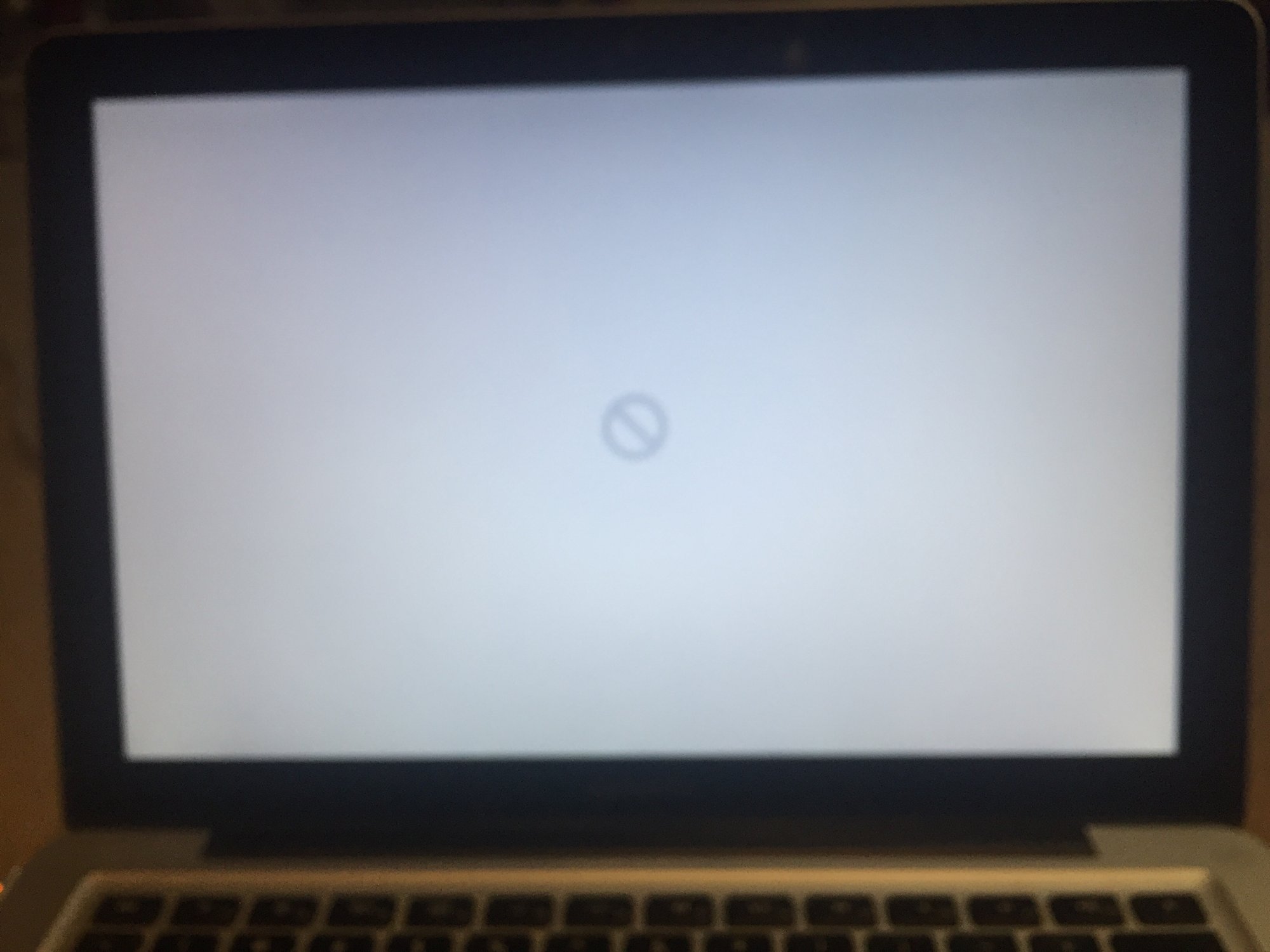

I tried to install in a MacBook pro mid 2009:
- Create usb with lasted public beta : OK
- Patch this usb with the last release of Big-Sur micropatcher: OK
- Boot with this usb: error (prohibited screen):
How resolve this???

So, you booted from the USB installer and got the prohibited sign, kinda odd, you might try unpatch it and rematch it with the latest Micropatcher.
you need to boot into recovery mode and install from there. not boot from usb.
try again.
Huh, that's not true, you have to hold the Option key when starting up, then chose the USB installer, your information is wrong.
I tried this steep before boot usb installer:
"Now you can quit terminal and restart into normal recovery mode (not the disk you just created) by holding down CMD-R the moment your Mac boots up. . Once you’re there, open Terminal (in the Utilities menu) and run: nvram boot-args=-no_compact_check."
But i dont have recovery in my catalina (unsuported mac) installation.
How do this steep?
can’t you see i said “boot into discovery mode” this of course need to press option key . Mac lover all know it.
I finally booted in recovery mode and type in a terminal:
nvram boot-args="no_compact_check amfi_get_out_of_my_way=1"
Reboot to usb installer and the result is the same, grey prohibited screen.
I may need to be:
Code:
nvram boot-args="-no_compact_check amfi_get_out_of_my_way=1"
there is a leading - (minus) sign in front of the first of the boot-args
after type in all this in terminal just go back to recovery mode and go OS install. no need reboot to usb installer.

Bonjour,
View attachment 952178View attachment 952179
Edit: In ethernet
One is wifi n and the other is ac. The number of antennae is probably 2 in your 2011 which give a theoretical maximum of 300 Mbps being a 802.11n and the iMac being a 802.11ac card with 3 antennae can reach, depending on the AP 800, 1200, 1800,... Mbps. Even using n protocol the ac card can connect at 450 Mbps. (150 Mbps per antenna) (theoretically )
