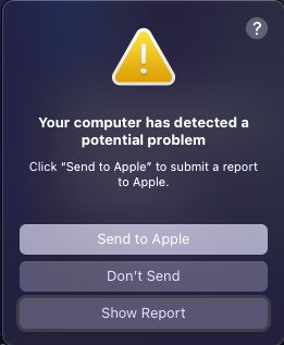

Hi,

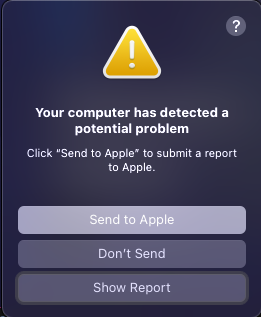

Just got my first "Your computer has detected a potential problem" and the Show Report links to eficheck.dump.
I checked my NVRAM settings on Terminal with:
nvram -p | grep "run-efi-updater"
And got this:
run-efi-updater No%00
So, perhaps it is no longer working with the combination of OpenCore 0.6.3 and Big Sur 11.1 (20C69)?
Move over to 0.6.4 immediately. I pulled all Big Sur config files from the 0.6.3 version available on the GPU thread.

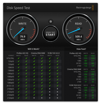

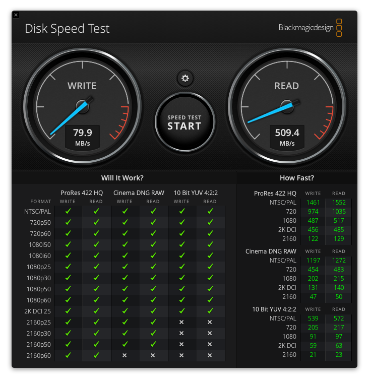

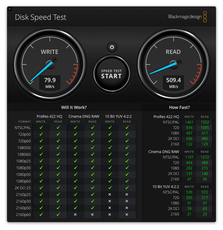

Could you do me a favor and run blackmagic speedtest for this setup?
Find bellow the print screen after running the test. It was Write 483 mb/s and read 518mb/s.

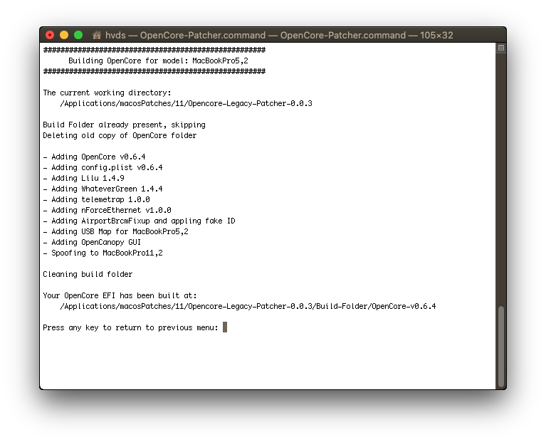

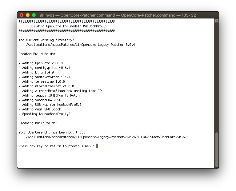

Installed 11.1 (20C69) on MBP5,2, on external USB ssd.
Refrained from OTA installation once more, but used full installer obtained via MDS.
Prepared khronokernel's USB OpenCore Legacy Patcher 0.0.3 (page 1 option 4). **
Updated existing USB BS installer made with jackluke's BigSurFixes (page 1 option 3), using the BigSurSharedSupportfix.command with 11.1 installer app in /Applications.
Then using this installer in two ways. In both cases starting stage1 from USB BS installer.
- 1st way: continuing stage2 and stage3 from USB BS installers's Utilities pulldown menu, applying Legacy USB and graphics framebuffer fixes, omitting Frameworks fix (nightshift) this time. Booting via Apple boot selector.
- 2nd way: continuing by booting macOS installer (at start of stage2) via OC-L-P and not applying patches to disk. Booting via OC-L-P.
In both cases installed over 11.1 beta2. In both cases boots fine into setup of BS 11.1.

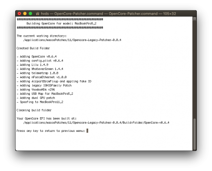

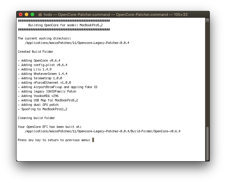

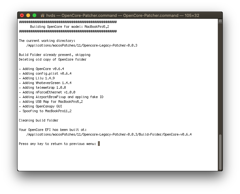

** In the OC case, I first tried version 0.0.7 but got an error message and reboot soon after starting stage2, related to SerialATAPI reconfiguration (picture). Tried again with 0.0.3 without problems.
Thanks to jackluke and khronokernel.
For OC Legacy Patcher, also tried the other versions between 0.0.3 and 0.0.7 for completeness. In summary
- 0.0.4-0.0.7 all show the SerialATAPI message a few (3-4) times and then fail
- 0.0.3 works.
When looking at the protocol of the OC build process, 0.0.4 (and higher), as compared to 0.0.3, use in addition legacy IOHIDFamily Patch, VoodoHDA v296, and dual GPU patch (and leave out OpenCanopy GUI).
This is just for reporting, if of interest to @khronokernel . I can well live with 0.0.3, thanks!
