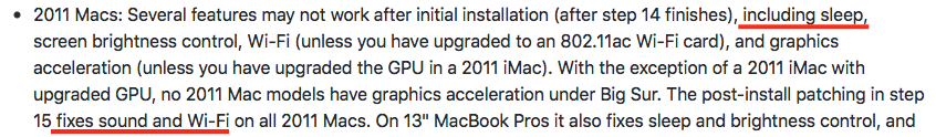

Really tired of explaining that I just added features to the original micro patcher and I did not delete all the references @Barry K. Nathan added to his own documentation (made during six month of development). This may change over time.In case I wasn't clear. I read the notes on GitHub and I found this about Mid 11 iMac.

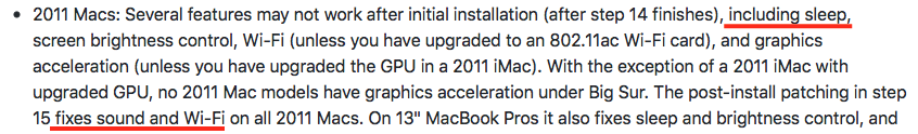

It says that sleep may not work but it doesn't say anything about fixing it on Mid 11 iMac. Only about fixing sound and wifi. Should I proceed with the installation?
I learned the hard way that with an iMac and @Ausdauersportler ’s micropatcher fork, you must let it auto detect. As stated, theYou have got the wrong version....
Go back to the first post, pick the last listed options of the patchers, do not apply any command line args to the patch-kext.sh unless you fully understand the code or have a serious issue. Only exception may be--ns
to enable Night Shift. This throws some nasty errors on the terminal output when running kmutil, but it works.
--ns
parm is the only exception to that rule. Don’t be tempted. In my case I had added the “2011” parm and ended up,with a system that would not wake from sleep. If you’ve done this, unpatch, and run again (correctly) to fix the issue. So happy with the results.Still 10 hours to go here.Still more than 9 hours to spend in 2020...
