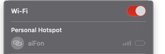

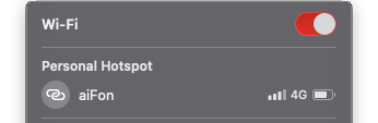

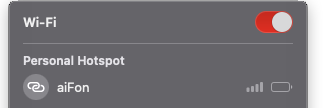

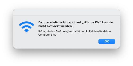

Everything works great, except my instant personal hotspot. I already searched this thread but didn't find a solution. Sorry, if I ask again.
I can see the hotspot in my WiFi status. If I select it, I can see, that the hotspot is activated on my iPhone. The switch toggles instantly and WiFi switches to LTE. But then I get a message on my iMac that the personal hotspot could not be activated.
Have you found a solution?
I just noticed I have the same issue. I tried to reset network settings, delete wifi configuration and bluetooth .plist files but it didn’t help. I am able to connect with USB or Bluetooth (System Preferences > Bluetooth > iPhone, right click > Connect to Network). So the problem is just the instant hotspot feature.
I connected another Keyboard and Mouse and disabled Bluetooth on iMac. Then I was able to connect on iPhone hotspot using the password method and I saved it to Keychain Access. After enabling Bluetooth I was still unable to connect. I disabled Bluetooth on iPhone completely (not just from Control Center) and I noticed that the 4G symbol from iPhone hotspot was disappeared.
I was able to connect again but not every time. The iPhone hotspot is greyed out frequently and you cannot select it. You have to be fast.
So with Bluetooth off (iPhone or iMac) and password saved method, not instant hotspot, it connects. I could live with that but is there any fix?
