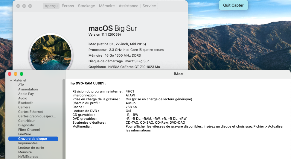

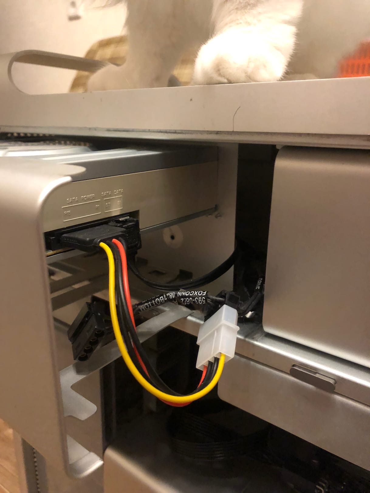

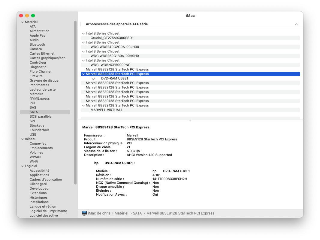

I replaced original SuperDrive and install SATA DVD-RW drive. IDE and FireWire don't work on Mac Pro 3.1
In my case - CPU and RAM worked correctly (GeekBench 4 and 5 test done without issues).

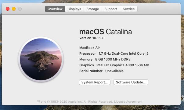

Dear all,
As an update, after updating a MBA 11' Mid2012 to Big Sur and rolling back to Catalina I have this: Serial: Unavailable...

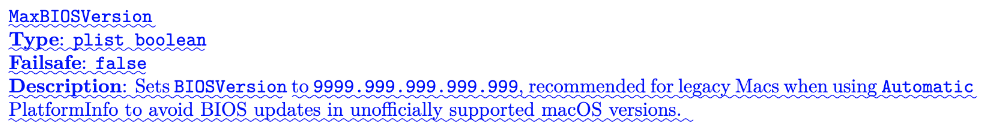

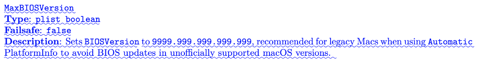

I haven't test BootROM version spoofing yet.
But some reports about going above 999 on the 1st set of number may crash the OS during boot. I am not sure if this happens on all Mac, or just some particular Mac.
Anyway, OpenCore 0.6.6 will have this new function. This is particularly to make for old Mac safer to installer unsupported macOS
I haven't test it yet, but I assume this function will allow us to go BootROM 9999.999.999.999.999 straight away without crashing.
Reactions: Ausdauersportler
I haven't test it yet, but I assume this function can will allow us to go BootROM 9999.999.999.999.999 straight away without crashing.
Yes this is submitted by the developer of Legacy Patcher and 0.0.8 0.0.9 will use OpenCore 0.6.6.
