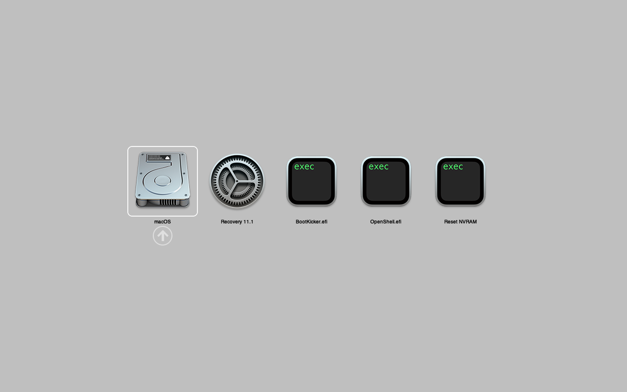

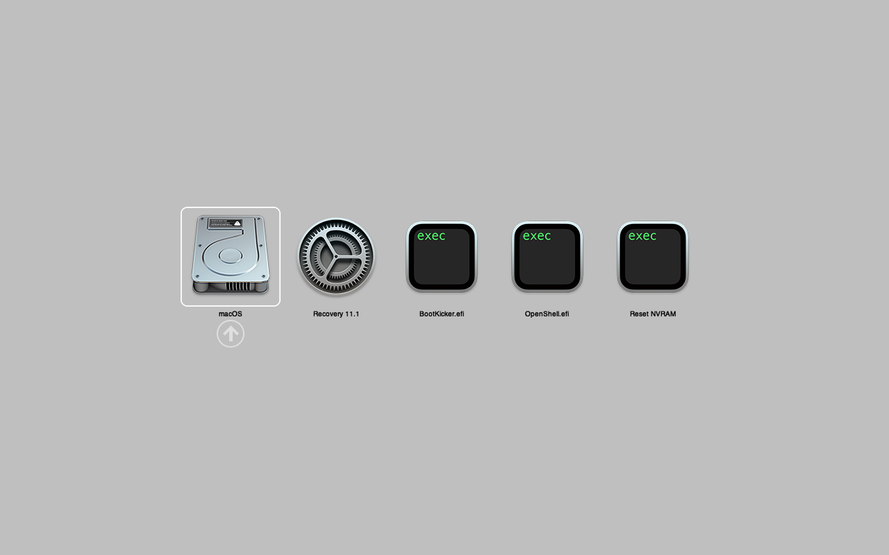

Do you have any ideas about my High Sierra issue? Shouldn't I be able to boot High Sierra from another disk? I want to have a clean install of 10.13.6 in case of emergency. I might try to reinstall it without any modifications.
