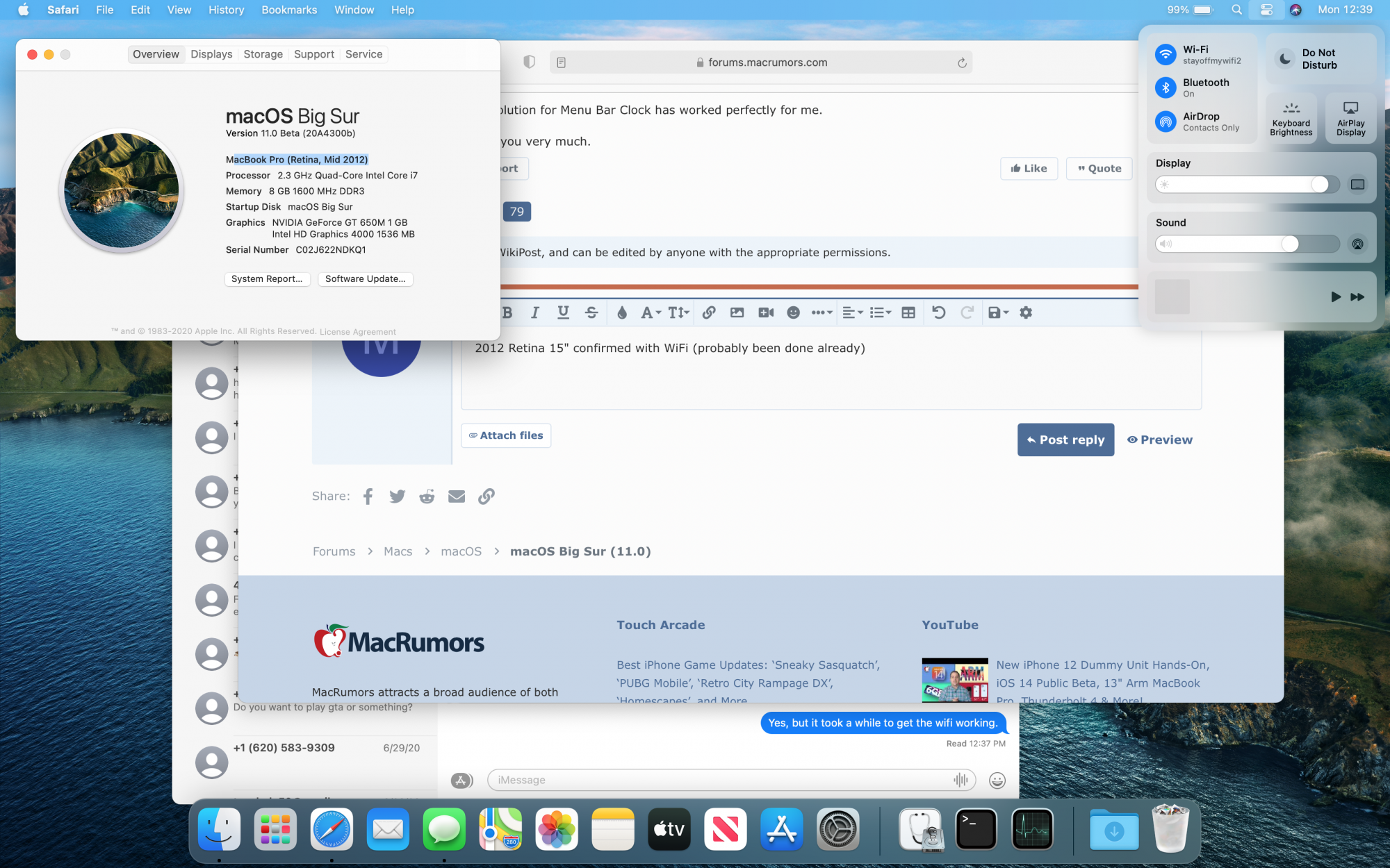

Hi, found this and tested with my MacBook Pro mid 2012 non retina and it WORKS!
Follow the instructions very carefully.
WFI working with handoff, etc.
Follow this guide and...

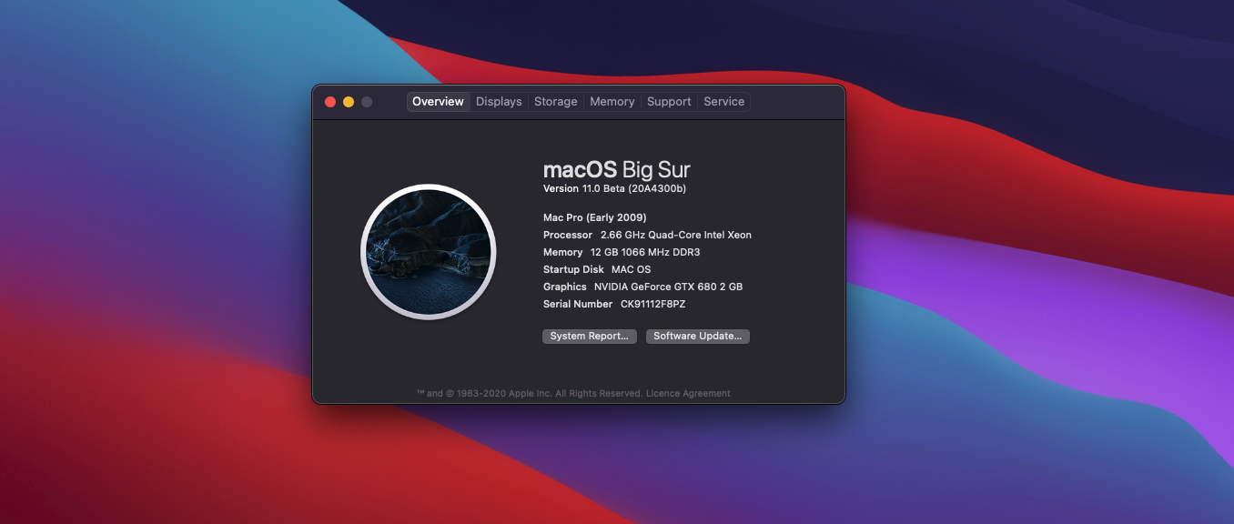

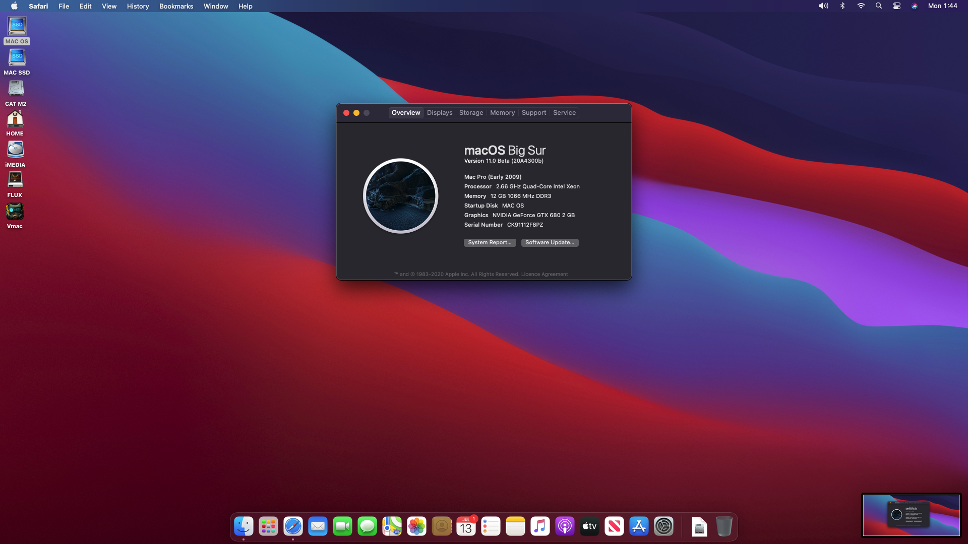

beta 2 installed with parrotgeeks method to create the usb
then used this install method
a few sound issues but apart from that all working
cMP 4.1/5.1

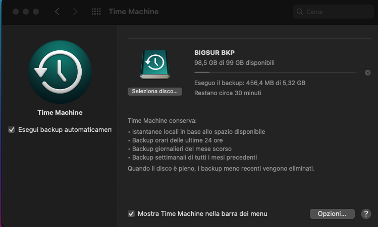

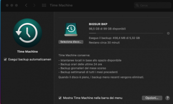

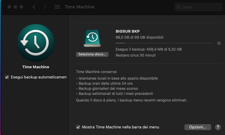

Carbon Copy Cloner 5.1,20 Beta 2 fails cloning BS. Also if it shows ALL OK, the backup starts booting then hard disk never completes loading. For testing purposes we need to find a way to clone working installations, so we can try to achieve acceleration and optimizations. Time Machine completes the task but I don't know if it works

Carbon Copy Cloner 5.20 Beta 2 fails cloning BS. Also if it shows ALL OK, the backup starts booting then hard disk never completes loading. For testing purposes we need to find a way to clone working installations, so we can try to achieve acceleration and optimizations. Time Machine completes the task but I don't know if it works
That should come as no surprise as the author clearly states that it only supports data-only backups and that he is working with Apple to enhance it to support full clones.
Been there and done all that , apples disk utility can't even do a clone of BS like it use to on other OSX. I even tried another clone tool ( i forget brand but was apple format ) with the same effect.
And Catalina don't recognize BS partition... calling it Update. Will be vey hard to make a fully functional vintage mac 🙂

Hello to all,
I installed BigSur beta2 on iMac 13,2, which was dropped from the “list” of BigSur supported machines.
I used barrykn "https://github.com/barrykn/big-sur-micropatcher" to create USB stick containing BigSur beta 2 installer. Followed directions as “per listed website” and booted into BigSur Beta 2 without issues.
WiFi works, but as others have noted, it can’t connect to hidden networks; that’s not an issue, just an observation.
Noted problem with Menu Bar Clock, but was able to format the clock via terminal commands found here:
https://www.tech-otaku.com/mac/sett...-for-the-macos-menu-bar-clock-using-terminal/
Not all commands, listed on that site work, but month, day and digital clock with seconds is viable.
This Ivy-Bridge Machine currently runs very well .
