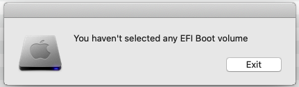

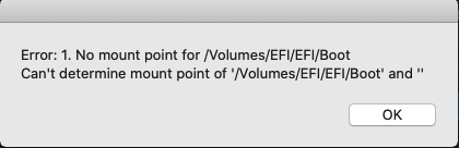

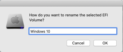

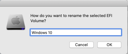

How can I easily rename with a Terminal script on Catalina the original Apple boot pickups (not openCoreLoader3b) labels and add 512x512 pixels logos (Eg: "Windows 10" instead of "EFI boot" avoiding the risk of breaking original EFI APFS startup menu? Thank you!
Reactions: TimothyR734
@jackluke Hi dear, actually I have sound (in & out) but using USB webcam mic and Bluetooth speakers. How to fix in BS Beta 3 AppleHDA.kext on Core 2 Duo Penryn Macmini 4.1 to have also internal sounds enabled? I fear to retry ~Snapshot method that has crashed BS Beta 2 (very probably due to my mistake)
[automerge]1595758906[/automerge]

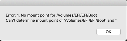

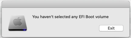

To rename the "EFI Boot" I made earlier a simple app: EFI.Boot.renamer.app.zip

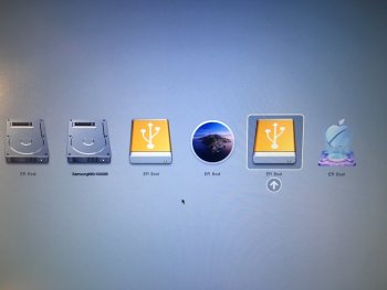

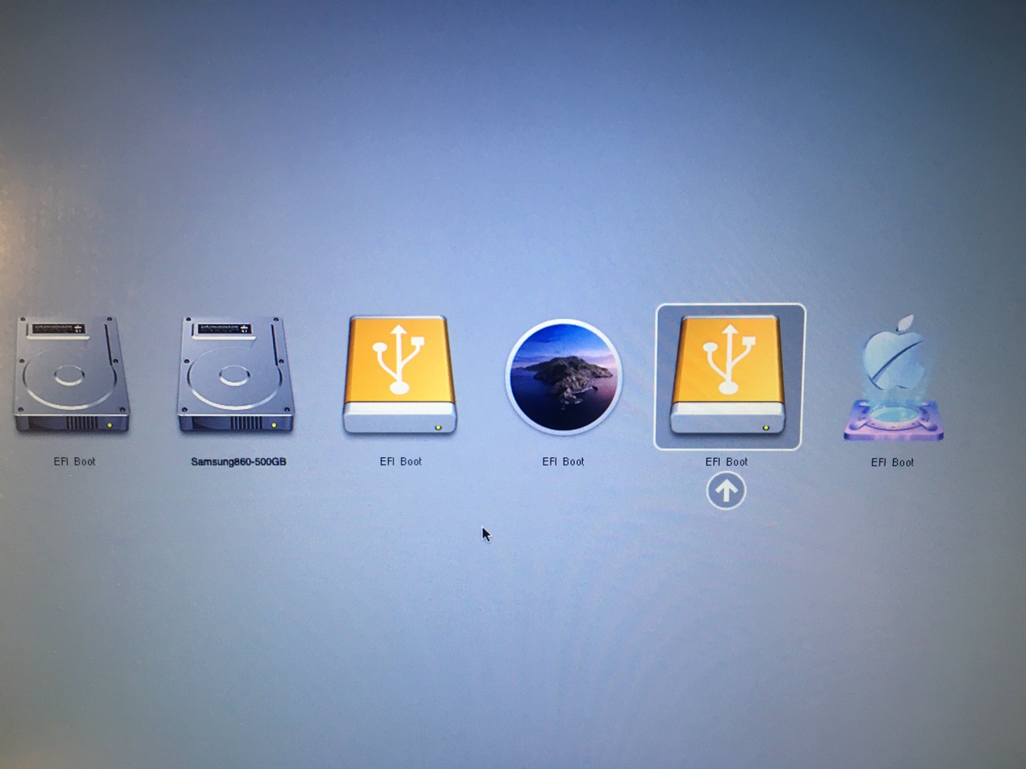

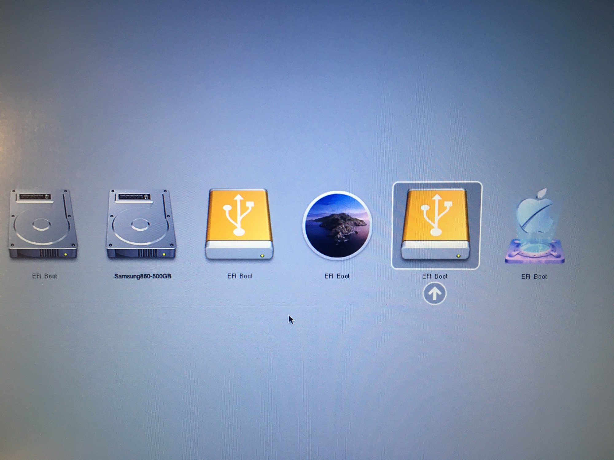

When you have installed Big Sur that is normal to see EFI boot that is what I saw so I clicked on it and Big Sur runs fine
You mean, in the opt/alt boot selector? That I also have since installing beta3, for my BS SSD on USB. In OpenCore it is labelled Preboot. On the desktop the volume is labelled correctly.

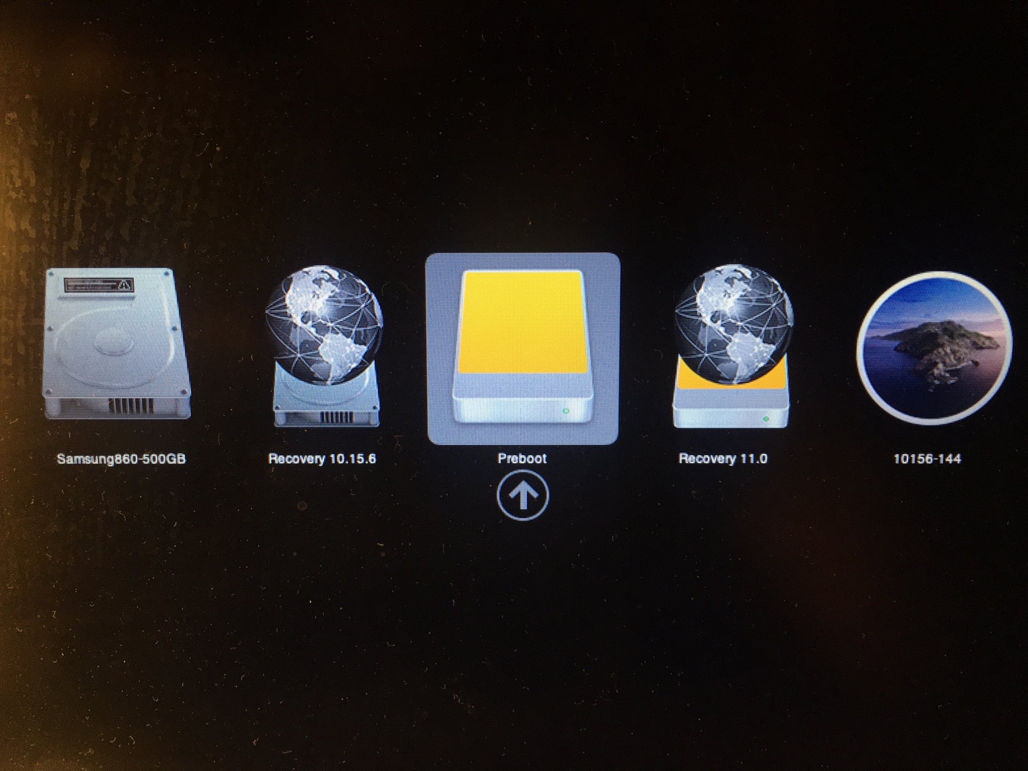

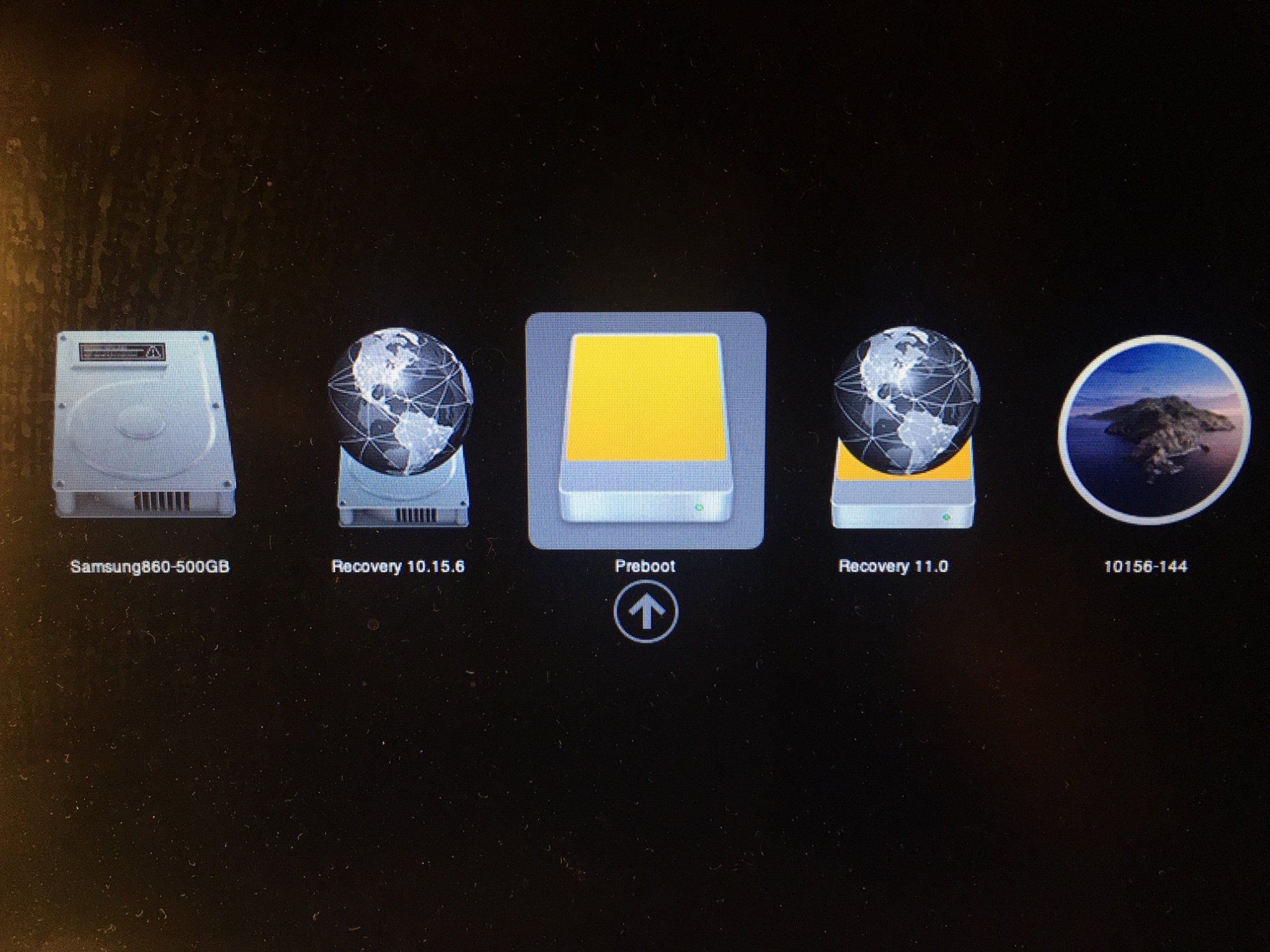

You mean, in the opt/alt boot selector? That I also have since installing beta3, for my BS SSD on USB. In OpenCore it is labeled Preboot. On the desktop the volume is labeled correctly.

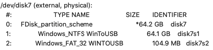

I have an explanation for this, non-APFS (or APFS patched) or legacy USB Mac can't rename the "EFI Boot" labels for apple startup manager (it's a firmware limitation), while current opencore version can only detect the BigSur Preboot volume.
To try renaming the BigSur Preboot for opencore, open a BigSur normal booting terminal:
sudo bless --folder /System/Volumes/Preboot/*/System/Library/CoreServices --label "BigSur"
Thanks - it is BigSur now in apple boot selector.
