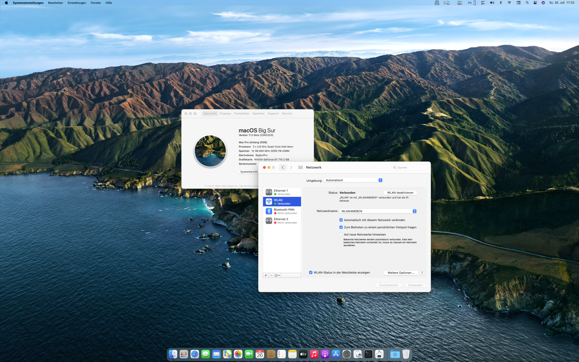

my MacPro3.1 now also on DP3 😃
installed externally with DoNotSeal
then deleted telemetry
then overwritten AppleHDA
repair permission AppleHDA
sudo touch /System/Library/Extensions && sudo kextcache -u /
kmutil install --update-all
kcditto
I boot kc (no snapshot creation).
AppleHDA works
WiFi still native
Ethernet works
BT works
unfortunately LegacyUSB not with kc (missing signature)

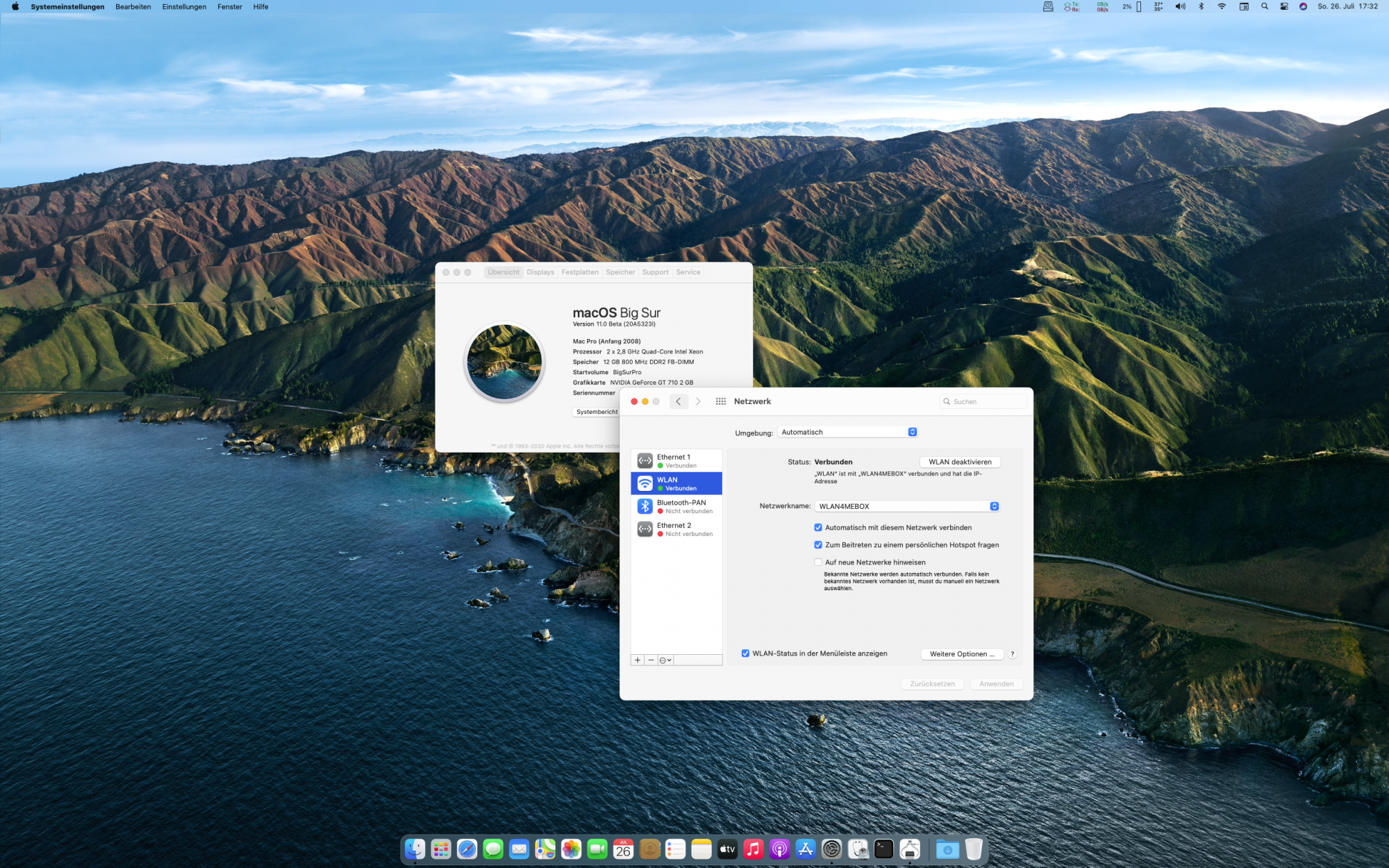

kcditto
AppleHDA works
WiFi still native
Ethernet works
BT works
