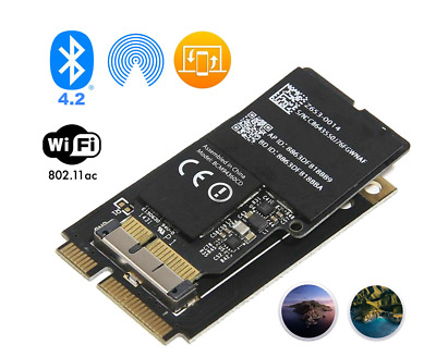

What WIFI/BT card do you have installed?
Both Ethernet ports are working fine. Here is the link for the WI-FI/BT.

Yes I upgraded the cMP5.1 WiFi card with BCM94360CD, so I don't need to add kexts.

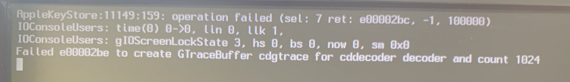

It doesn't work on my 2012 MM, I got as far as (almost) the login screen, but it's looping, same text in verbose mode or a spinning wheel each and every 10-20 seconds.
I get this in verbose mode:
