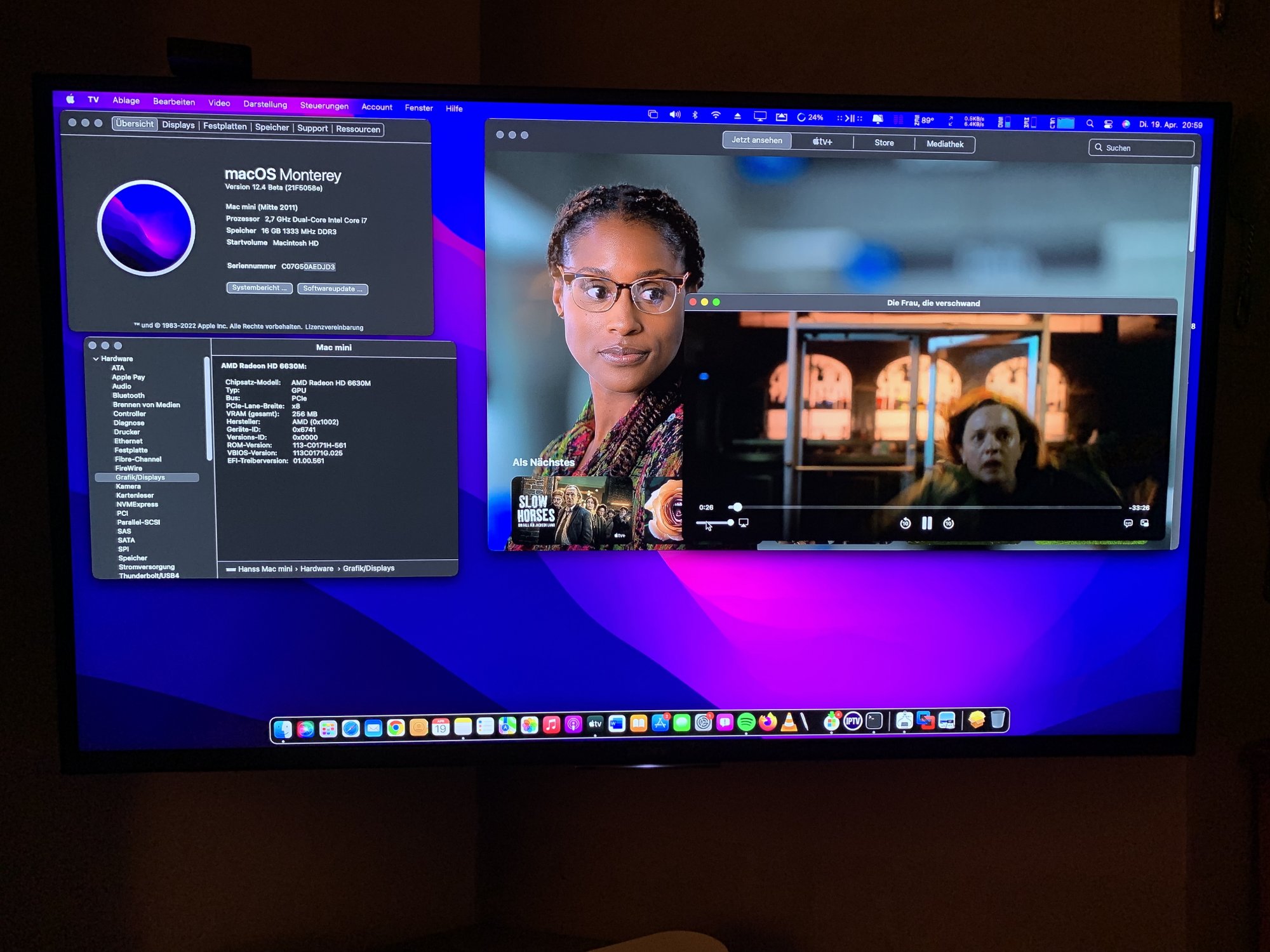

Small correction. On my MM 5,2 2011 with AMD 6630 ATV and Fusion work without any problems. On my MM6,1 2012 with I4000 no chance.
You are telling me that your MacMini5,2 with Intel Sandy Bridge HD3000 iGPU and AMD 6630 dGPU can run AppleTV with DRM protected content while using macOS Big Sur or Monterey?
This is completely weird. No other similar 2011 Sandy Bridge system like the iMac 2011 can achieve this!
(Wait: I added HD3000 support to this family myself and published it on Discord on a private development channel (and here) but 1st. I am not sure if this is enough and 2nd. the HD3000 is not metal compatible and 3rd. I am not sure if this mod made it ever into the OCLP non metal patch sets)
Would be nice to see this live….

Monterey 12.4 Beta 2 (21F5058e) released for developers.
Monterey 12.4 beta2 took a while: here we go - but video stops after some time - not perfect.
Video stops after 30s or 60s is exactly what I mean when writing not working or not supported.
You may be able to download content and watch it offline. But you will not be able to watch DRM secured content online.
