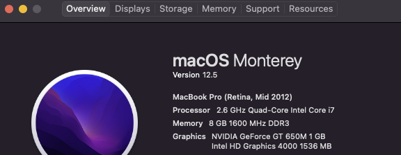

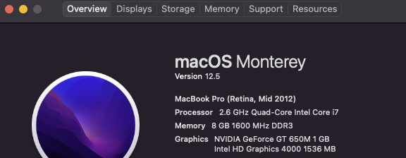

One thing I've noticed since installing Monterey 12.5 with OCLP 0.4.10 is the About This Mac panel is showing both GPUs, I don't recall ever having seen that before.
Never seen that before also.

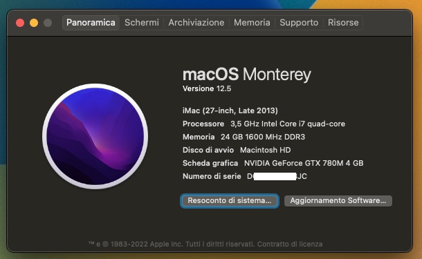

In fact it is strange... You made me doubt that it was the same for me and that I had not noticed the indication of the dual GPU.
So (since I'm on iPhone right now and I'm not on Mac), I searched for the post with my screenshot and as you can see my iMac indications are normal.
Note: if instead I launch “Geekbench 5” it also shows me the internal GPU of the CPU i7 which in Catalina is completely ignored…. But that's okay in Monterey.
I’m not sure when and how, but I did see both GPUs on this panel before. Maybe even on Big Sur, possibly at time when displaypolocyd process issue prevented from using the iGPU. Since I’m using mostly my MBP in clamshell mode, it didn’t bothered me but I did some tests to help other users to understand it. Maybe I’m a little OT, anyway I did notice that sometimes the external display got a signal and turned on right ad the start of the computer (showing OCLP boot picker) while in other occasions, despite not having changed the setup of the Mac or OCLP version, it didn’t get the image signal until the login screen. Lately seems to start at the very beginning everytime.

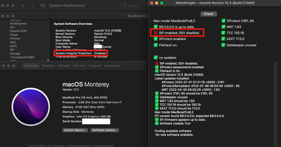

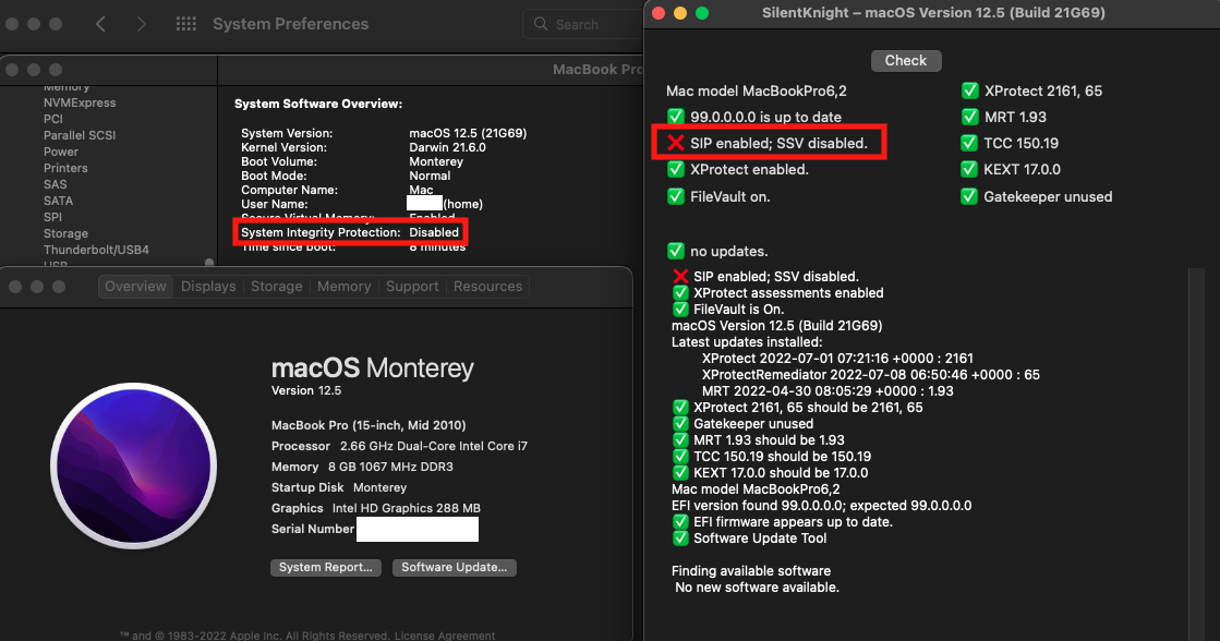

Anybody have conflicting SIP settings?
System Information says Disabled. SilentKnight says enabled. The only SIP setting I have added to the default config was ALLOW_TASK_FOR_PID to try and get TotalFinder working.
Thoughts? Thank You.
Still stuck on this. I can't figure out why the SIP settings would show different. I haven't gone into recovery via OpenCore boot picker (shouldn't have to since the OCLP app does SIP settings).
I believe this is the reason (maybe?) why I'm getting the "couldn't receive apple events" when launching total finder. Even though it shows in my automation tab that it does have special events checked. 🤷‍♂️
M/c was up and running in sleep mode this morning, woke up normally. I'd left the the display's OSD switched to the wired port, screen sharing was not active. Maybe booting once in safe mode fixed it. I doubt it but will report back. Tonight I'll try again, this time with screen sharing active.
Later: Spoke too soon. It restarted itself with the same crash log after I switched the display to a Mac mini 2018 with Ventura, watchdogd reporting timeout due to WindowServer not checking in. Looks like I'll be doing an NVRAM reset and clean install from USB drive later.
Status update: The m/c hasn't crashed in 2 days so I'll skip doing a clean install for now.
